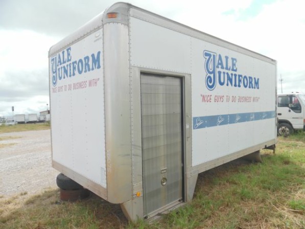

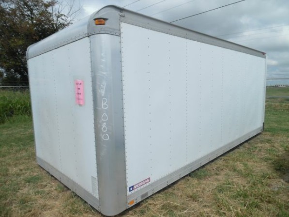

Another option for storage is a the cargo box from a delivery truck. Here is a seller in central Oklamoma: Truck-n-Trailer Storage

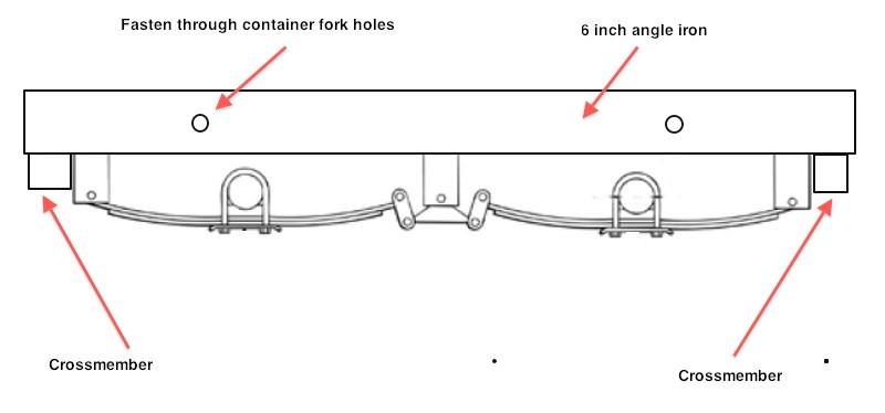

Here is what I had in mind.
This would be a larger version of a tandem boat trailer axle assembly that can be moved to adjust the balance. I believe most mobile home axles are wide enough an 8 ft wide container would fit between the wheels. The container could be placed into the angle frame and fastened using the fork lift holes and a long bolt or bolt and plate if the holes are open underneath.
A pole or V tongue could fasten to the front axle frame crossmember and be also fastened to a crossmember bolted to the front lower container corner holes.

I would bias the load to the front for more tongue load, you want about 10-15% and are well under that. You DO NOT want to get into a situation where you get sway from a light tongue load, very difficult to recover from at these weights and hard to fix if you do recover.
I agree with more timbers, 4 or 5 would be better. I would also have four 10" x 24" logs at the unload site and just ROLL that bad boy off the trailer a little at a time. Jack up one end, remove all but on timber at opposite end, install one log on each side, repeat at other end and roll!
