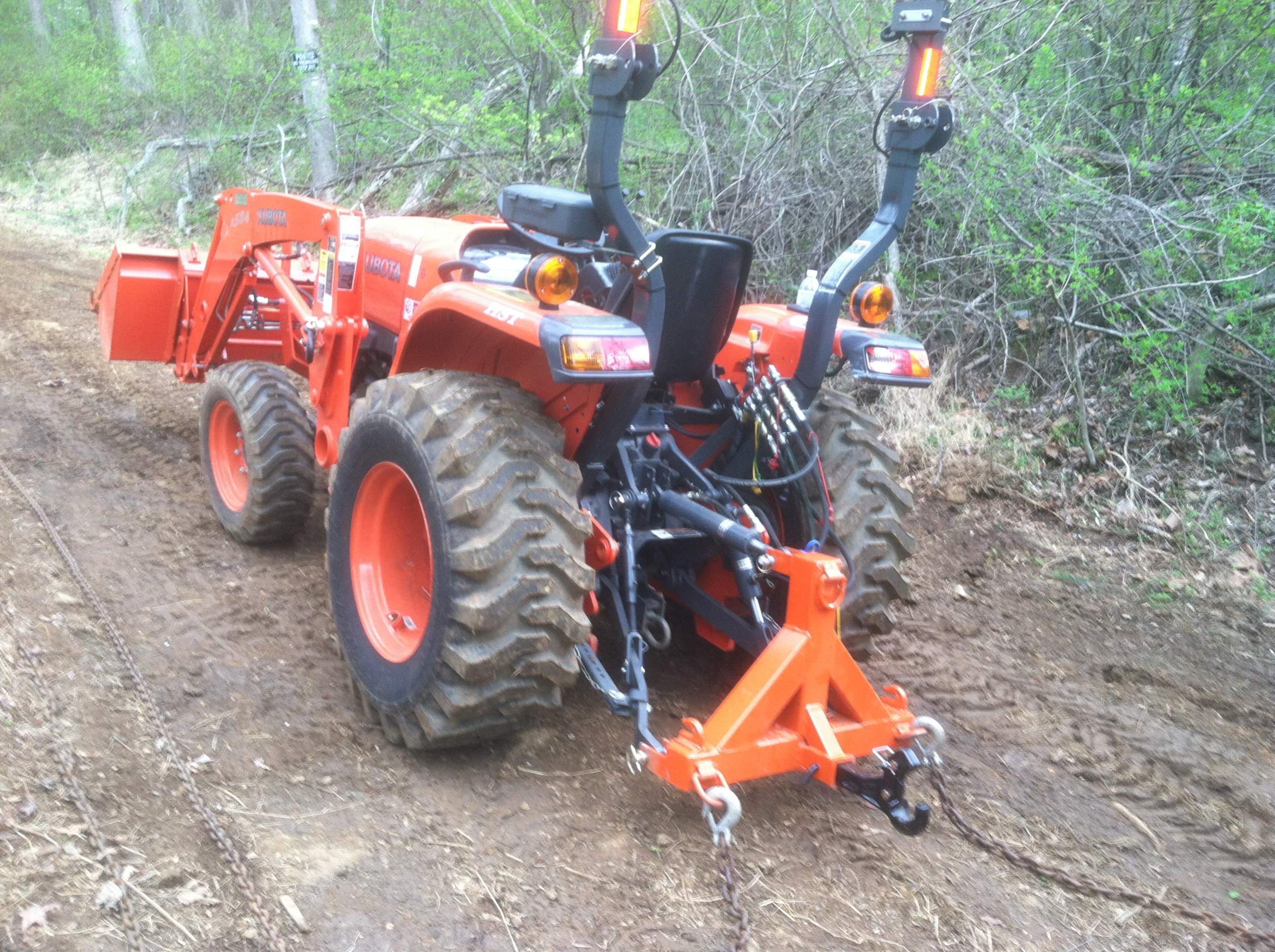

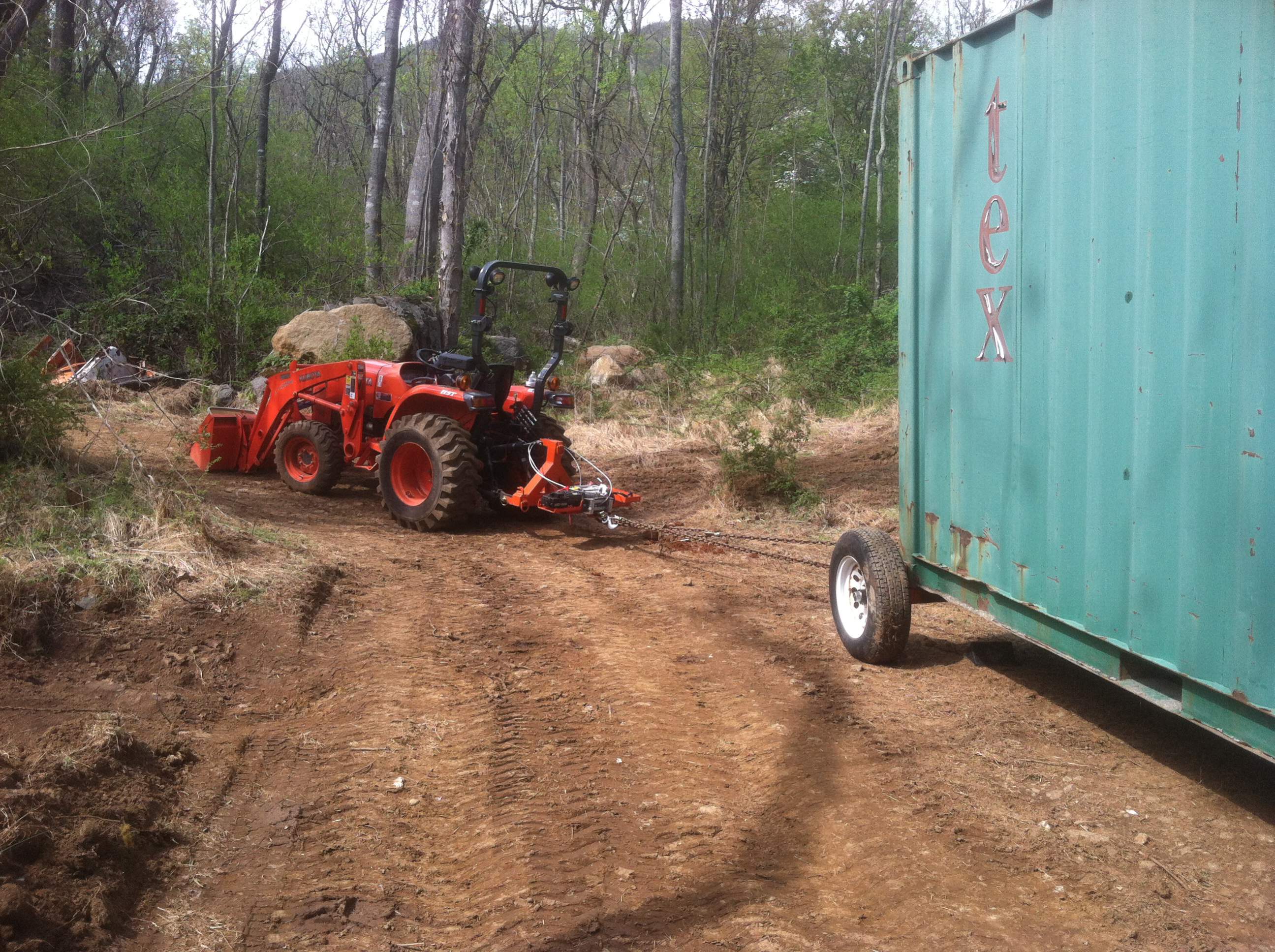

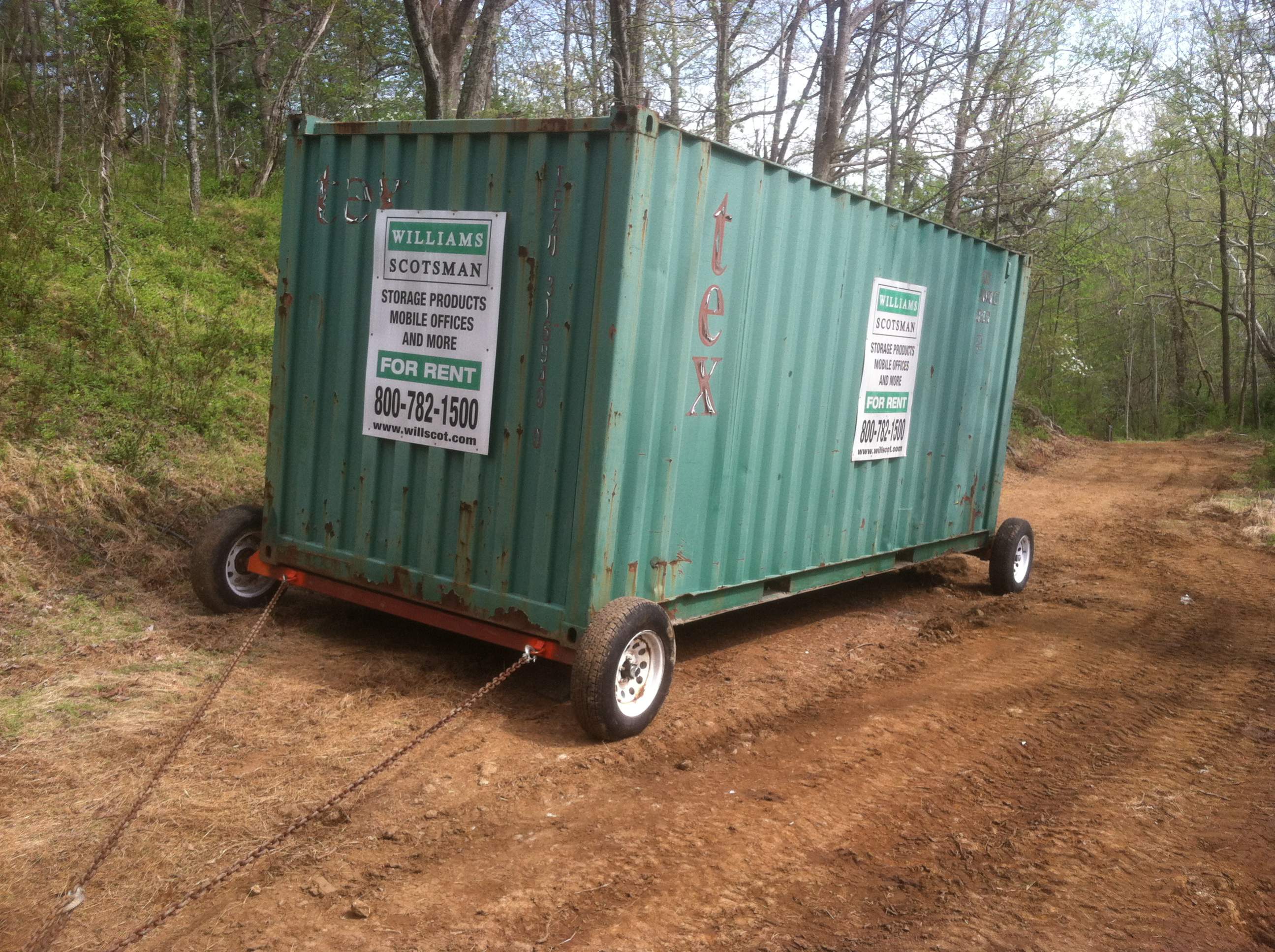

I take it that the road was always uphill since there doesn't appear to be a way to prevent the container from just rolling into the back of your tractor on a downslope.
Yes all up hill.
I don't have any photos of the steep part of the road.
I was too chicken to pull it directly behind the tractor on the steep section in case the container tried to pull me back down hill.
I put a snatch block on a very large Poplar tree and ran 500 feet of 1/2 inch cable from the container to the tractor and drove the tractor down hill. That worked well

Paul thats also my style! Have a dozer on site appx same size. Also a portable 12000 lb winch on a 2"receiver. Wouldn't mind using the dozer like that in the snow or on frozen ground. Thanks for pics!! :thumbsup: So you were able to steer it just by scrubbing the fronf wheels?
   / Move 20ft ocean container on car trailer #20
Yep when I needed to scooch it over to steer I would just use another pulley as a redirect on the winch line.
