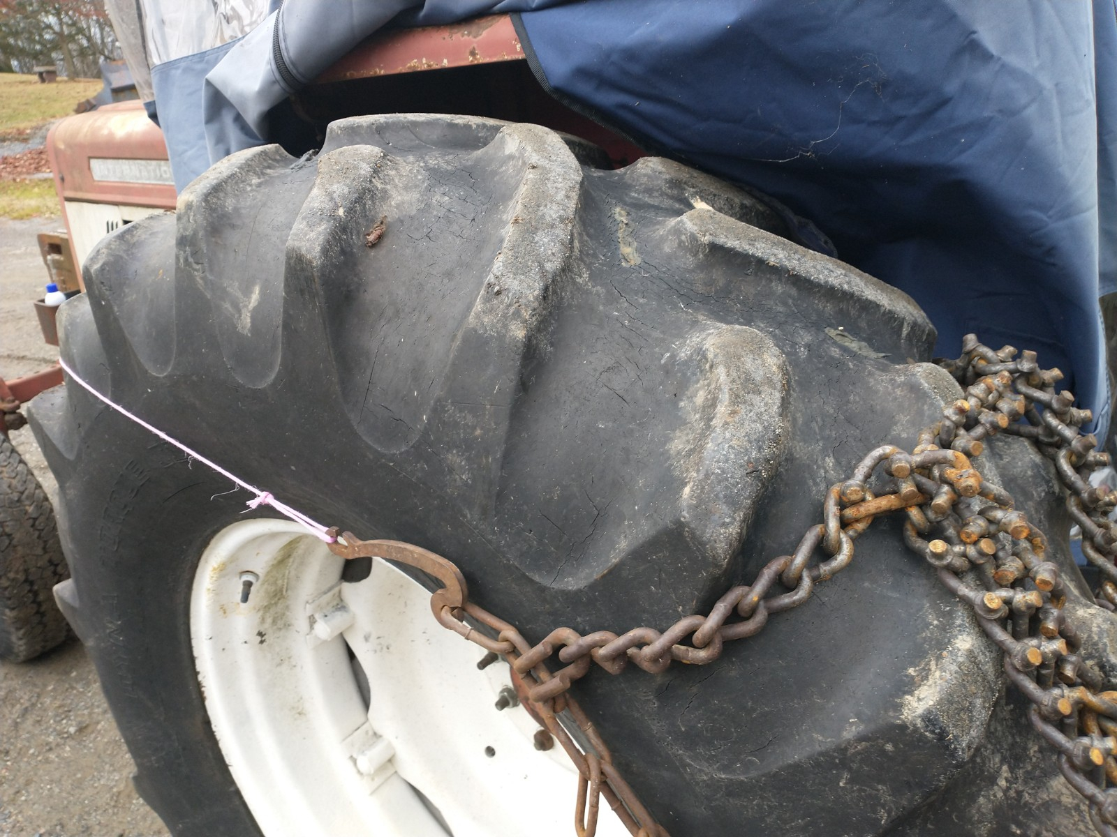

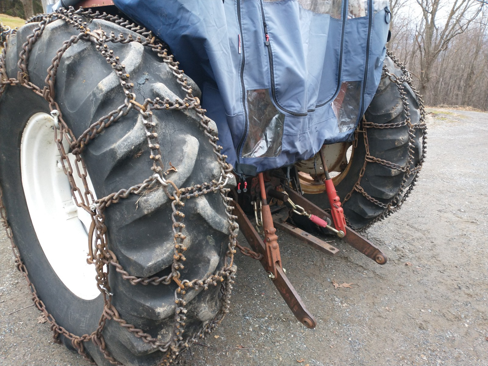

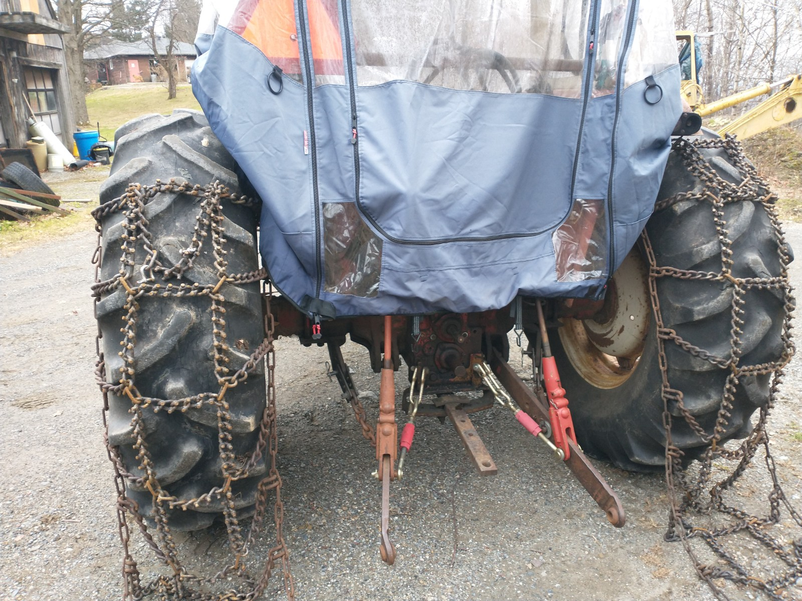

I just mounted up my chains on the old IH574 now both tractors are set in that regard so it should hold the snow off for a while.
It did take me almost an hour today for the two chains getting older I guess;
The most time consuming and aggravating part was climbing on and off the tractor 4-5 times,
move it about 3-4 feet get off and check and spread the chains get back on and repeat.
But it should be done this year till spring.chains 1 2021.jpgchains 2  2021.jpgchains 3 2021.jpgchains 4 2021.jpgchains 5 2021.jpg

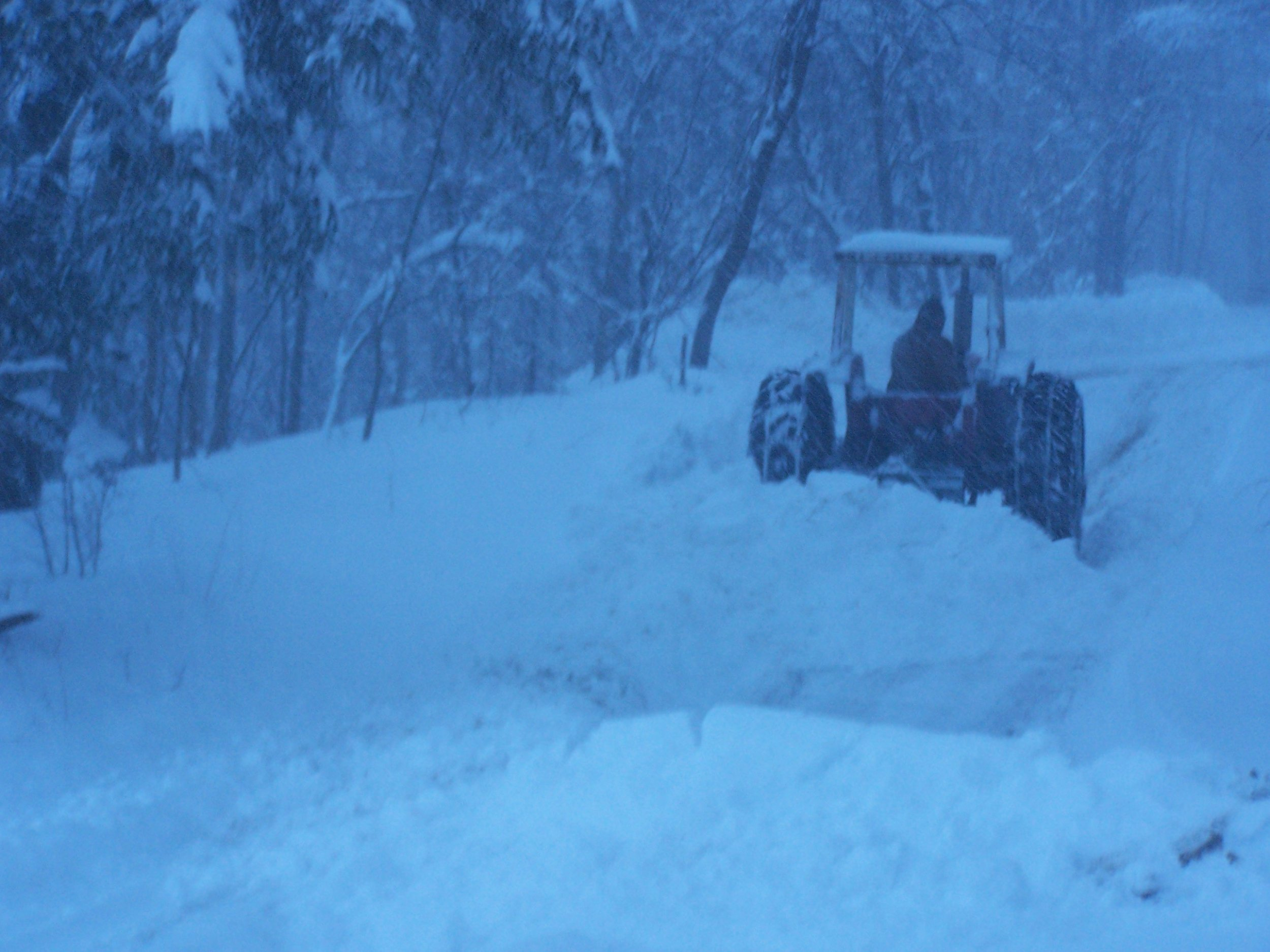

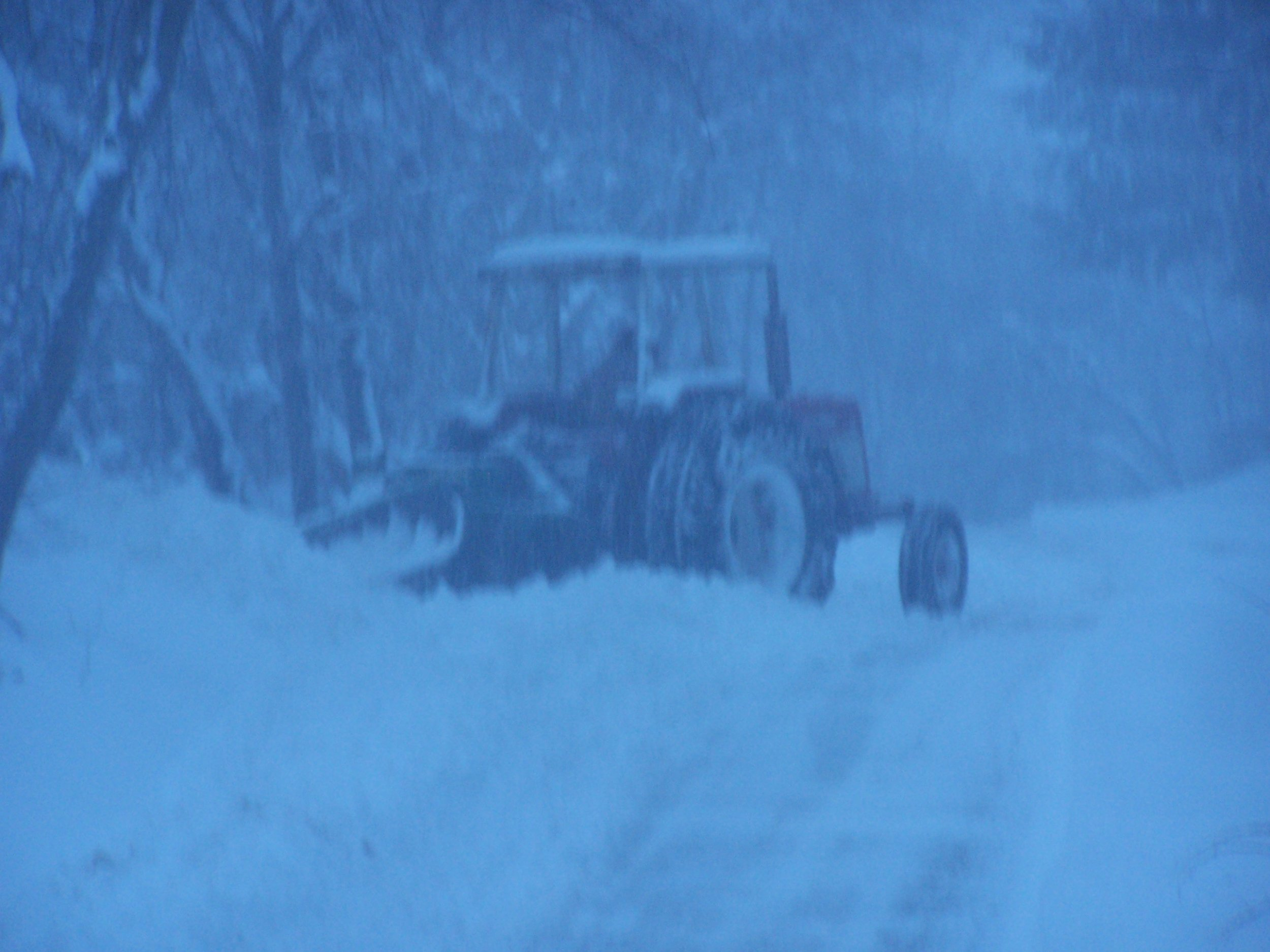

In the winter I hope it just sits backed up to the generator.
If need be it can handle a good sized back blade or the snow blower.
I prefer to use the Branson as it has a cab.
It has handled quite a bit of snow before I got the Branson.
Last year I lost a water pump on the Branson so took it off the blower and used the 574 on an 8 foot blower.
Got these pics when one of my daughters was still living at home, these are over 15 years old.
