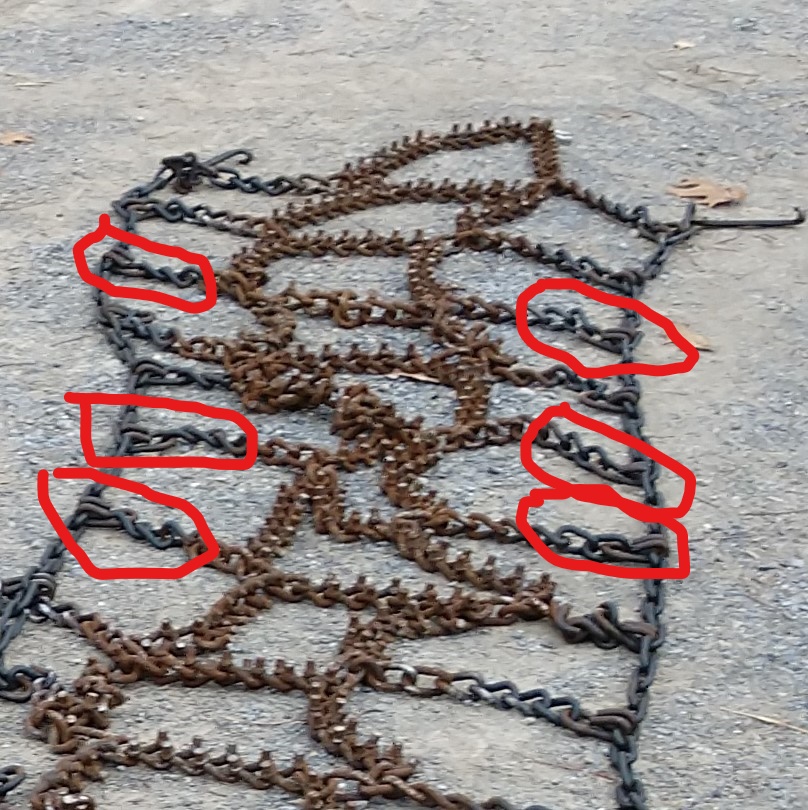

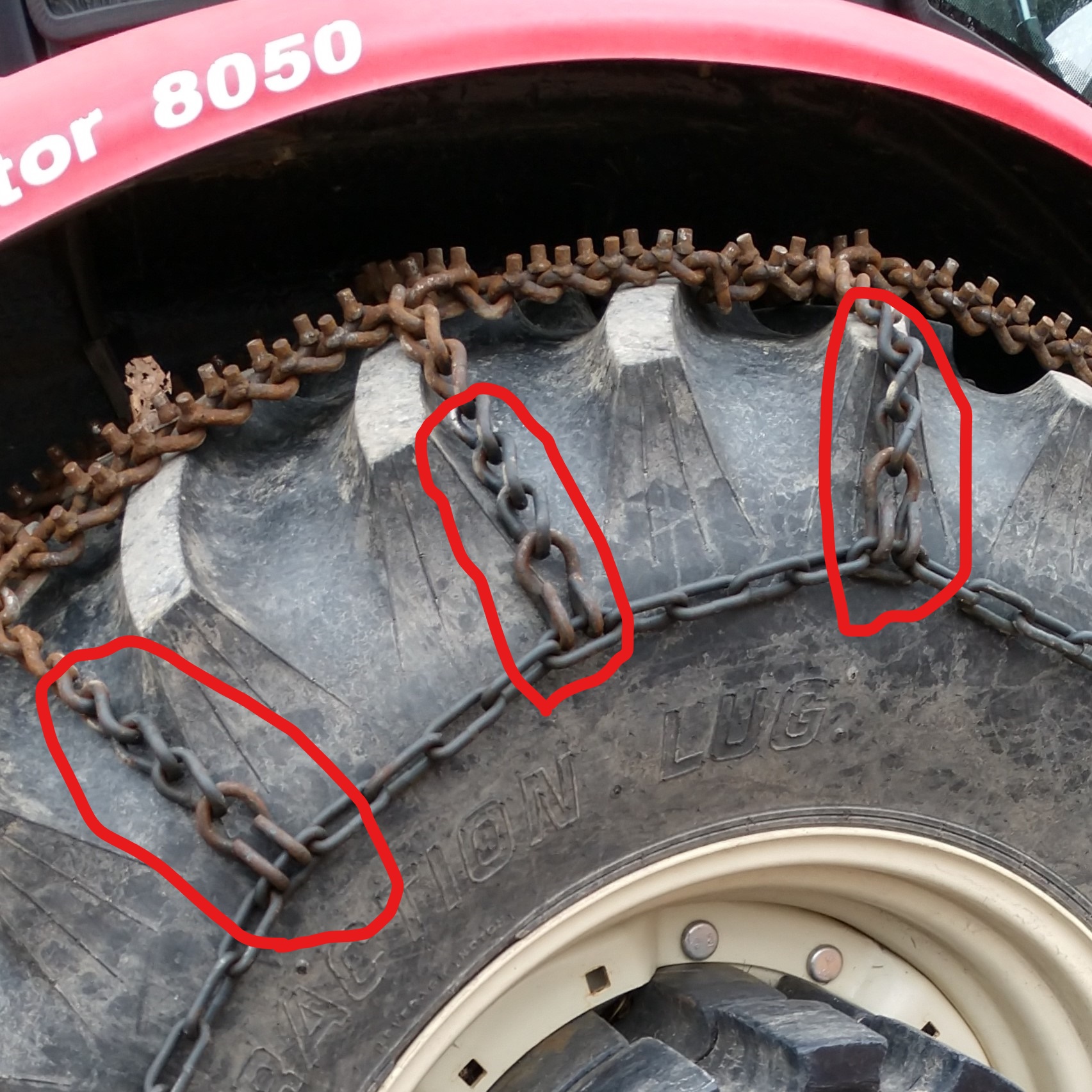

I got to thinking no need to get more pictures, just do some editing and marking up a couple of existing pictures;
If you enlarge these pictures you will see the links and hooks I am referring to circled in red, I only circled a few of course they all have to be done.
Over the years I have modified several chain sets for different tires,
when I needed to narrow a chain I will open up the hooks that hold the cross chain to the side chain,
then remove how ever many links I needed to equally on both sides inside and out and reinstall the hooks.
To widen a set of chains again I'd remove the hooks and add the required links to both sides and reinstall the hooks onto the side chains.
I do have a set of tire chain pliers which makes undo and reclosing the hooks much easier.
This would have had the effect of moving the side chains up and away from your steering knuckles.

Eric I have narrowed many chains that way shortening the cross chains raises the OD of the outer chains which would help to clear your knuckes,
you are correct in that it would not have narrowed the spacing of the traction chains on the tread.

I now see what you were suggesting. Fair enough. The provision on my style of Tallon chains is poping the roll pins on the clevis, not the way you're suggesting. My side hooks are closed and opening them would require grunting, hammering, and likely my acetylene torch to heat the hook links up so I could open them enough to move up the sides.
At any rate, your suggestion, if followed, would have solved the clearance issue that I detailed in my video, but not the poor fitment of my studded, traction chains that I admittedly glossed in my video, but was a concern to me. While it is obvious we missed each other's suggestions, it is all good because now somebody searching the internet down the road will see two different ways to try in order to narrow his or her tire chains if needs be.
