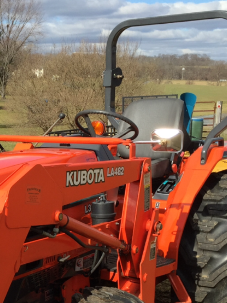

I put a single 3x5 mirror on the loader brace on my previous L3410.

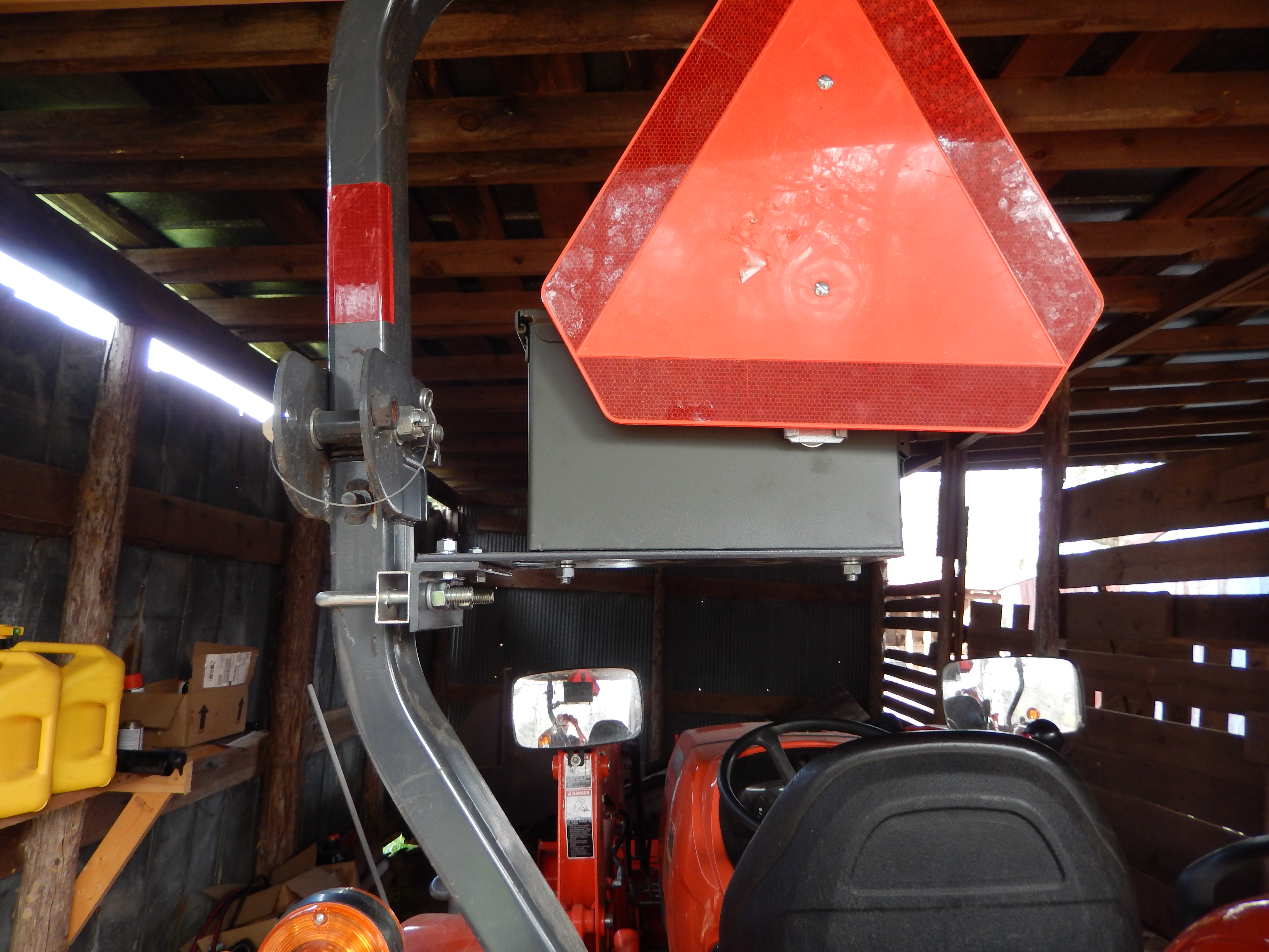

Don't have a B but still seems like the loader mount is probably the best place. You can see mine in the attached picture.

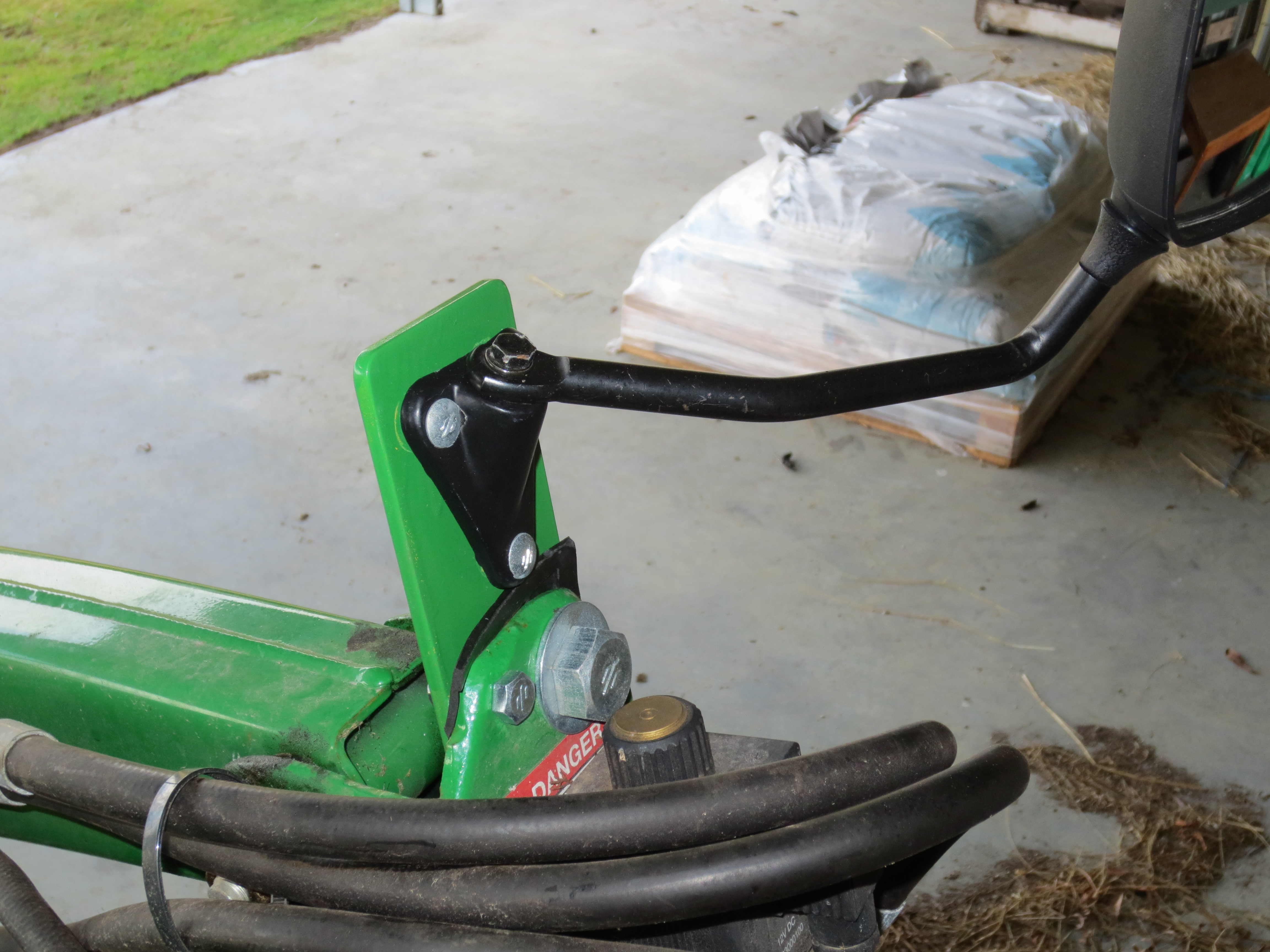

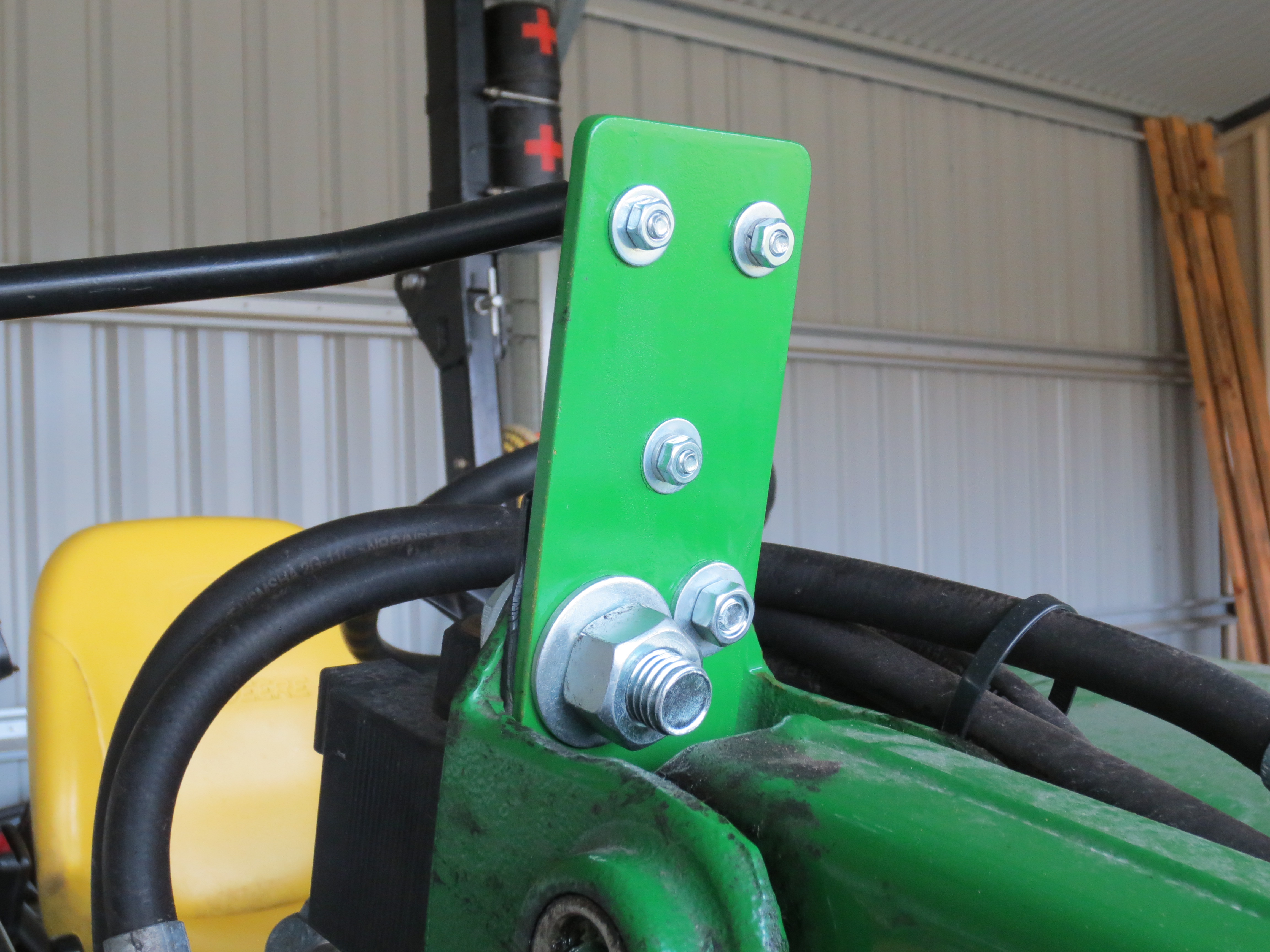

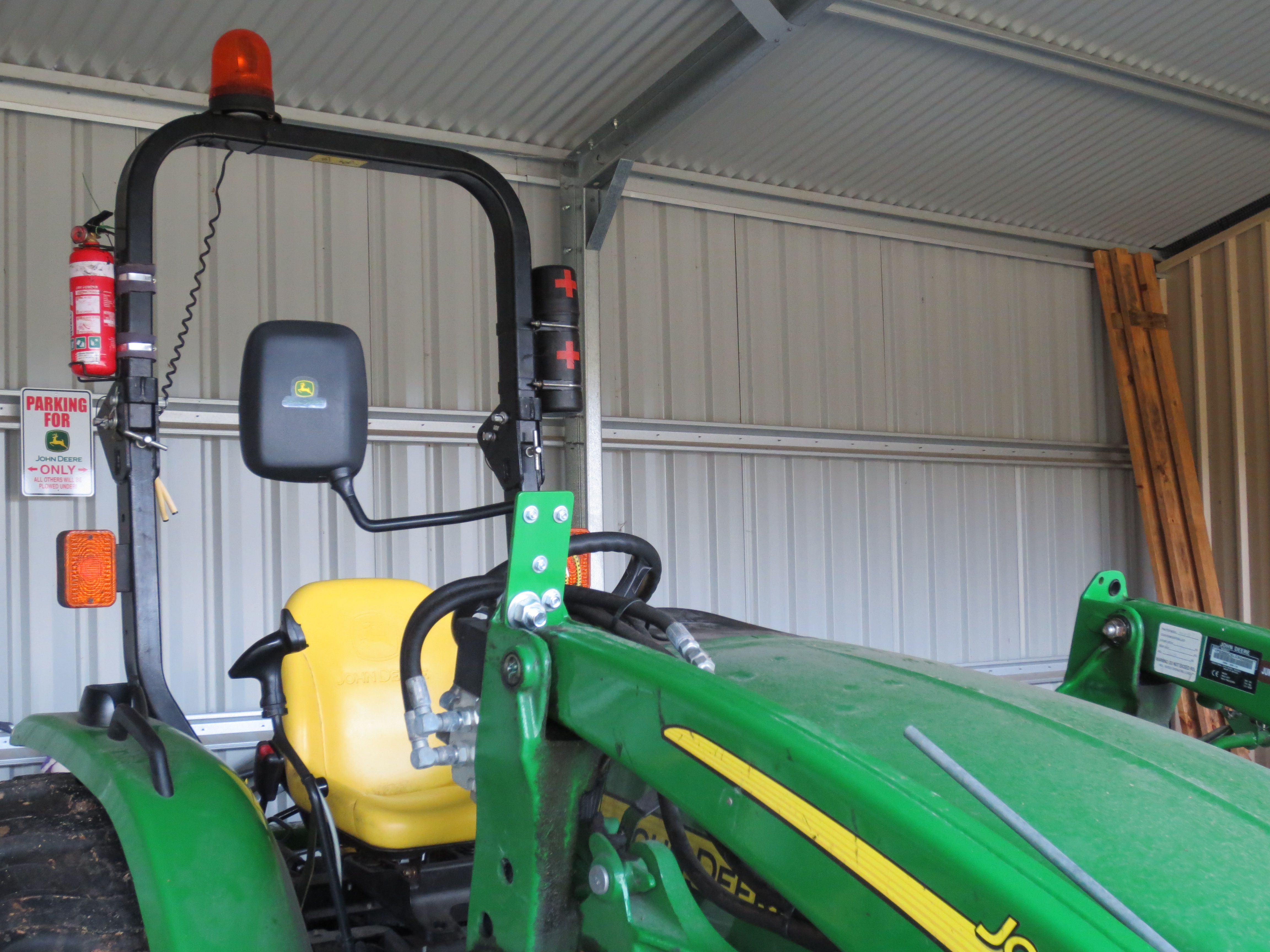

Loader mount is where I mounted my own 'jury rigged' mirror. JD did offer a ROPS mounted configuration but I would've needed to take out a second mortgage to purchase one. :laughing:
I mounted it on the right arm because we drive on the left.

The one that I mounted I bought from my local Auto-parts shop. It's a 'generic' side view mirror for a van. The little JD sticker on it is something I had laying around. :)
I measured the holes and made a template using paper & took it to a local metal fabrication/welding shop. He made it out of a piece of scrap steel. I painted it JD green using a rattle-can, bought the nuts & bolts at my local hardware store. In the first picture you can just see a rubber gasket that I fashioned out of some floor matting.
The mirror does not vibrate at all... clear as a bell!
