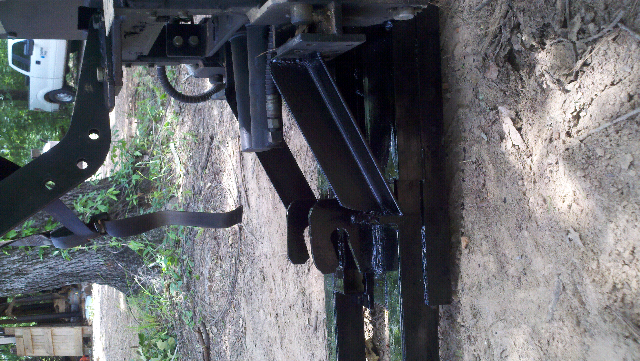

#25
I started on the subframe Saturday and finished it Sunday. I had to make a few revisions to the mahindra design I was trying to emulate but it turned out good. Looks decent and so far it works really well. I dug up a 10" diameter oak stump in about an hour and it never skipped a beat! Thanks for all the advice and pictures. I will add some pictures of it this weekend if I get a chance.

#27
Here are a few pictures of the subframe I built. I put a coat of paint on it and snapped some pictures. There's one picture of the drawbar with a 7.5 inch long piece of cold roll welded to it. The two ears on the back of the subframe slip over the cold roll. Then I can pick the backhoe boom up and it is pinned to two half inch plates I welded to the front end loader crossmember. This is the same concept Mahindra uses to mount a backhoe on the 2516. I also made a short toplink for a little extra insurance. I don't have to remove the 3 point arms to attach it. I do have to disconnect the lift arms from the 3 point arms and they lay on top of the outriggers. I have removed 2 pine stumps, an oak stump, and 3 small sweetgum stumps so far and had no trouble other than a small hydraulic leak which is now fixed.
