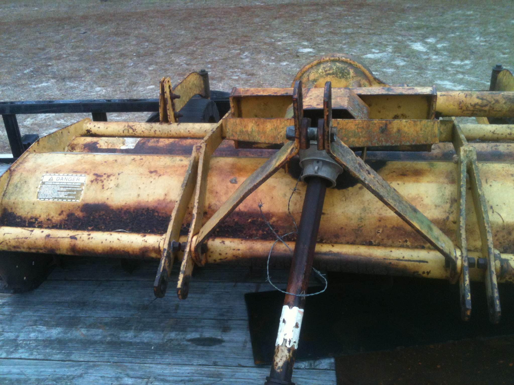

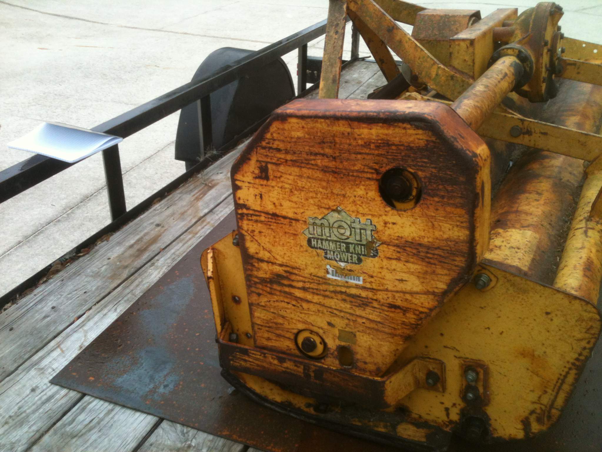

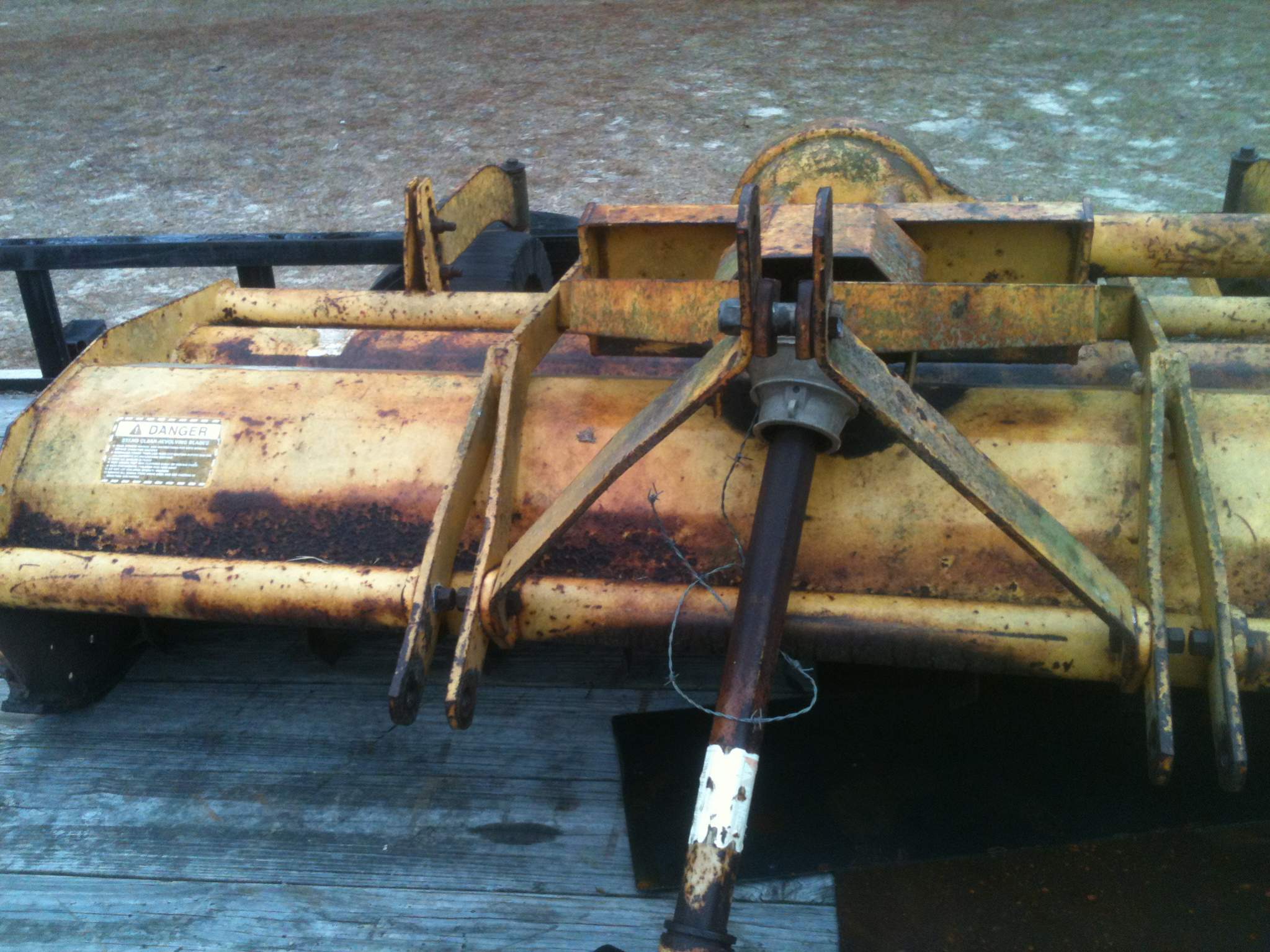

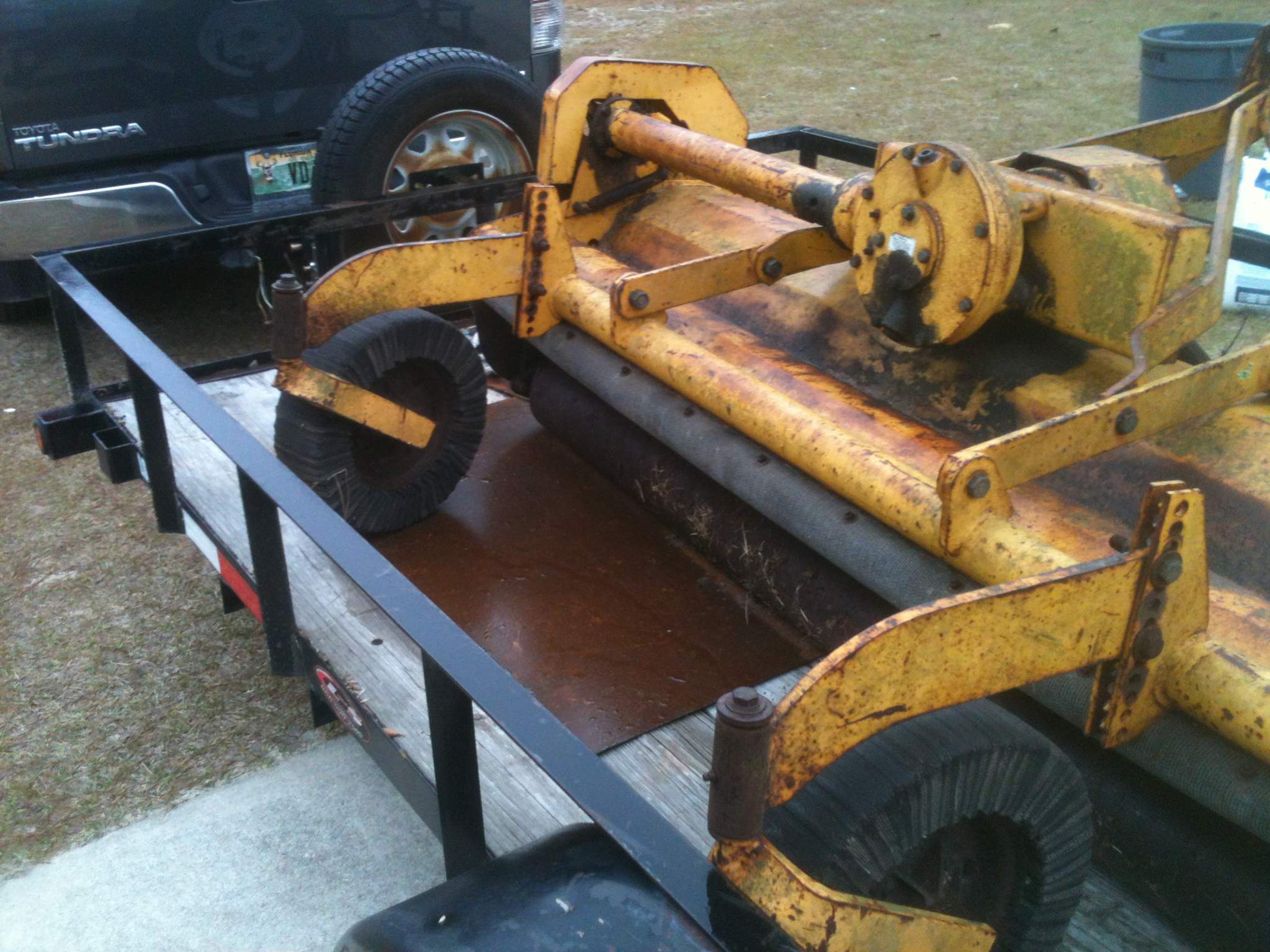

I picked it up yesterday it's a Mott model 74 flail just been sitting not used for a while when I asked for any ideas I mean anything you can offer about this unit value, age tell me why it has rear wheels like a rotary style mower I have never seen this on a flail before. any info

Not sure why it has wheels. Dont know much about flails. I had an older mott a few years ago, picked up for $200 and spend about $100 and some time on it and painted it. Sold for $600. It was a 5' model.
I would think if everything is mechanically sound on the unit its probably worth $400-$500 in my area. Some people just like flails better and are willing to pay. They arent popular in my area.

I believe the wheels were used so you could turn it sharp and not have the edge of the roller dig in to the ground. Because the tractor pivots at the rear wheels, without lifting a flail when you do a sharp turn, the mower moves sideways and the roller can dig in.
I have a 5' Mott similar to LD's story, bought it cheap, had to put about $100 into flails and a PTO seal though.
Value would depend on what it is. I am guessing that is a finish flail since it has the wheels, maybe $400ish? If it's a rough cut flail I'd think it would be worth more as they have a lot more uses.

With those rear wheels, I would think that you could use a chain for a top link, which would allow the mower to follow the contours of the ground independent of the up and down movement of the tractor's rear end. Set at a proper length, the chain would still allow you to lift the entire mower off the ground.
Could be a VERY handy setup especially for someone who has a long of varying contours in the land.

How are they any better than the rear full-length roller on a flail mower? In addition, the farther away the wheels and/or roller are from the flail rotor itself, the more it will scalp changing terrains... a flail has the roller behind the mowing rotor, so it would drive into something a good foot and a half before the wheels ever got to it?
A 3-point hitch already allows up-down movement to follow a contour with a fixed toplink. A chain toplink seems like it'd be a horrible idea for a flail or most PTO implements, it would be able to rotate forward, screw up the PTO, scalp, etc.
/ Mott Flail Mower #8
His mower already has a rear roller on it. Someone else already suggested that perhaps the rear wheels, properly set, would allow turns without the rear roller digging in. It might also reduce side pressure on the roller's bearings.
. . . A chain toplink seems like it'd be a horrible idea for a flail or most PTO implements, it would be able to rotate forward, screw up the PTO, scalp, etc.
No more risk than any pull-type implement with gauge wheels. And with a 3 point implement mounted with a traditional top link, you have to be careful not to cross dips, etc. that are too deep of a "V" shape; otherwise, you will bend or break something.
By the way, I didn't design and build this implement. I was just offering a theory of why it would have gauge wheels on it and what some of the possible benefits were..

The rear wheels are there to keep the mower level horizontally. The rear roller is it is still there prevents the mower from gouging the turf or nose diving and damaging the flail mower rotor or knives.
I hope the rear roller is still intact-if not you need one and bearings and possibly the bearing housings that bolt on
to the side weldments.
it need work and a hot bath-yes a hot bath with the covers removed as there are grease fittings that are buried under rubber dust and grease.
If you could post more pictures of the flail mowers rotor that would be great for me to see-please use good lighting if possible when taking the pictures/images.
Check the rear wheel bearings, they will probably need to be replaced but it is an easy job. DO not buy sealed bearings for the rear wheels.
EDIT: I see the rear roller now and the rear rubber flap to knock down the clippings as they pass over the
flail mower rotor.
It needs a little work and a hot bath-yes a hot bath with the covers removed as there are grease fittings that are buried under rubber dust and grease.
if you buy the kevlar belts to replace the old ones they will last longer as they are more shock resistant.
Your model is a Mott Interstater model with a finish cut rotor most likely.
You will need to drain the gearbox and put fresh gear oil in it.

The Mower is made stable in two directions in both the X plane and the Y plane
Essentially: The X and Y planes occur on a piece of graph paper and are exactly 90 degrees apart in either positive or negative locations in relation to the center point which is zero on the number line.
It provides a more stable mowing height and reduces scalping to a minimum.
SOME flail mowers have four height gauge wheels-two in front and two in the rear which are cranked up or down to the desired mowing height relative to the rear rollers mowing height.
The Y plane is the point on a clock which is a direct vertical line from the 12 o'clock position to the six o'clock position from a positive number(+Y) at the top passing through zero to a negative number on on the Negative Y (-Y) portion of the graph
to the bottom.
The X plane is the point on a clock where there is a direct horizontal line from the nine o'clock position to the three o'clock position passing from negative numbers(-X) to positive numbers (+X)with the zero in the center if the number line is followed from left to right.

Having the wheels and the roller is a little redundant. However...If you have a front mounted Alamo flail like me, then the wheels come in handy. Any interest in selling the wheels?

Per the mott manuals the wheels are for when the ground you are mowing is full of obstacles like stumps that would otherwise bend a roller if it where to snag. the roller should be set all the way up out of the way when you use the gauge wheels so it is out of harms way. If the ground you are mowing is relatively clear just use the roller it works better in nice conditions. there were two types of wheels ones that hit the housing when you back up and ones that swivel 360 degrees without hitting the housings so be careful the first time you use it.

Just checked out the pics you have the 360 degree swivel wheels keep them they may come in handy (you can flip them up so they are out of the way when you are using the roller). take a few pics of the business end (the rotor underneath) and download a flailmaster catalog. It will enlighten you about all the different configurations of knives available.
congratulations looks like it is in good shape.
