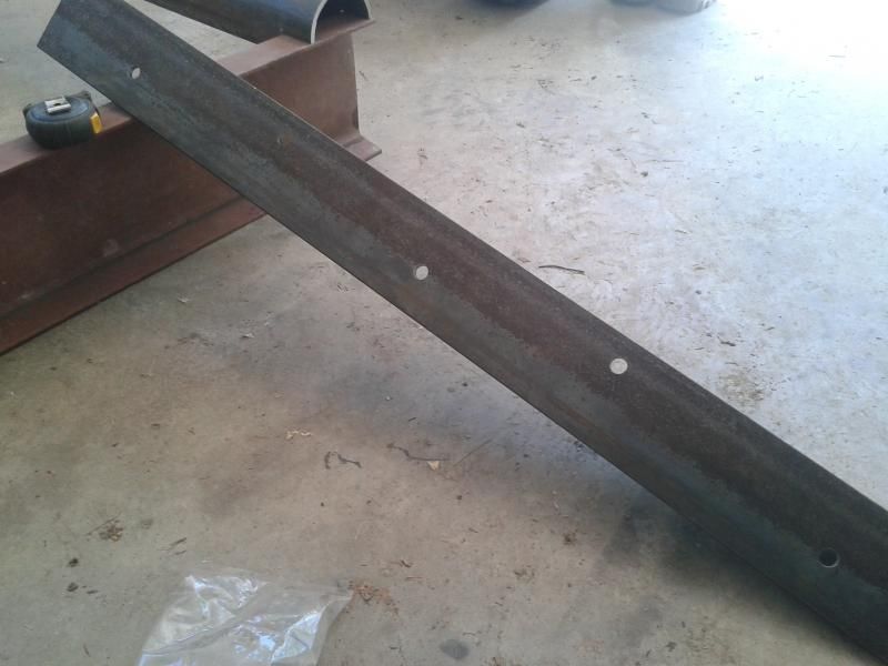

I haven't really been following your thread, but one thought occurs to me.
You might want to drill an extra set of holes on the back side of the angle so that you could install the blade reversed. That should allow you to "backblade" for leveling softer soil or gravel.
Good idea, but I can't think of an instance that I'd need it... but I'll keep that in mind!

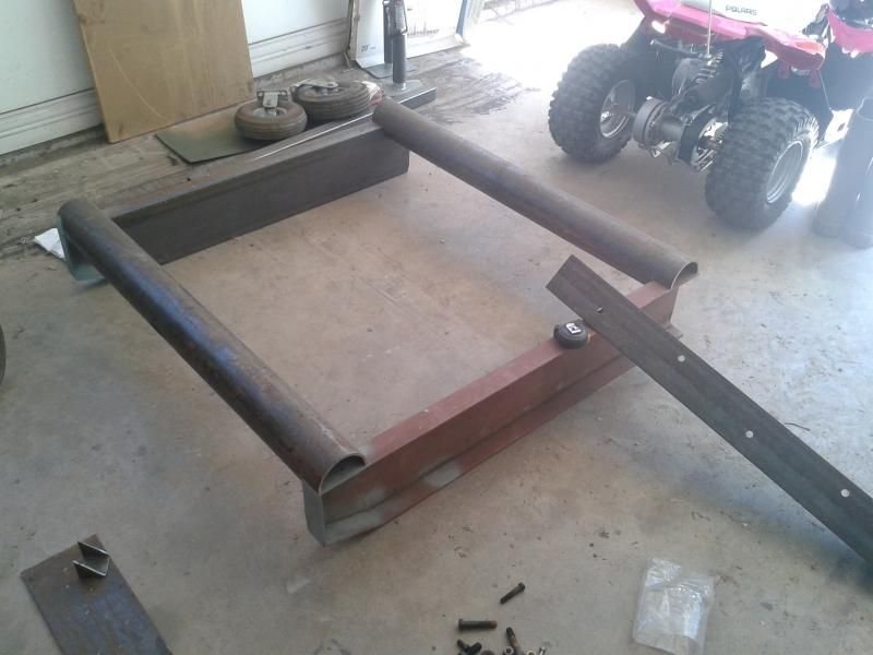

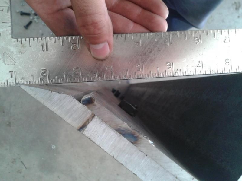

Made some gussets for the tongue... compound angles with an offset radius... fun! LOL Should've used flat plate.
Tiny gusset underneath
... and semi welded in.
If my tank can last I'll be able to take this for a test tow next time I work on it!... but I'm showing 0psi on the tank... still 25psi at the regulator... she's almost done.

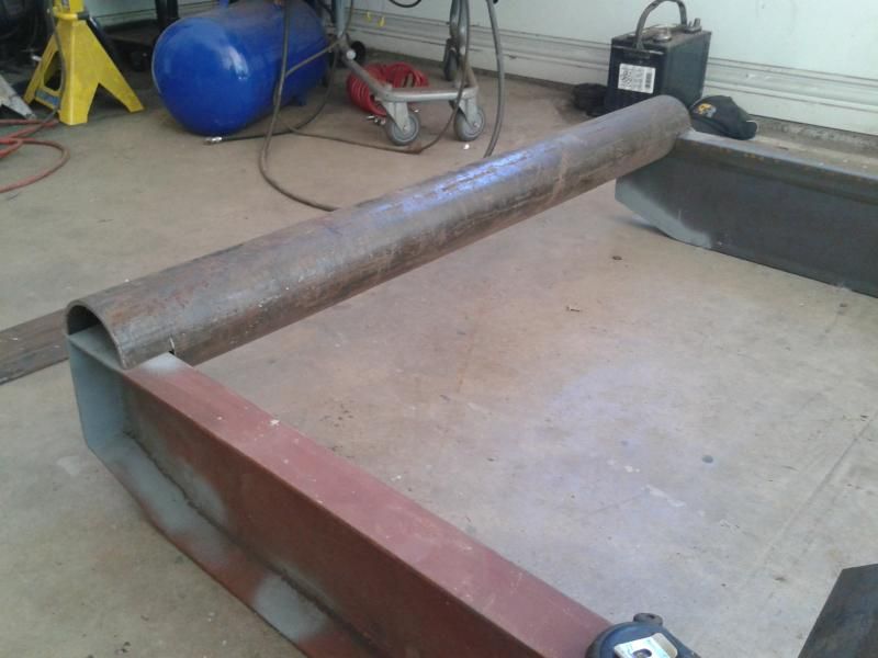

I did run out of gas, but was able to burn the tongue in enough to give it a test tow minus blade.
She did ok. The rear seemed to be up in the air most of the time... I may have gotten the tongue on wrong. I'm thinking a relief cut, bend slightly, then re-weld. That or put a hinge so that it can float better. It would need some kind of lock for transport. The good news is that I have enough room at the end of my driveway to turn around! I also noticed that it did bounce around a bit... but it was picking out some fair sized rocks that were just sticking up a bit. I went around and picked them up afterwards. Later passes should fill in the holes left behind.

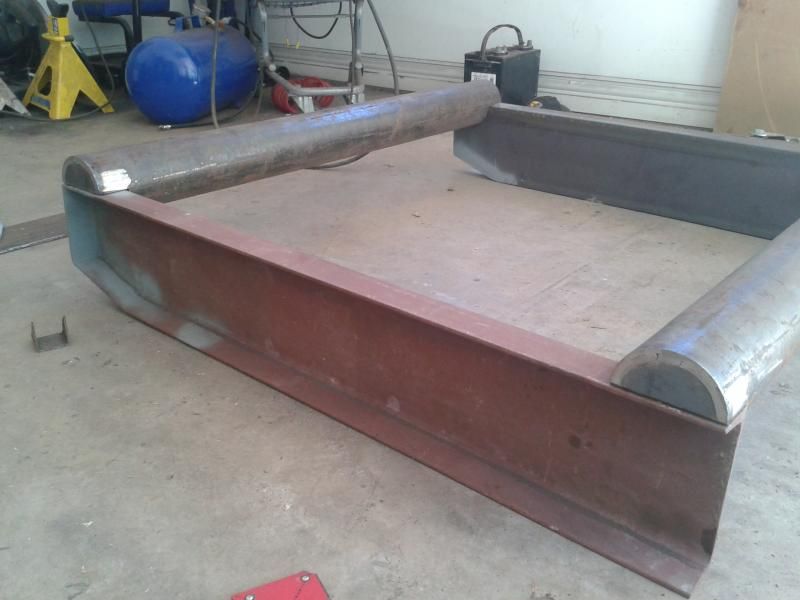

Married the jacks to the casters

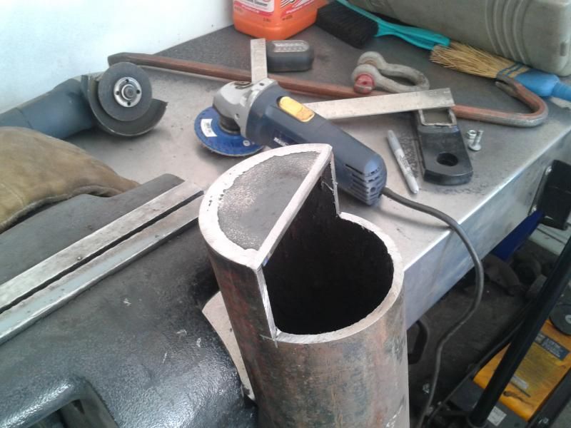

Dug out and blew off 1" of grinding dust off my bender. LOL
Made some terrible bends... though getting better with each one. I use shims to keep them from squishing. I had 1" down pat, but 1.5" is all new.
and after lots of measuring, cutting, grinding and welding came up with this
Here is is with a piece of 1" square tubing under the tire
Here it is with the tubing removed :(
I either have to weld the "socket" into the jack, or somehow tighten up the pin... maybe drill and go to the next size up with tighter clearances.
