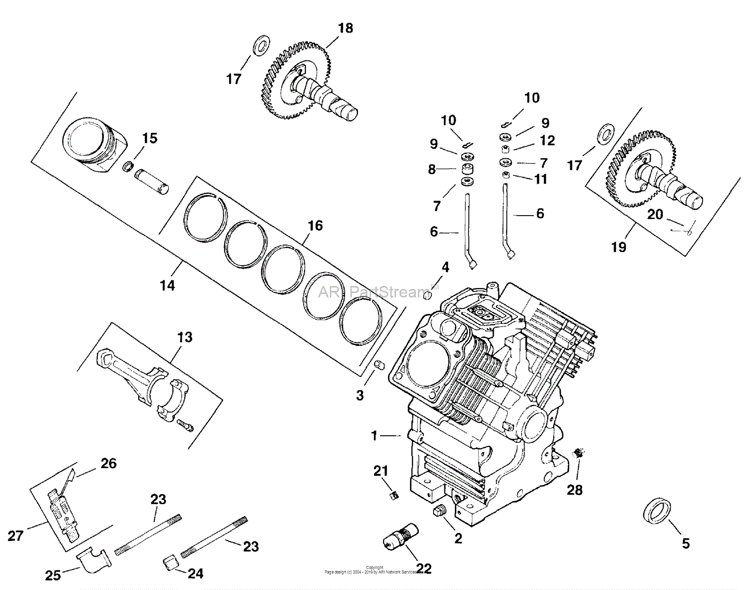

Looking at more documentation, I can’t see where the “jug” separates from the block…am I missing it?
   / More problems on the 425 Kohler CH25 #102
Looks like the ch25 does not have removable cylinders
   / More problems on the 425 Kohler CH25 #103
No, it does not have jugs. It's all one block. I typed jug, and immediately edited it to say block, but it was read fairly quickly. :p
