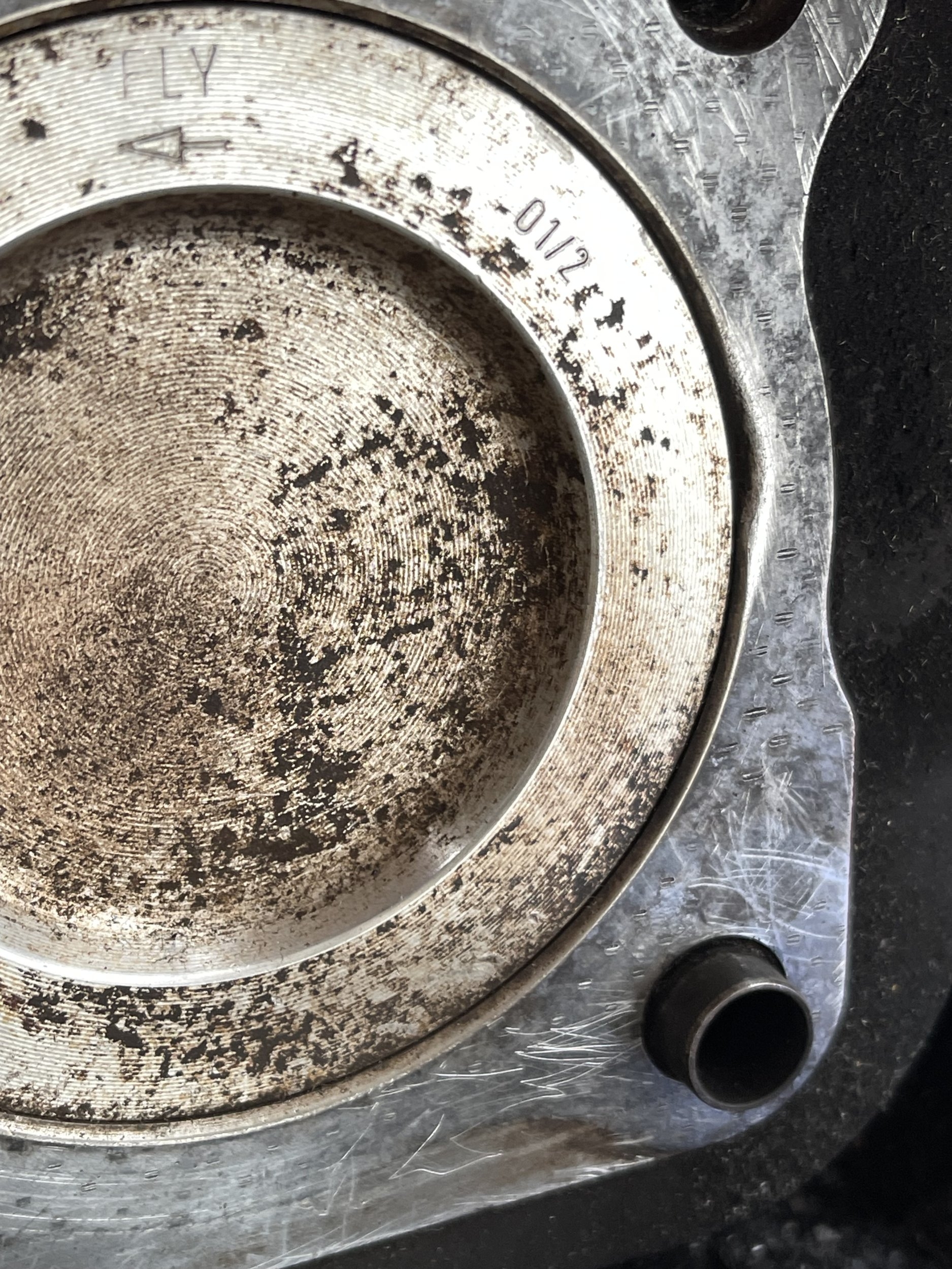

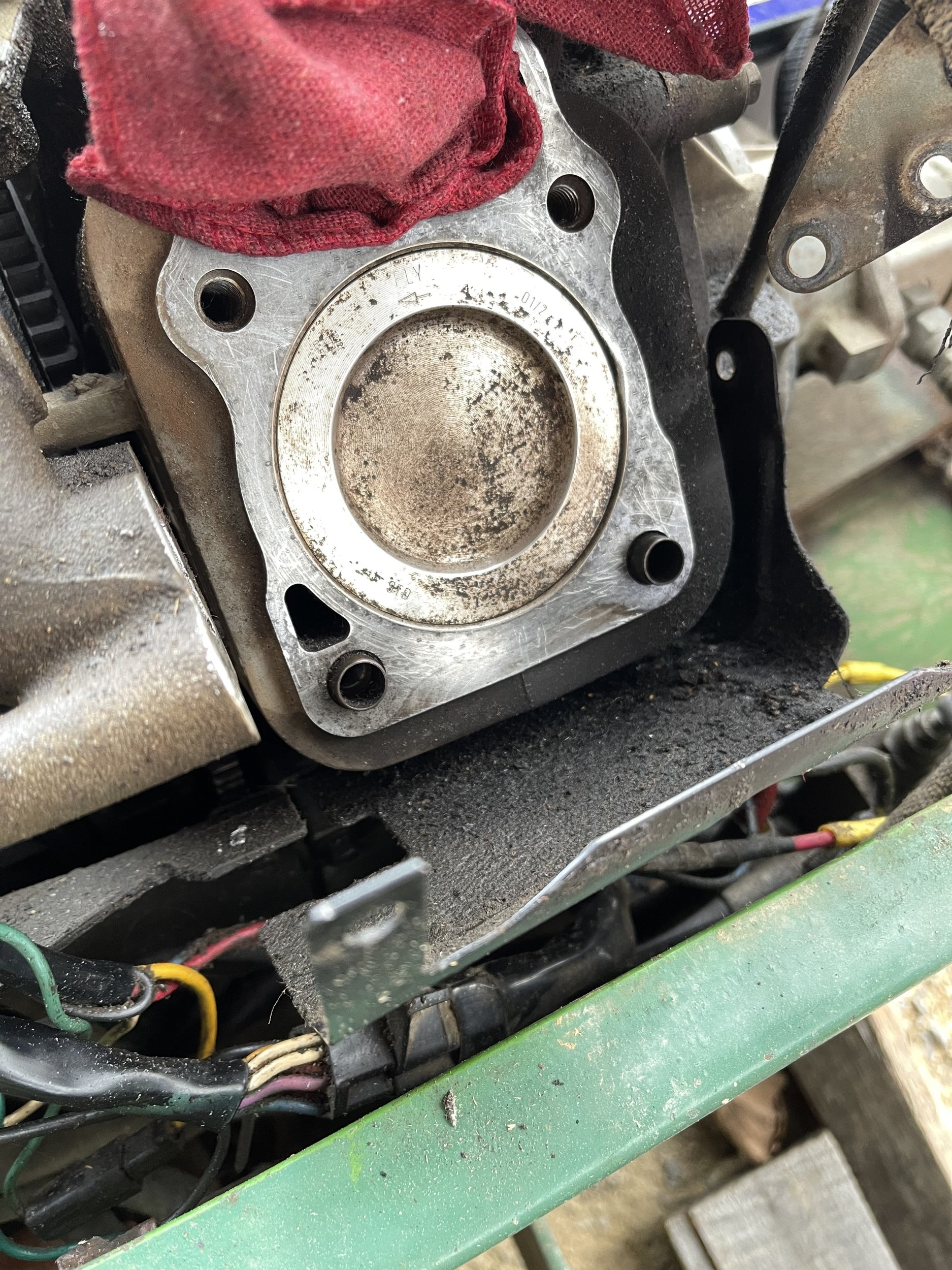

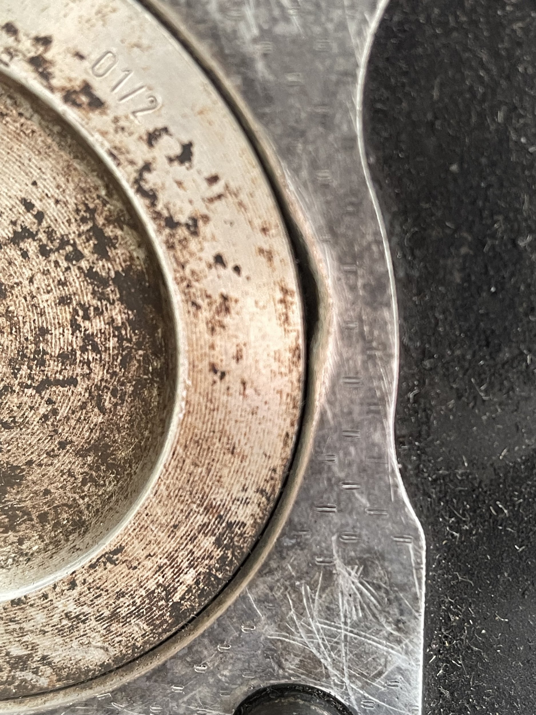

In trying to get started with reassembly, I discovered an odd thing—a slight ā€œdepressionā€ on cylinder 1. It’s at the top of the bore, on the exhaust side…

Is that the same cylinder where you found the mystery pin?
