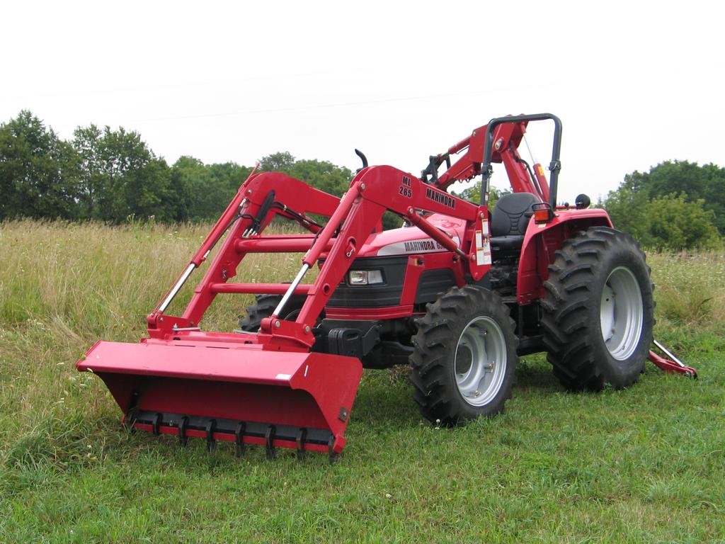

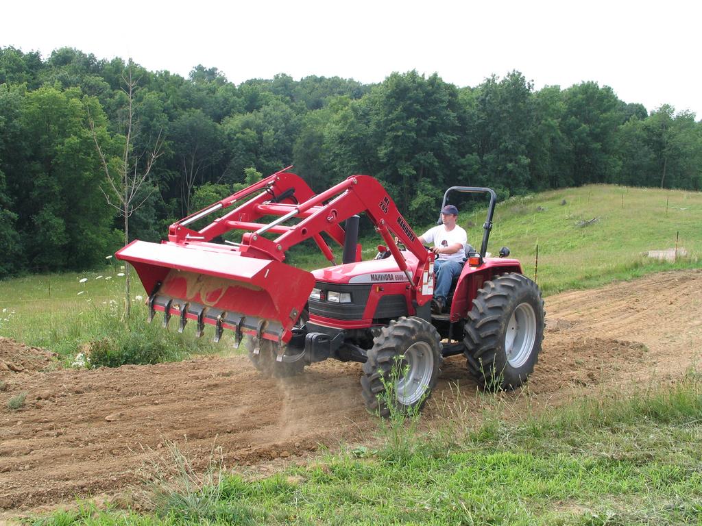

/ Momma Wants a Tractor #36
7AcherHaven said:
I looked at Markham Welding - Tooth Bar to see the Markham toothbar. What I see from those pictures is that the bar portion is set back and on top of the bucket cutting edge. Are there other Markham toothbars which make a new cutting edge and go over the bucket? I see the EZ Attachments one as a combination toothbar and wear bar. In my case I was looking for something to protect and reinforce the ML104 bucket as well as add teeth.
It most definitely supports the cutting edge. I went back and got a few pics of mine. One shows an up close of how the teeth go under and above the cutting edge and the bar they are welded to sits up and back to stay out of the way but also strengthens the whole edge. It doesn't add a new cutting edge but it does beef up and compliment the original.
