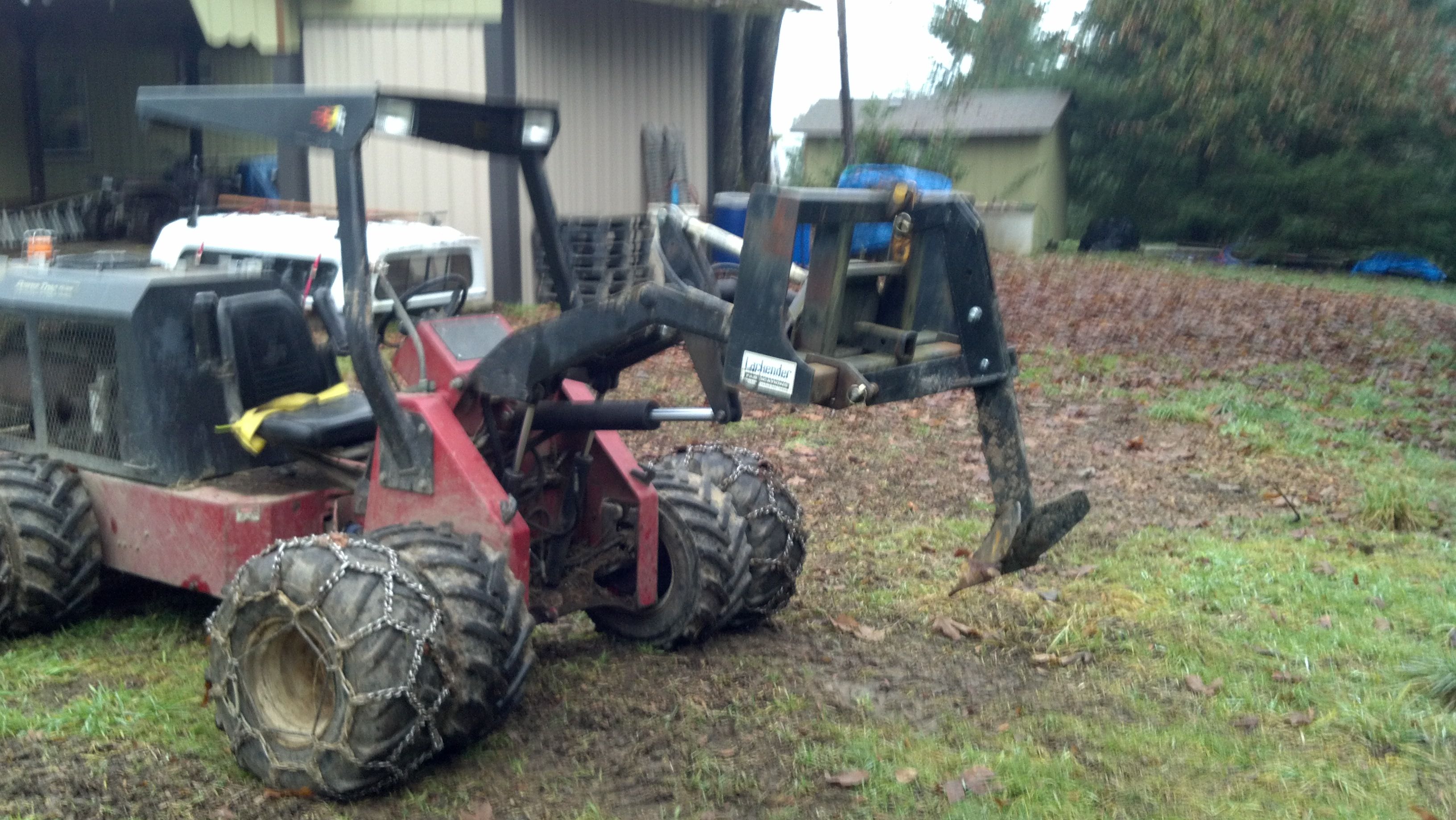

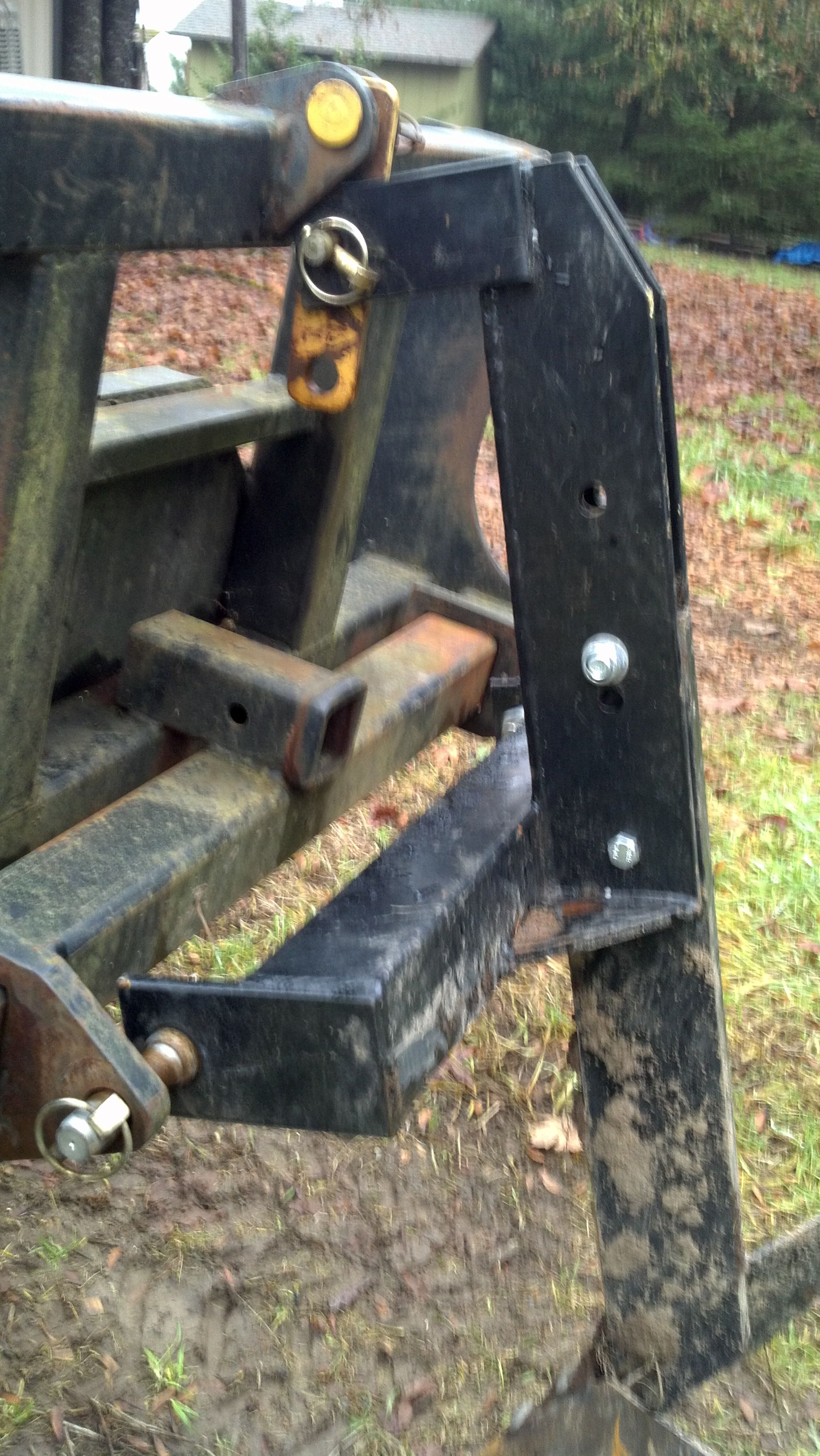

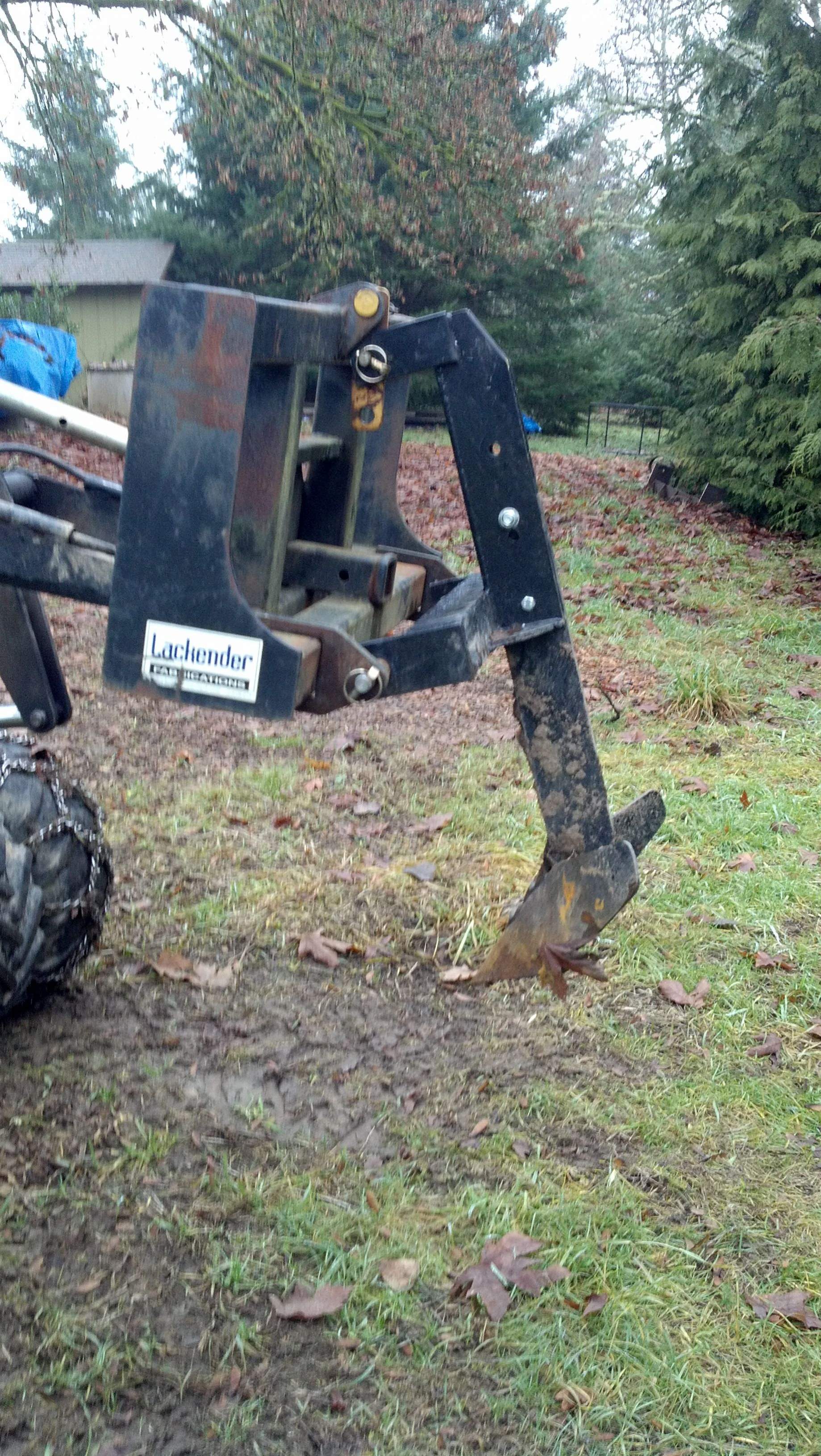

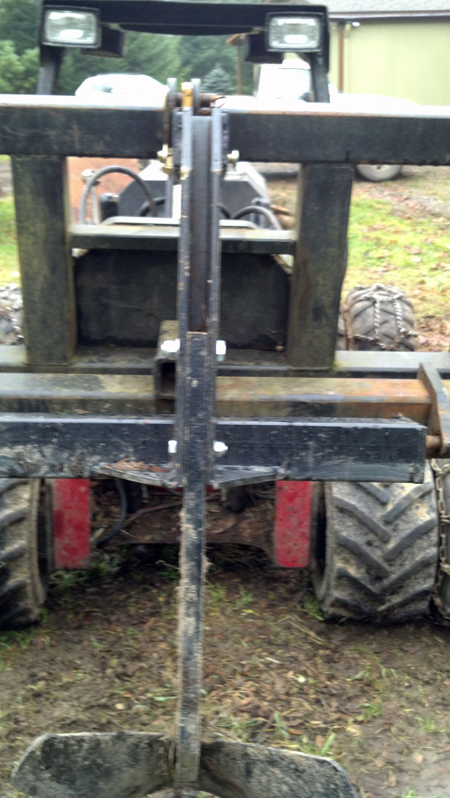

I promised pix, and this is linked to another thread.
I bought this from Northern Tool. It is the NorTrac version. I got it with the potato plow then ordered the mold board for another $40.
I got worried that it would be cheap and lightweight but so far it has held up very well. Later this winter I am pulling electrical and such with it.
As for dimensions..... It is a class 1 plow. It is hooked up to my 3 pt adapter so don't get too confused.
The plow is 16" at its widest. The depth is adjustable by 4" on the stem. I have it in its lowest position which will board at 22" and potato plow at 18" in the extended position. Clearly knock off 4" for moving the shank up.
As for use, I have yet to cut a straight line. It is really due to the Power Trac and its articulated center and the fact you are driving backward. But it works, and works pretty well. I have been digging ditches for runoff and so far am very happy.

Great pics. Thanks for the measurements too.

Carl,
I see a potential for damaging the 3pt arm if you hook on something solid.

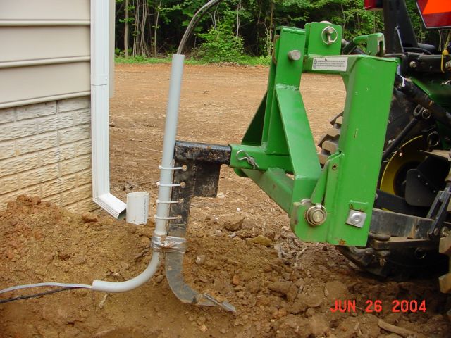

You can use that same shank with no plow, and weld a chain and bullet noses device for pulling wires. The purpose of the bullet is to expand the hole for the wire, and makes for less tension on the wire.
I have done the same thing using the bullet on the chain with a 3/4 galv pipe and threaded a PVC fitting into the back of the bullet and pulled a 100 ft of PVC pipe already glued. When you got to the end of the pull, you were done, except to finish out the PVC setup.
You can also pull several items at the same time.
If you think you might have roots, do a digging run first, and if clear, restart and bury the wire, PVC, black poly, wire, cable, etc.

I would think if you are burying cable, you don't want to pull it in because of the potential for skinning it. A radius bend in a pipe attached to the shank that you can feed the wire down and LAY the wire VS PULL the wire is what I would do.
Pipe, on the other hand, I would PULL rather than LAY. And stiff pipe has to be laid because it can't bend much anyway.
/ Mold Board - Potato Plow combo #15
pretty easy to bend some conduit and attach it to the shank to feed your wire through.
