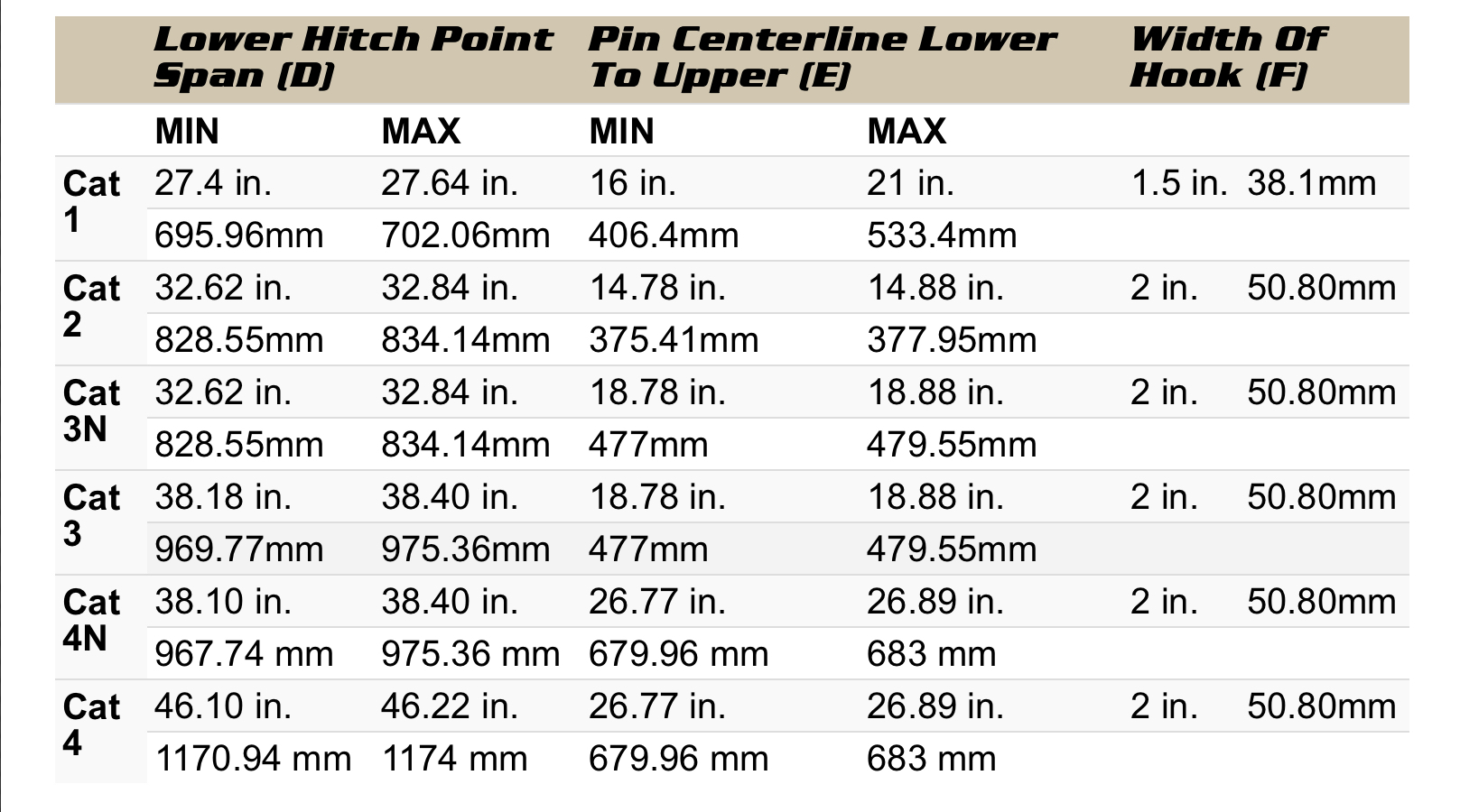

I have a Lee Boss category 3N quick hitch. I believe Lee makes the best strongest quick hitches out there. They are over 1k new. I didn’t pay near that for mine I got it at an auction nearly ten years ago. Anyway I changed tractors and am going to all cat 2. Looking at the specs the lower hooks are identical on a cat 3N and a cat two the only difference is the top hook is 4” higher on a 3N than on a two. Any reason not to cut off the top hook and reweld it on 4” lower?

If it works for you go for it!
/ Modifying a quick hitch #3
I have a Lee Boss category 3N quick hitch. I believe Lee makes the best strongest quick hitches out there. They are over 1k new. I didn’t pay near that for mine I got it at an auction nearly ten years ago. Anyway I changed tractors and am going to all cat 2. Looking at the specs the lower hooks are identical on a cat 3N and a cat two the only difference is the top hook is 4” higher on a 3N than on a two. Any reason not to cut off the top hook and reweld it on 4” lower? View attachment 690614View attachment 690615
If your welds are as good as factory shouldn’t be a problem!!
/ Modifying a quick hitch #5
I'm surprised that the top hook isn't adjustable on that. Anyway, there shouldn't be an issue with lowering it 4".
