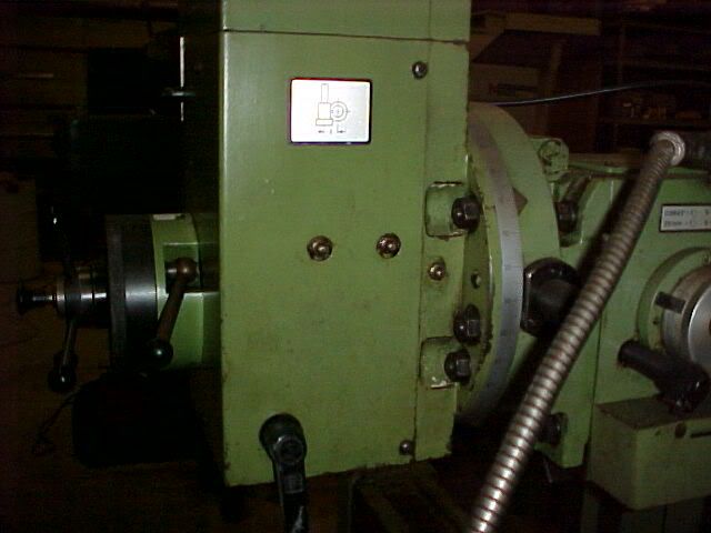

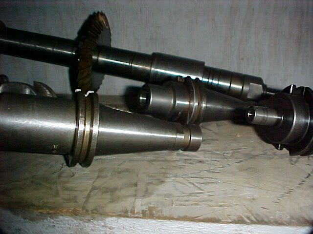

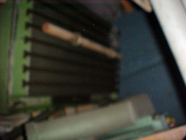

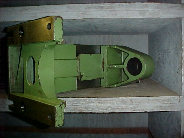

Money is what is stopping me from running my Maho, so I just keep the other machines running on what power I do have. Here are a few pictures of it. Enjoy!!
I just noticed I didn't have a picture of the left side of the machine, where the track is that the vertical head runs down to get out of the way when you want to use the horizontal spindle. The bed pictured separate (and very blurred)from the machine is the horizontal bed that can be removed. Current picture of the machine shows with it removed, which is something you can't do with my Bridgeport, lol!
David from jax
