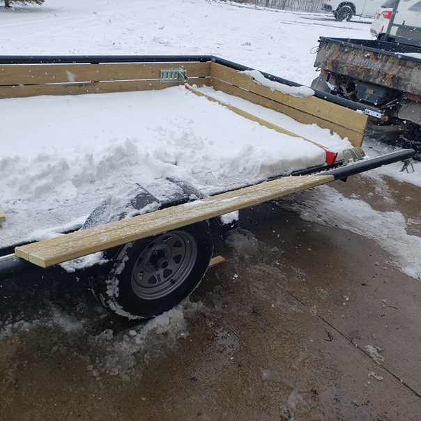

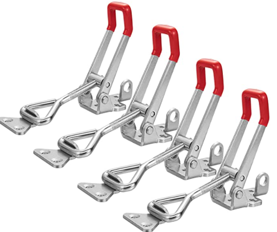

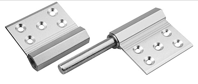

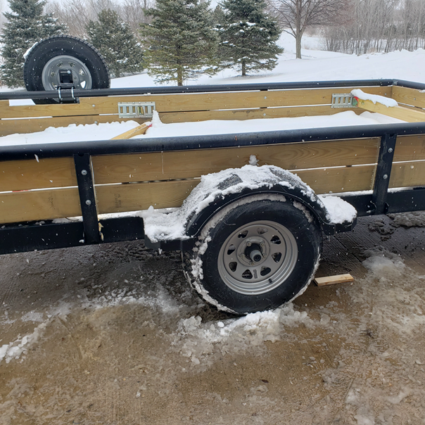

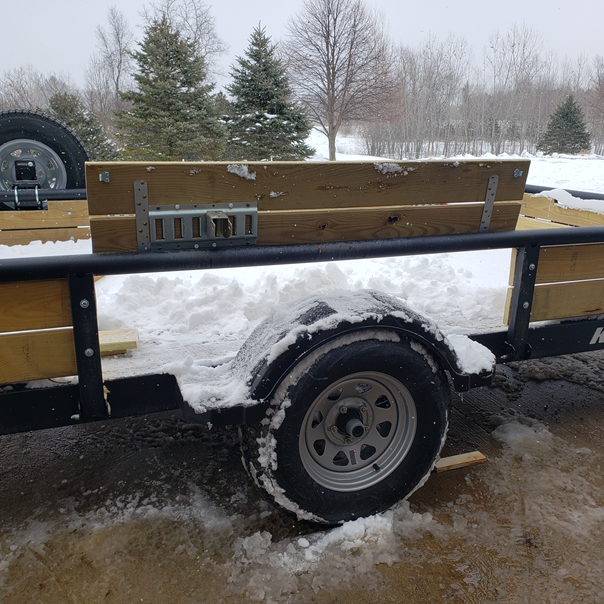

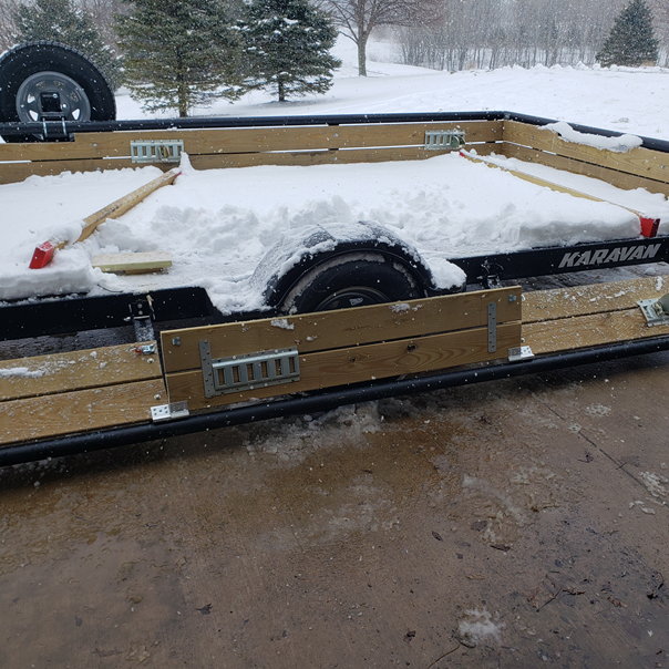

I bought this small trailer to haul the usual items, but wanted one that would convert to a flat-bed or allow for side-loading. The basic Karavan (home depot classic) allowed the sides to drop or be removed until I added wooden sides. I found some "Flag" or "Lift-Off" hinges on amazon and a couple of "toggle latch clamps" to allow the obstructed area to clear. I can now drop my sides in seconds again by pulling two pins and releasing the latches.

Sure makes shoveling off that snow easy! Nice modification.

I have the same trailer (mine is 5'x10'). I've been debating adding sides. Your idea will probably get me moving to actually do so. What size latch and hinge did you use? Do you have links to them?

Just used the trailer for the first time and needed the drop-down. I went to pick up my 6' landplane. The FedEx guy said he wasn't going to be able to load it because it would crush the tailgate. I asked him if he needed me to drop the sides and he said they don't drop :) He was able to get right up to the trailer and side-load the massive landplane that was on a pallet.

What are those racks attached to the inside of your wood sides?

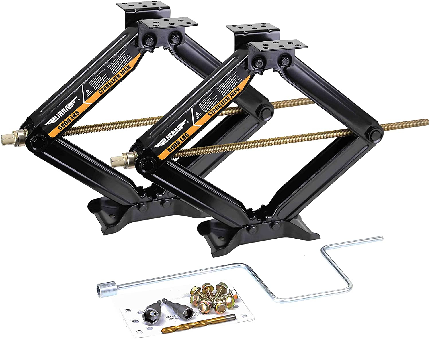

Nice handy trailer JohnnyMX. In fact, I bought myself the 6x12 version. It'll be strictly for utility purposes though, not for my tractor, etc.
First mod I made was to add rear stabilizers. Two wheel trailers will definitely flip up if they're not firmly hooked up. I know... I've seen a near fatal accident of such. Here's what I installed for a mere $75. Safety first - right?

The racks are 1' sections of e-Track. I got the cheap stuff at HarborFreight. I have some d-ring/tie downs and beam sockets that I use to split things up when needed.

It does indeed get tippy. I generally am not on or off the trailer without it being hooked up. I walked up once when I realized why I shouldn't. Are you welding the jacks or using some sort u-bolt or just bolting down?

I'm also interested on ow you are mounting those. I've just been wedging some logs or a stack of scrap wood under them when driving something heavier on.
I had thought about mounting some sort of "kick-stand" or perhaps the stabilizers like what you had, but I'm concerned about losing ground clearance.
There is not much clearance as it is under the rear of this trailer. If I mounted to the frame, I would lose too much, and probably bottom out on the stabilizers on even a modest rise. I could bolt them to the underside of the wood decking, which gains a few of inches, but will make the crank attachment point difficult to reach. I'm also wondering if the wood deck is strong enough to support that point load - especially as the deck ages.
/ Modified Utility Trailer #18
I simply bolted each jack to the frame rail. The rail isn't wide enough to utilize all of the pre-drilled bolt holes on the top of the jack but using 4 of the furnished 3/8" bolts seemed sufficient. It comes with a drill pattern with many options. Each jack has the capacity of 6,000# - each being far more capacity than the trailer itself.
For easy access, I mounted one jack on each side at the end of the trailer on the side rails with the adjustment rod pointing out toward the end of the trailer. That would put the front of each jack top pad 11" from the end of the trailer, one on each side. I would not mount the jacks to the wooden floor - only to the frame itself.
The jack kit on Amazon comes with all bolts, drill bit, two sockets for a drill use (9/16" & 3/4") as well as a crank handle for manual use. Using the 3/4" socket in a cheap cordless drill works like magic. I experimented jacking my up fully loaded to a height of rising the wheels 5" off the ground easily with a cheap cordless drill. No problem at all with the strength of the jack.
The reason I selected the scissor jack over the swing down jack was the clearance issue. The swing up type jack stabilizer, as you mentioned, would take up too much of my ground clearance. The scissor jack only requires 4" of clearance.
Unfortunately, 4" loss of clearance is more than I can afford to lose.
At one point I was debating mounting a swing up trailer tongue type jack off the side of the frame, so I would lose almost nothing in ground clearance. For now, I'm still using logs and scrap wood.

Latch Clamp -- 5.7": https://www.amazon.com/gp/product/B09HKCTK22
Hinge -- 4 5/8" x 3 3/4": Amazon.com
I think you can get smaller sizes as well, but I liked the hinges for other projects as well.
