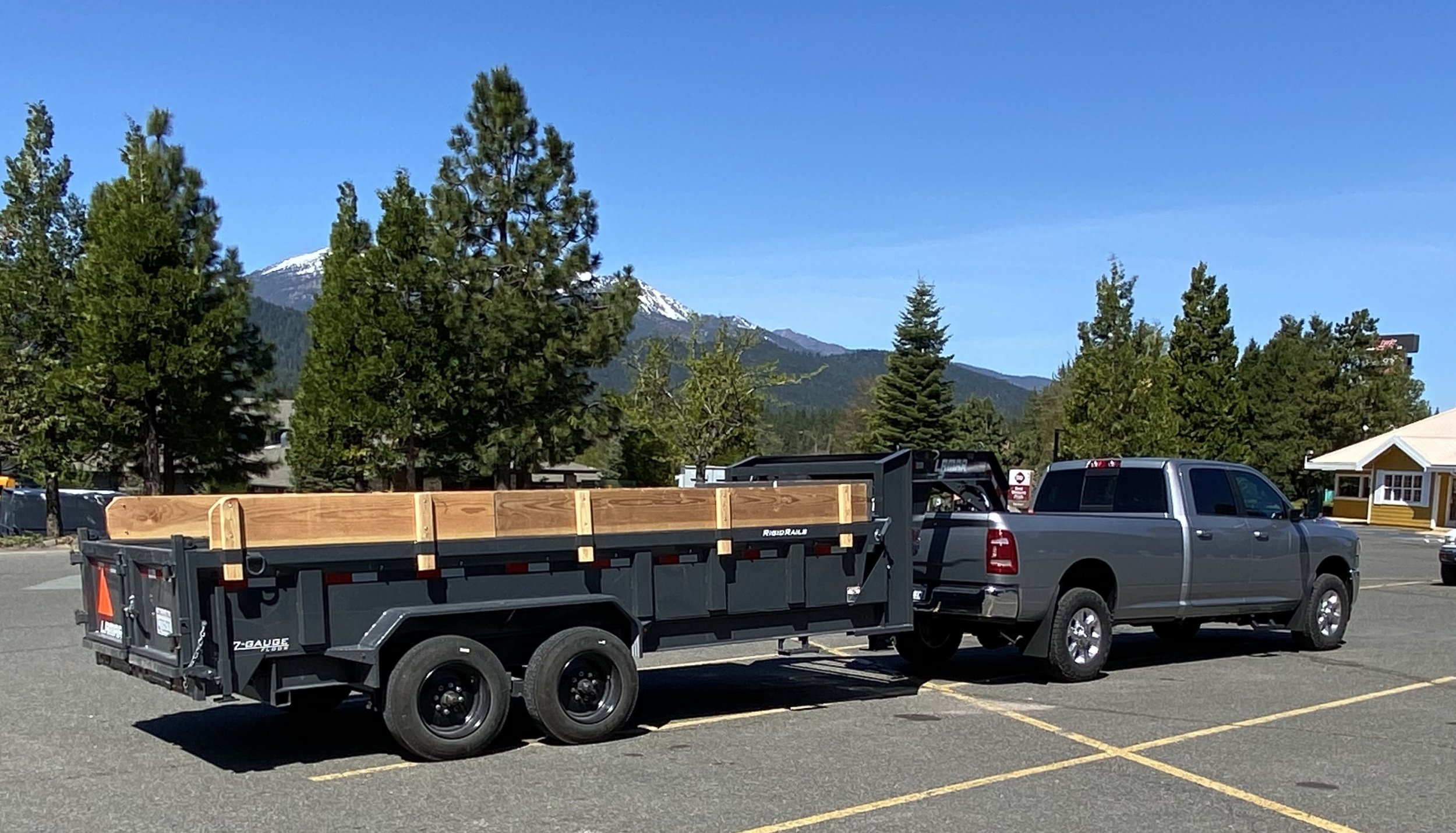

This Lamar 16' dump does it all.

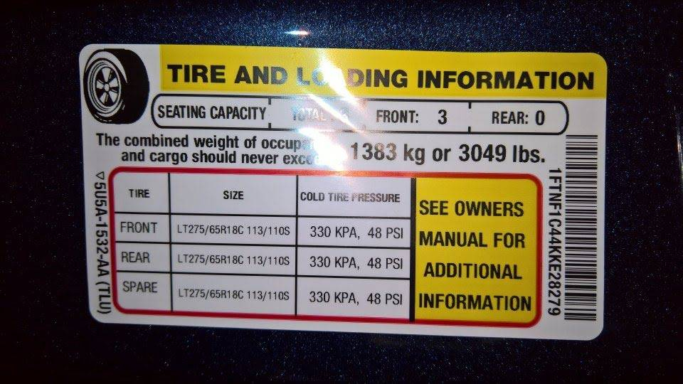

What will your truck tow? You said 9500 pounds, where did that number come from. What is your payload? On newer trucks it printed on the door jamb tire sticker. For example mine is 1940 pounds. That payload is all fluids including full fuel but nothing else. My example above my truck has a payload of 1940 pounds, take my weight and my tool box and other stuff in the truck, I’m down to 1550 pounds. Say your trailer weighs 10,000 pounds, and you load it perfect 10% hitch weight, that’s a 1000 pounds. Say it’s a little nose heavy than it’s a hitch weight of 1500 pounds and my truck is barely adequate.
Also keep in mind half ton trucks come with a class IV hitch, which requires a weight distribution hitch for anything over 5000 pound trailer weight or 500 pounds of hitch weight. Also ignore all the towing hype listed for trucks. Ford says they make a half ton truck that has a 3000 pound payload and will tow a 13000 pound trailer. They hardly make them because that would be a half ton regular cab, 2 wheel drive with no options.

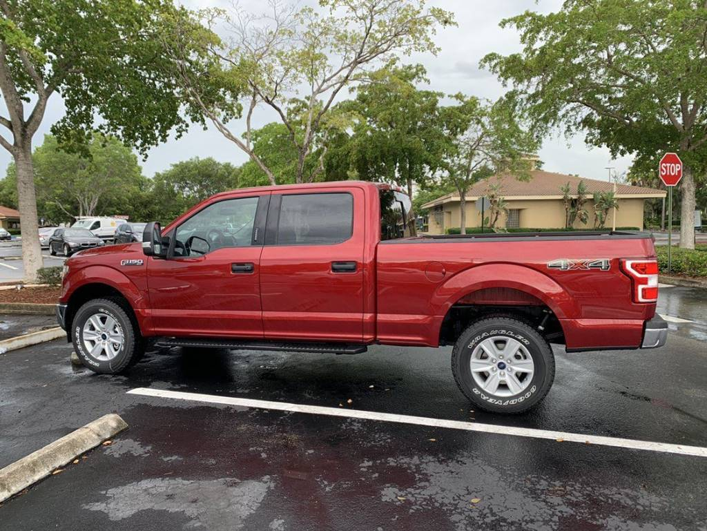

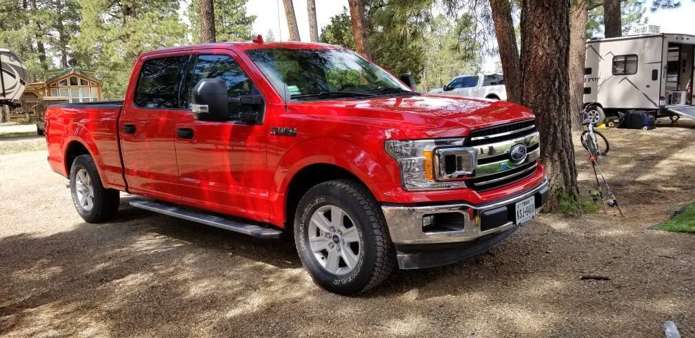

Meh, sort of. The heavy duty payload package carries a 7850 gvwr which can still net a decent payload with some options for a half ton. Here are a few of the best I've seen, but you're right it's a rare package. And with a max tow you can achieve that max tow rating even with 4x4 and some options, if you get the max tow package with 20" wheels. However in most cases it's hard to balance that with the payload ratings unless you buy a truck that is both HDPP and max tow.
Some of the more capable HDPP trucks I've seen.
This one is 2wd but a decently optioned XLT
4wd XLT
2wd single cab. Only way to get 3000 lbs
In my opinion it's more about familiarizing yourself with the options and the packages and knowing what you're selecting. Especially in the half ton market they offer a huge range of capabilities, both in payload and towing. People see the commercial and don't realize those numbers are a specific package. They make an f150 that can only tow 5,000, a s one that can tow 13,000. They make one with a 1000 lbs payload, and one with 3000 lbs payload. With the current j2807 testing standards the numbers are a little bit more regulated than they used to be.

I feel lucky mine is at 1940 on payload. You see a lot of the highly optioned ones like Platinum models that can get below 1500 lbs.

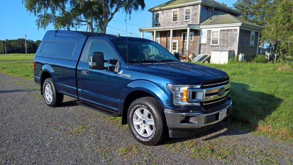

Platinums, lariats, king ranches definitely carry low payloads. I think that's a matter of choosing the right tool for the job. You can get a really well optioned XLT. Mine has the large touch screen infotainment system with Android Auto, power seats, pedals, and windows, power sliding back glass, heated seats, remote start, door keypad, cloth seats, color matched bumpers, grille, and door handles, boxlink cleats in the bed, premium 18" wheels, in bed lighting. And probably some stuff I can't remember. I can't fathom what else I could need.
Anyway I guess if my goal and my need was a high payload, I would understand that I need to cross those upper trim levels off my list.

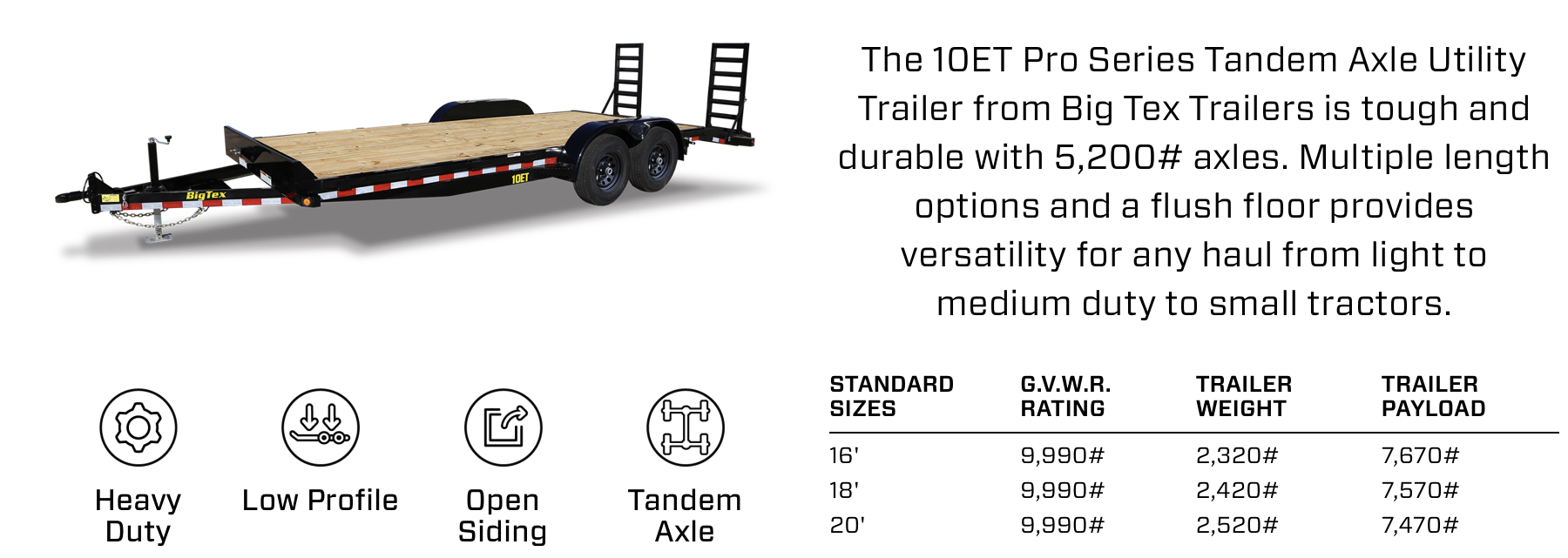

This type of trailer with a flat deck will give you good versatility. You could make side boards for it to allow dirt or such if needed. I would buy it as a straight deck and add aluminum curved aluminum ramps to load the ZT or ATV. There is no problem with loading from the side with a forklift. The lower deck trailers with the high fenders are a pain because the fenders are always in the way.
Look at page 4 of the brochure:
Ramps for example only:
