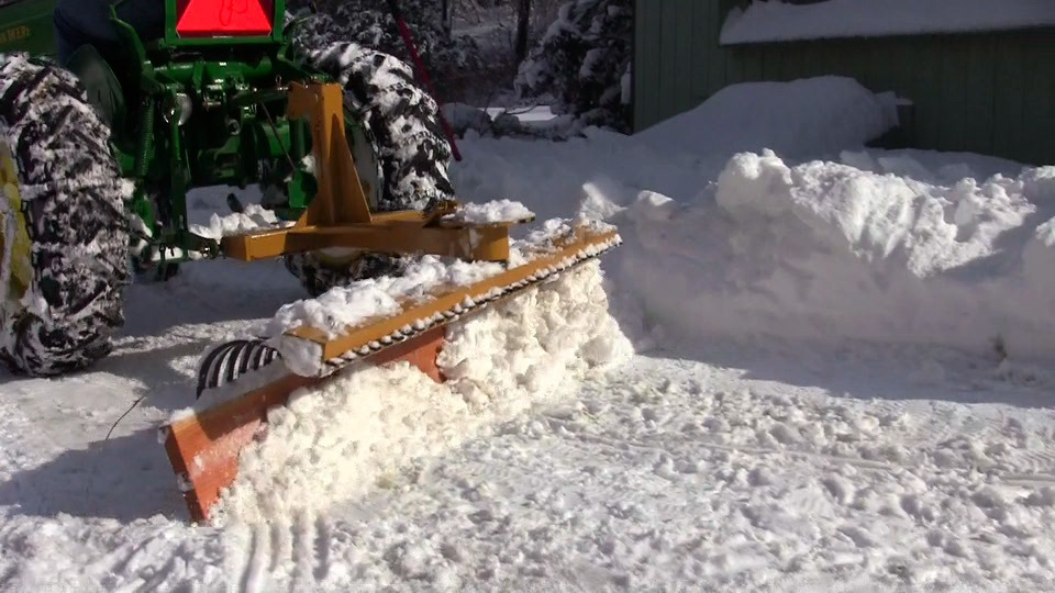

Here's a modified landscape rake my buddy used to clear his driveway. He came by and cleared my place. He just bolted a 2x10 to the rake. Improvised but works.

Good way to use what you have but he could have done it in 1/4 the time by driving the tractor forward and allowing the tires to bite. He spent more time spinning then he did moving.

Another thing that may help is having the right chains. The ones on there he got for free off an old fire truck that was getting scrapped. A majority of the cross links end up falling between the lugs of the ag tire. But the price was right so he figured he give them a shot!:D

Would that setup work as well (or better?) with the tractor moving forward and dragging the rake?

I completely understand enjoying old equipment, as well as using what you have. I am sure he enjoyed it, and I would too. But, I would hate to have to rely on that setup to clear much snow. Meaning more than a couple of inches.
I don't blame the tractor though. The biggest problem is that the 2x10 tends to just ride on top of the snow. Weight or an edge of some sort would probably go a long way.

Yeah, he wants a frame mount front plow and he's got a line on a FEL for it. We just don't normally have this much snow! We're shoreline Ct. A shovel and a four wheel drive vehicle usually plenty.
