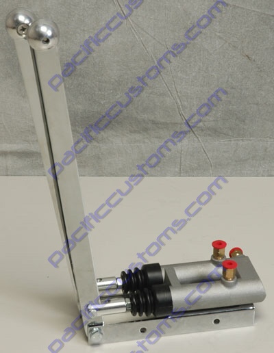

So for a while I've been wanting to build a pow'r pup tractor. Older plans call for using a Ford Model A axle and 3 speed transmission, however both are incredibly hard to get a hold of. I was thinking using a Ford 9" or 8.8" rear axle and a 3 speed with granny gear transmission (T18 or Sm465) and cut the axle to about 40" overall. One thing the plans never stated was doing steering brakes. I was thinking just using two master cylinders on 2 brake pedals and blocking off one of the lines on the master cylinder and just run one line to each brake. However I'm not 100% sure that would even work. Option 2 was to just run the emergency brake cables to the pedals instead of having hydraulic brakes, but I'm not sure if that would be effective enough.

Another option on brakes would be a pair of line locks within reach of the driver, or single circuit master cylinders.

For the brakes you could get a steering brake setup for a dune buggy , let’s you have a single peddle for normal stopping or use one of the handles to help steer.
Dual Handle Upright Steering Brake With 3/4 Bore For Disc Brakes
