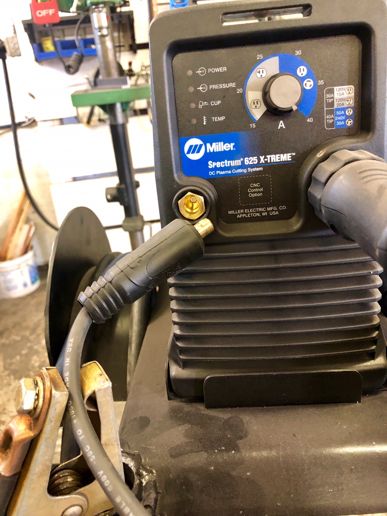

Mark. If. You are considering quick connects I would go with the small Dinse 10-25 size which has a 3/8” pin. This would work well with your AWG 6 ground wire.
Pic of my plasma cutter with Dinse 10-25 panel plug. I upgraded the wire to 6 AWG from the smaller horrible 10 AWG that is impossible to coil up.
The larger Tweco or Dinse 35-50 plugs are unnecessarily big for your applications. IMO

yomax, I looked at the Lenco LC10 and they are rated for 4 AWG or bigger. Is there a smaller one as I am working with 6 AWG.
Mark. If. You are considering quick connects I would go with the small Dinse 10-25 size which has a 3/8 pin. This would work well with your AWG 6 ground wire.
Terry, I was hoping for something in line that I could disconnect relatively close to the ground clamp so I don't have to have another full run of wire. Are there Dinse plugs for inline applications or just for panels?

That’s a good idea about swapping with your plaz. Earlier models were hardwired. IF you have room on your 211 I would try to install a panel plug. Much neater installation.
Do you have the tranny 211 or the newer inverter?

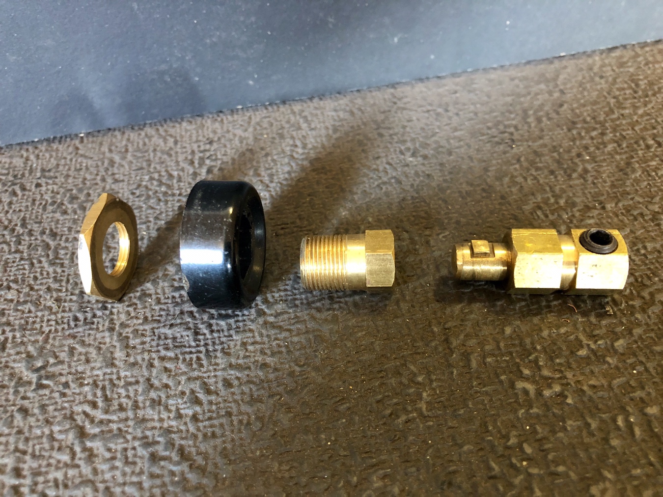

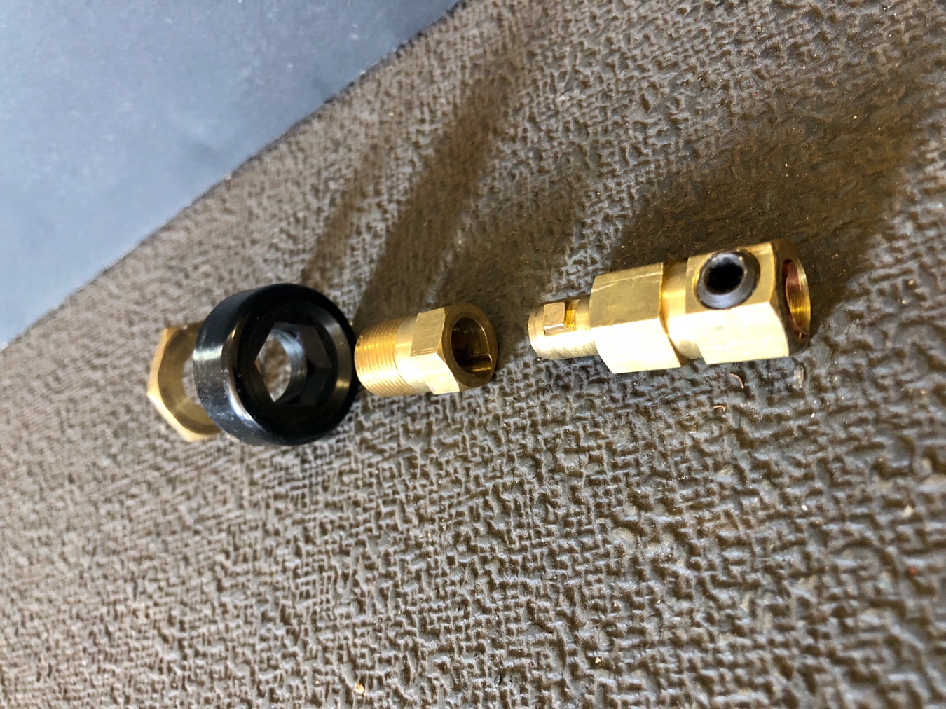

I knew I had a small Dinse panel plug and connector somewhere.
I swapped in the larger size to make the ground cables interchangeable for these two Thermal Arcs.
Yours if you want it Mark, as it is of no use to me.
