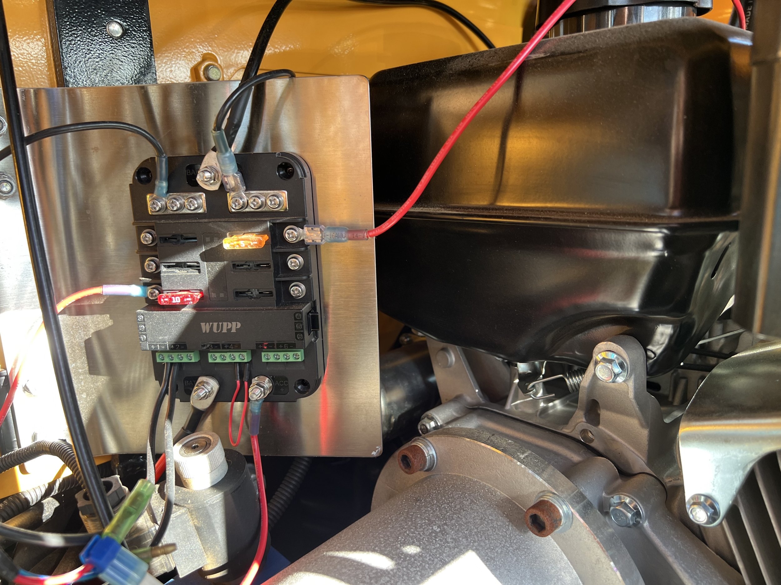

Add-on fuse box
- Fuse box itselfAmazon link
(note the integrated relays to simplify everything)
- Mounting plateAmazon link
(drilled 4 holes to match the hinges on the left door, bent the plate a bit to both direct some air and avoid the battery cut-off switch, mounted using the door hinge bolts/nuts)
- hook-up cablesAmazon link
- Other stuff for wiring things inWire: red: Amazon link & black: Amazon link

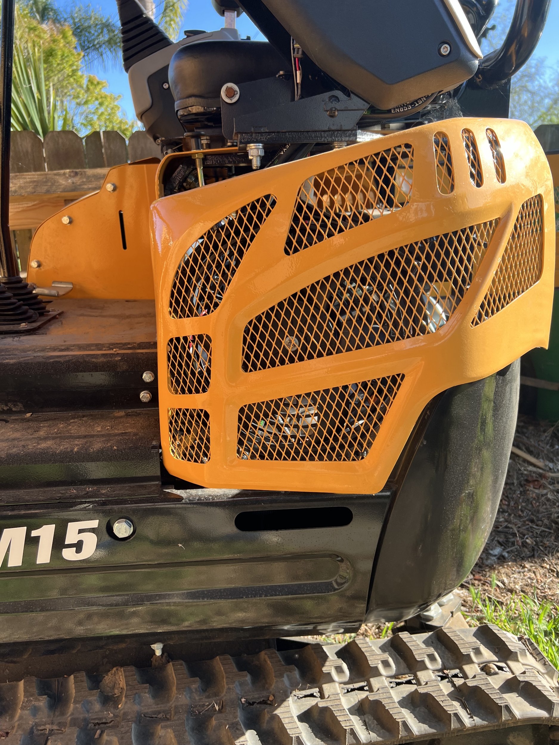

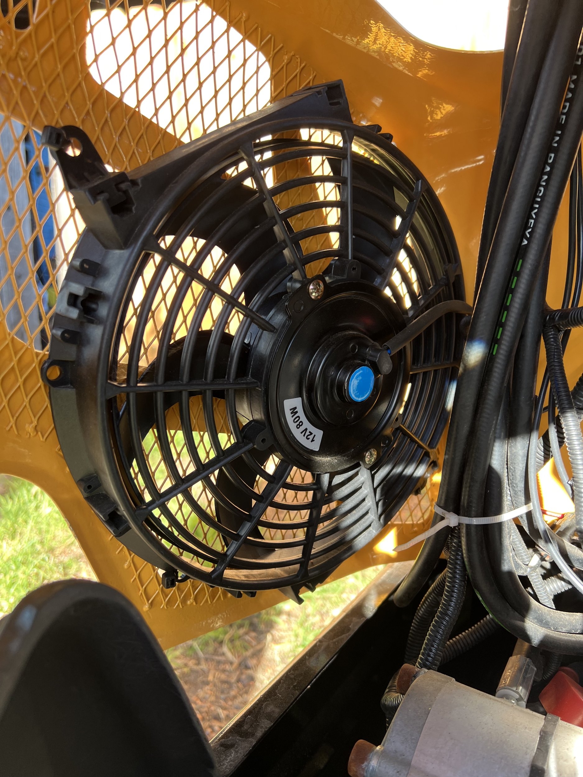

Cooling fan
- 10" fan (zip-tied to the inside of the left "door")Amazon link
- switch (needs switch adapter, above)Amazon link

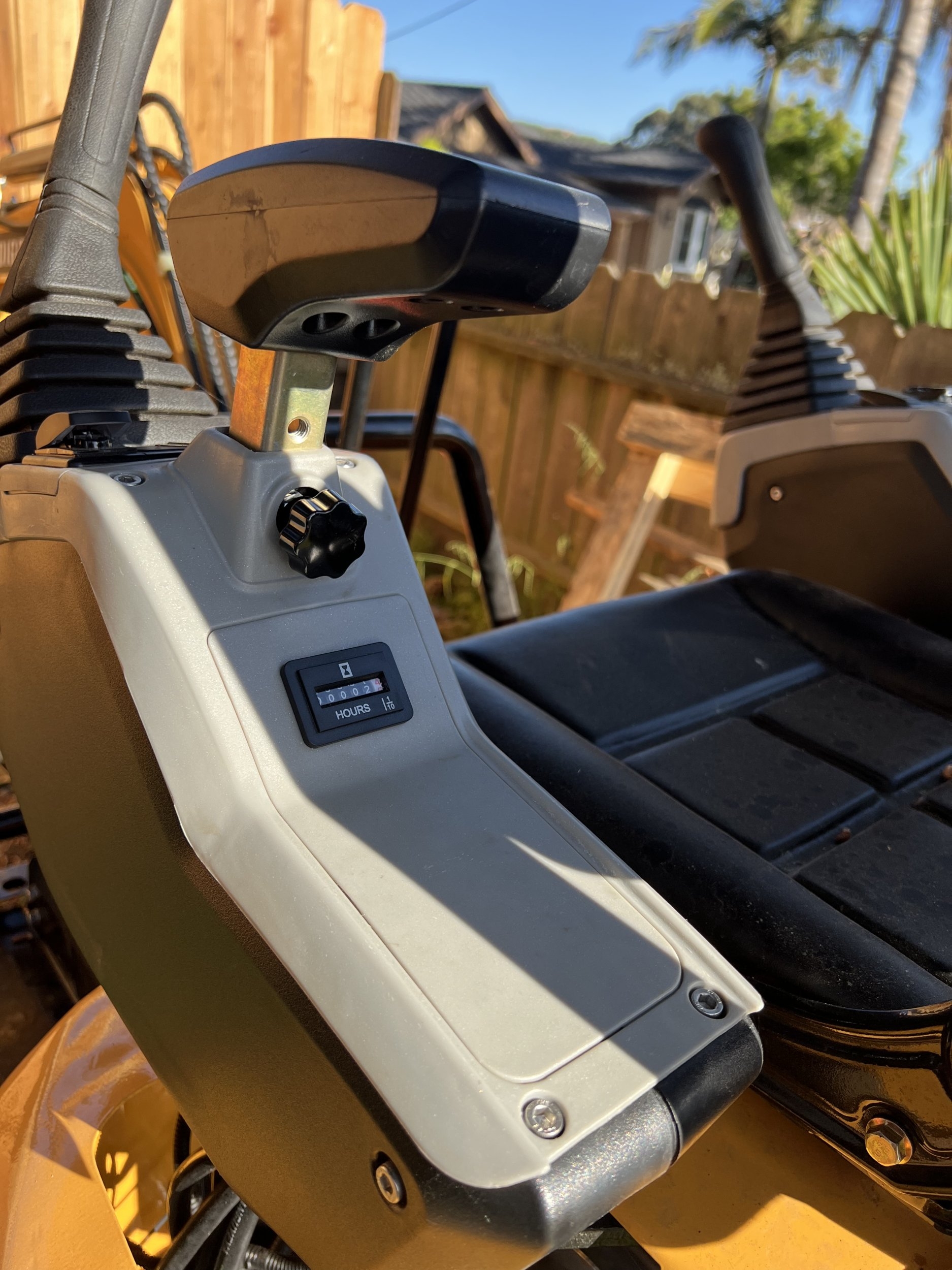

HourmeterAmazon link (I prefer mechanical, non-resettable)

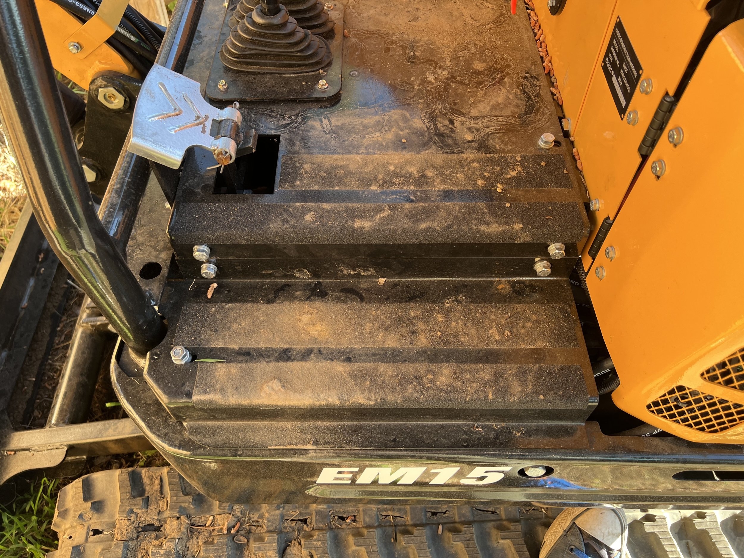

Traction tapeAmazon link (added on the edge of the platform and "step")

Fuse box (with the cover off) mounted to the stainless plate using pop rivets:
Note the jumper on circuit 4 -- this is because I don't want the voltmeter / USB ports to be switchable (other than the ignition, which controls the whole fuse box via the ACC post [bottom right])
Cooling fan (radiator fan):
Connected to circuit 1 on the fuse box, switch positioned in the left side pilot controls switch panel. Luckily, this fan comes arranged as a puller, so it's just a matter of crimping on terminals and zip-tieing it in -- no flipping the fan over (not that it's a huge deal to do so).
Fan viewed from the outside:

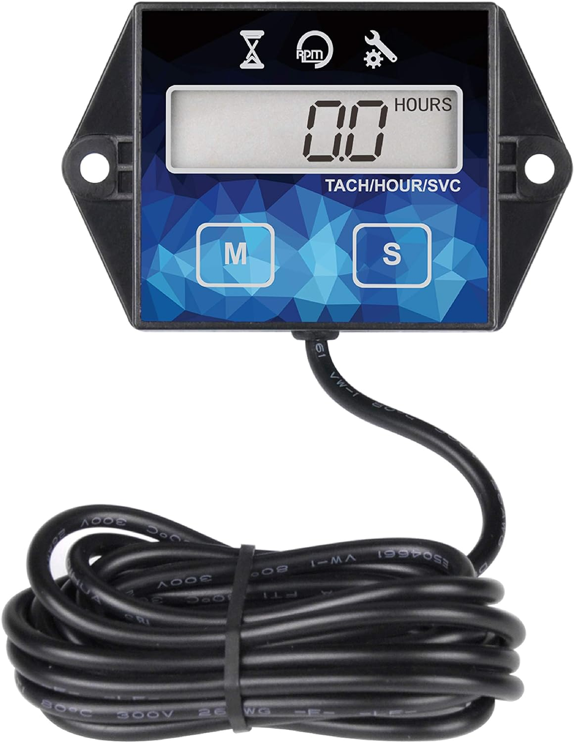

Hourmeter:
Just popped off the panel, drilled a couple pilot holes, used a coping saw to cut it out (jigsaw was too violent for such a flimsy piece of plastic) and then used a rasp to refine the hole. Wired to an unused circuit that I confirmed was ignition-energized (the one labeled [somewhat ironically] "cooling fan" according to my translation app on my phone).
Traction tape:
I have a roll of this that I bought to do the same treatment to my tractor -- rolling it over the edge is key.

I like the Diggit product, I would like to try the Pilot Joysticks, but so used to leaning forward now.
I used a Tach/Hour Meter on my units. Not that RPM is that important but nice to know, easy to install.
/ Diggit EM15 notes, mods, etc. #4
2 thumbs up on the hour meter installation. I also like the electronic tach/hour meters. I have used them before on 2-stroke equipment. The mechanical hour meters do not seem to be waterproof, so be careful about washing.

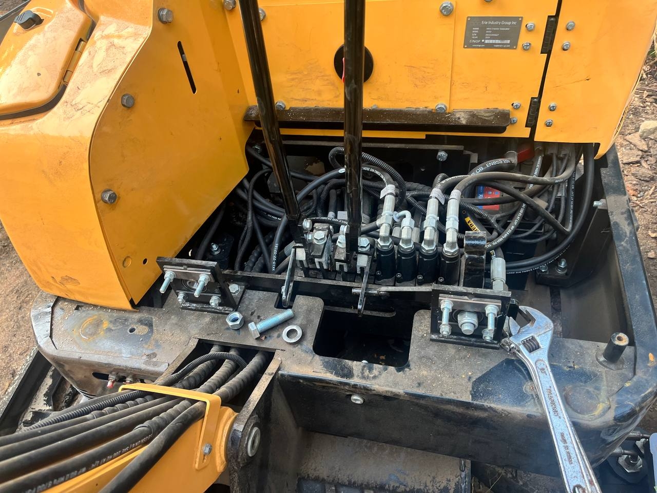

I am trying to find a Hydraulic thumb that will fit our excavators.
If your machine has the pivot brackets on the dipper, they are designed for the mechanical thumb. Unfortunately, an hydraulic thumb will not work well with those pivots.
To do it properly, you need to remove those pivots and weld new ones on the dipper so the lower one is closer to the end of the dipper, and the upper one allows the hyd cylinder the proper stroke so that it retracts out of the way.
Here is the write-up I did, if you want some ideas.

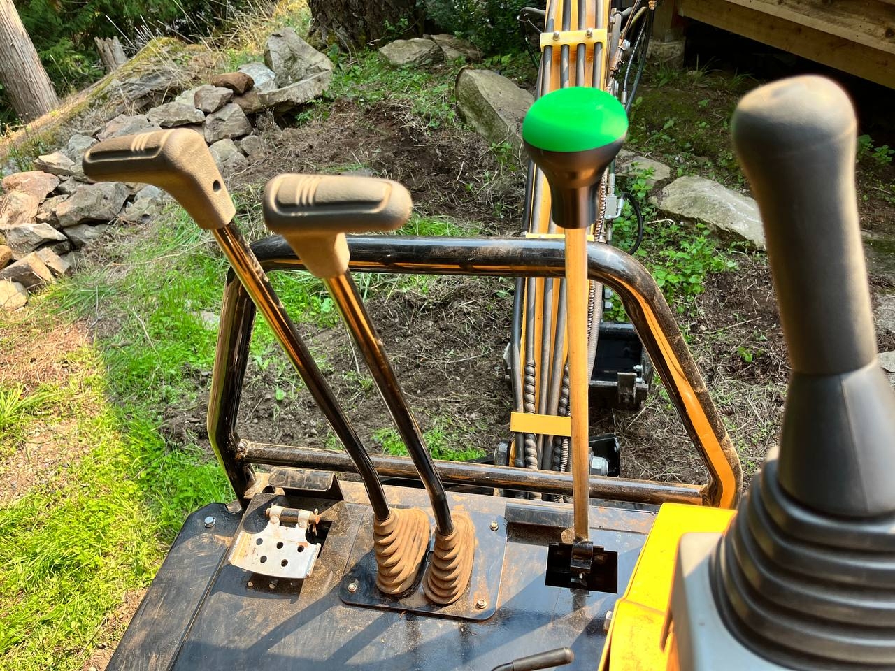

Glad I found this thread, very good information on the EM15. I'm interested in hearing how owners of the EM15 find the foot pedals. Personally I have really struggled with the side ways foot pedals especially for the blade. I have a hard time controlling blade height when back blading. I find the foot pedal is not very granular and I was constantly having to stop to adjust the height. I opted to remove the foot pedal and turn it into a handle. I added a 3d printed grip and am much happier with this setup. Interested in hearing others experiences with the side ways foot pedals. Thanks.

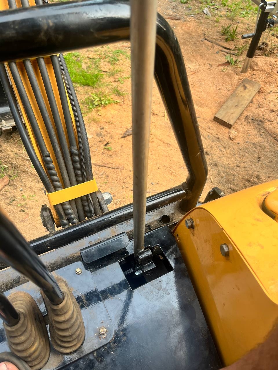

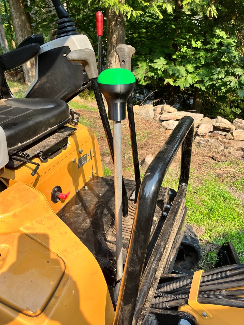

Good modification.
I have operated the EM15, but not for very long. Like you, I did not like the foot control for the blade. I very much prefer my hand lever control on my Rhino, but I attributed some of that to being used to it.

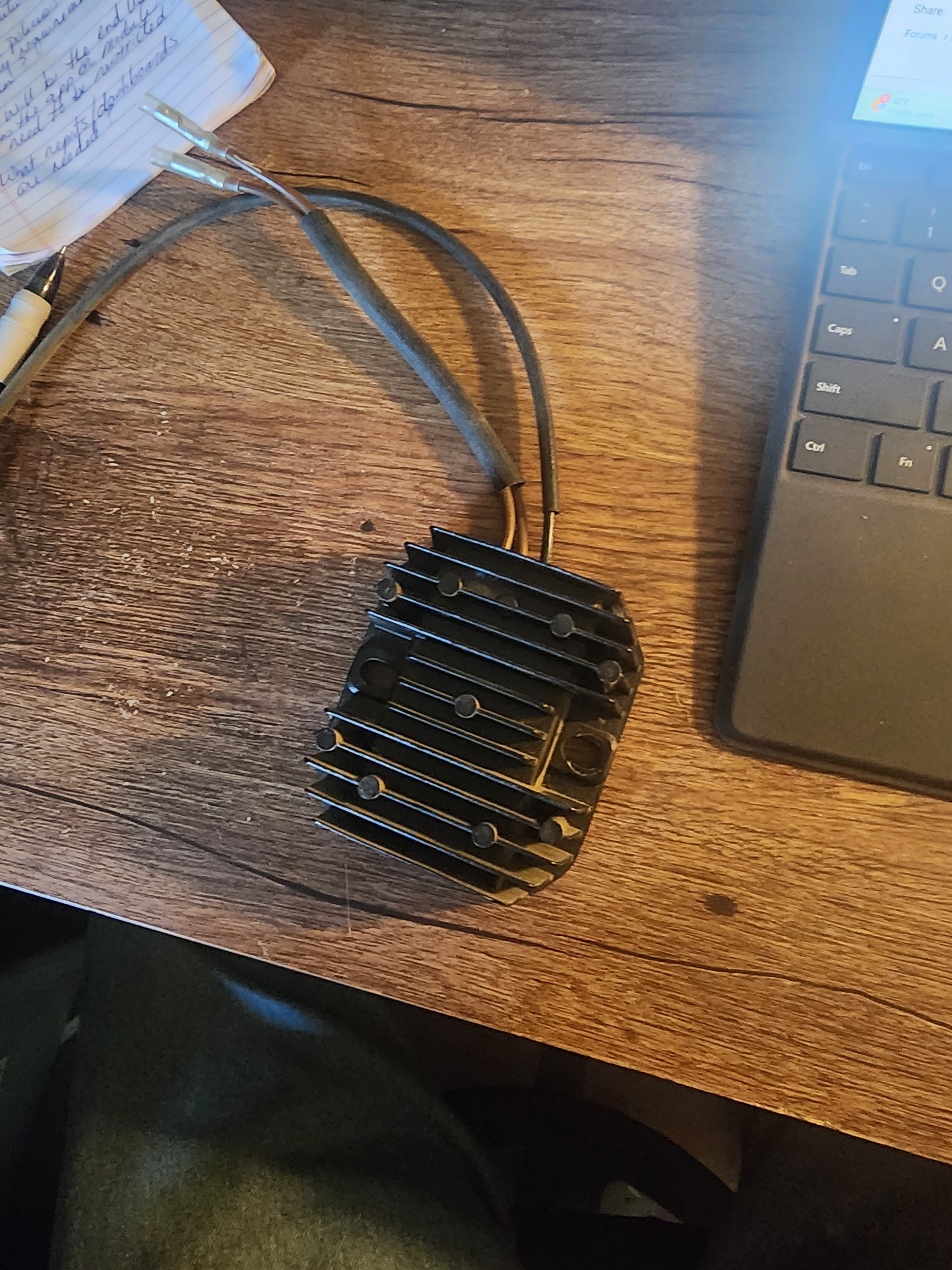

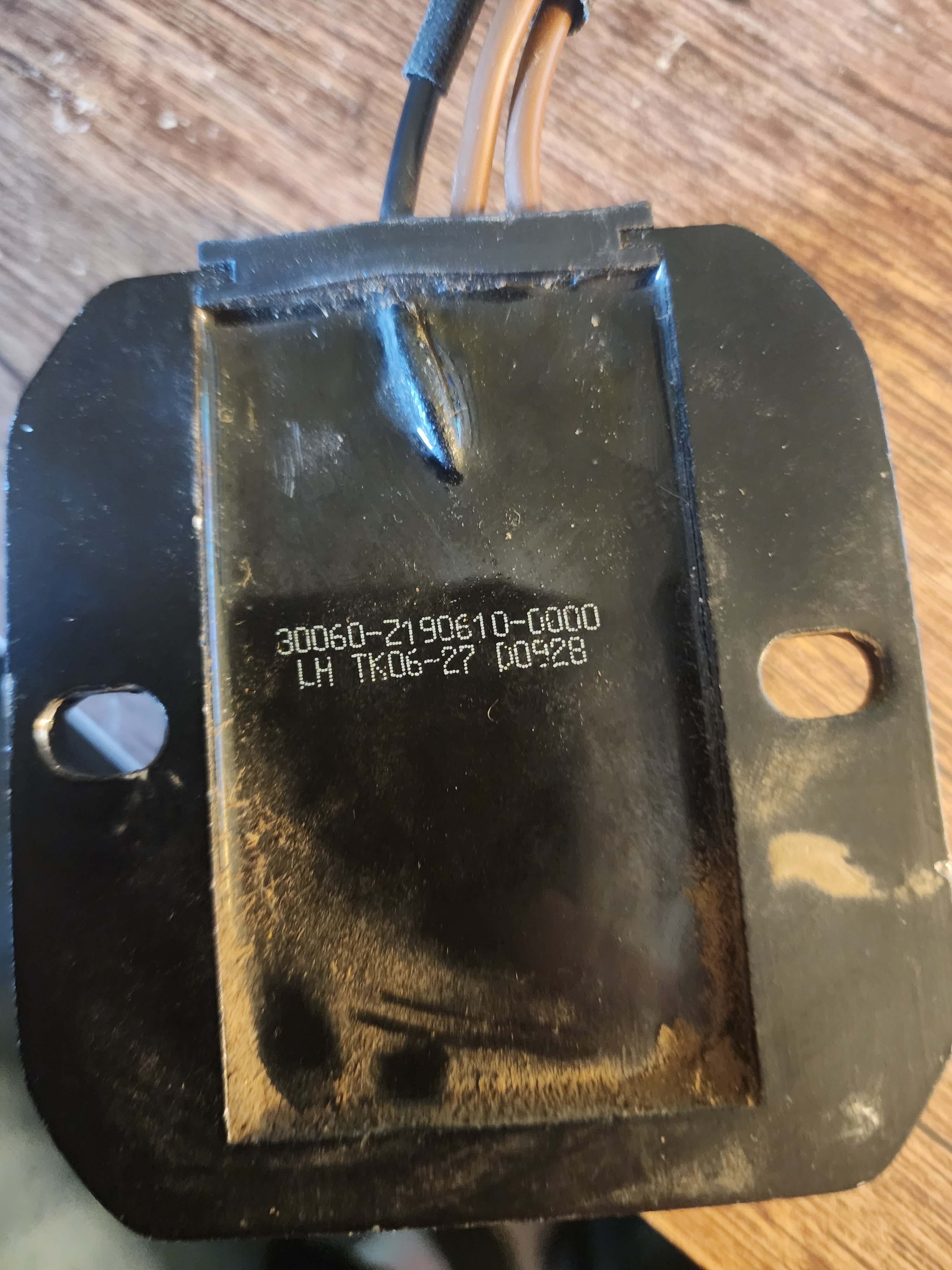

Anyone know where I can get a new one? After 58 hours the red wirte just broke
Pretty much any 3-wire regulator/rectifier for 1-cylinder Honda-clone engines will work. Or you can just order the Briggs part.
I like to remove them from the engine and mount them to the firewall to reduce the vibration they experience. Also helps with heat dissipation.
