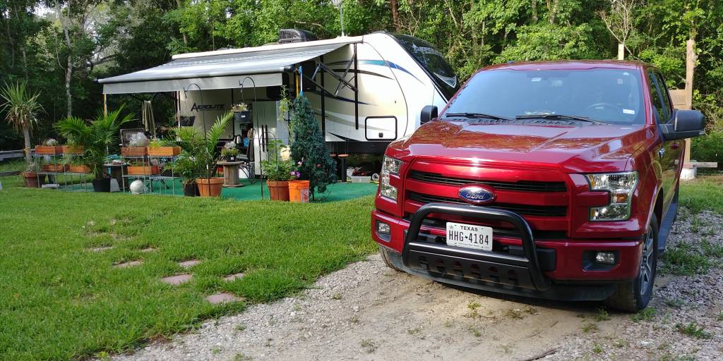

Since a mobile or manufactured home will not work how about a RV trailer? They are easy to find used for a decent price. If it's in good shape and you keep it up chances are you can get some of your money back. I don't know about the laws where you are, some states don't allow people to live in RVs year round while other states could care less about if you register them as long as you don't drive on the road.
/ Mobile home #39
This is exactly what we did when we upgraded from a '82 mobile home to a '03 mfg. home. We just tapped into existing septic,water,and electric and lived right on site while everything was being done. There were inspectors in and out all the time and never a word was said. We sold the travel trailer for what we had into it when we were done. We also rented a storage pod that we kept on site and that was the only extra expense we had.
All in all it was a good experience and I'd do it again in a heartbeat if the need came up.
