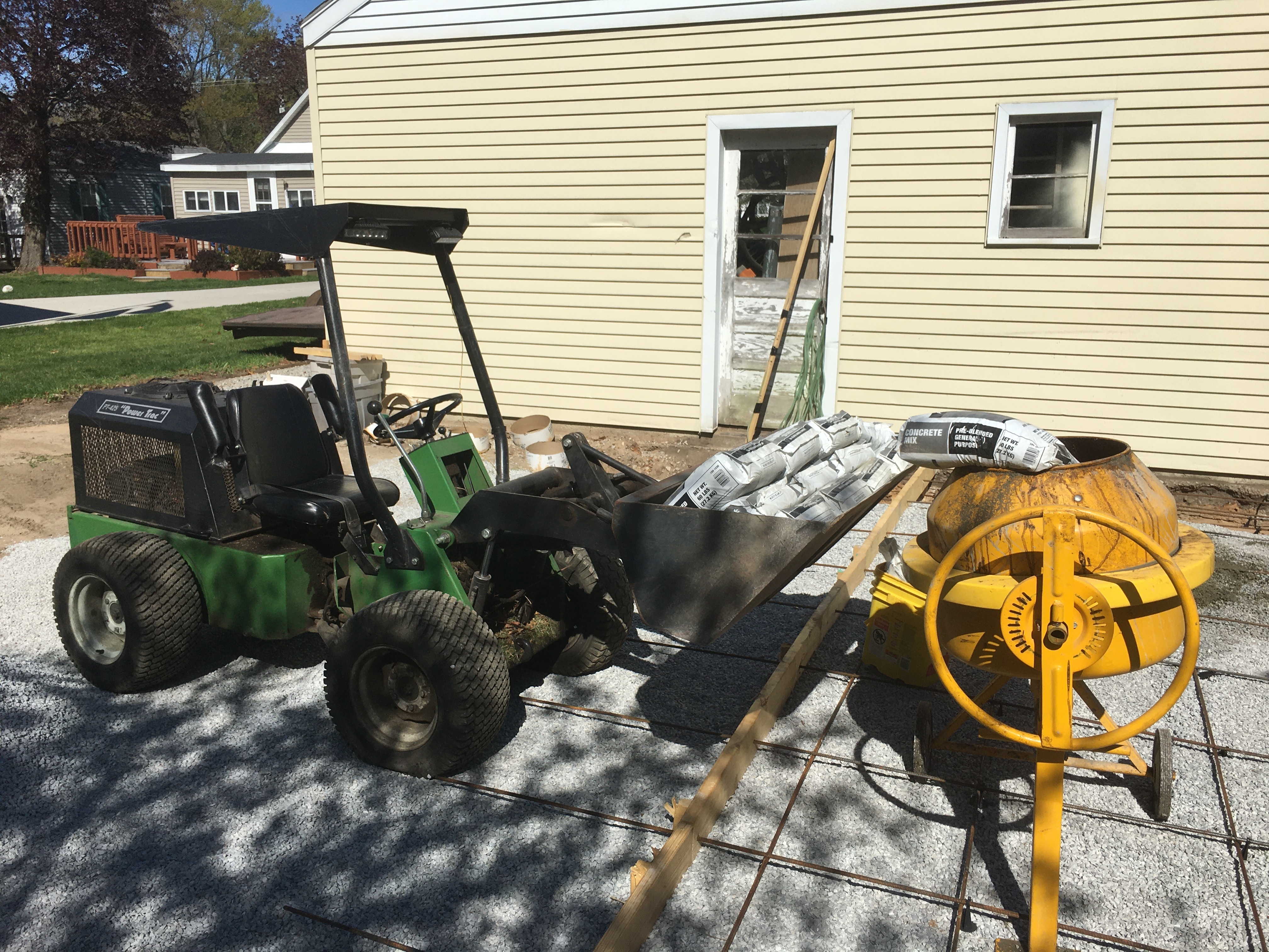

The only thing I'd change on it is larger tires for easier rolling. Even with that, I was able to roll up and mix right over each footing. No shoveling required.
Tractor to lift the bags is pretty handy....
