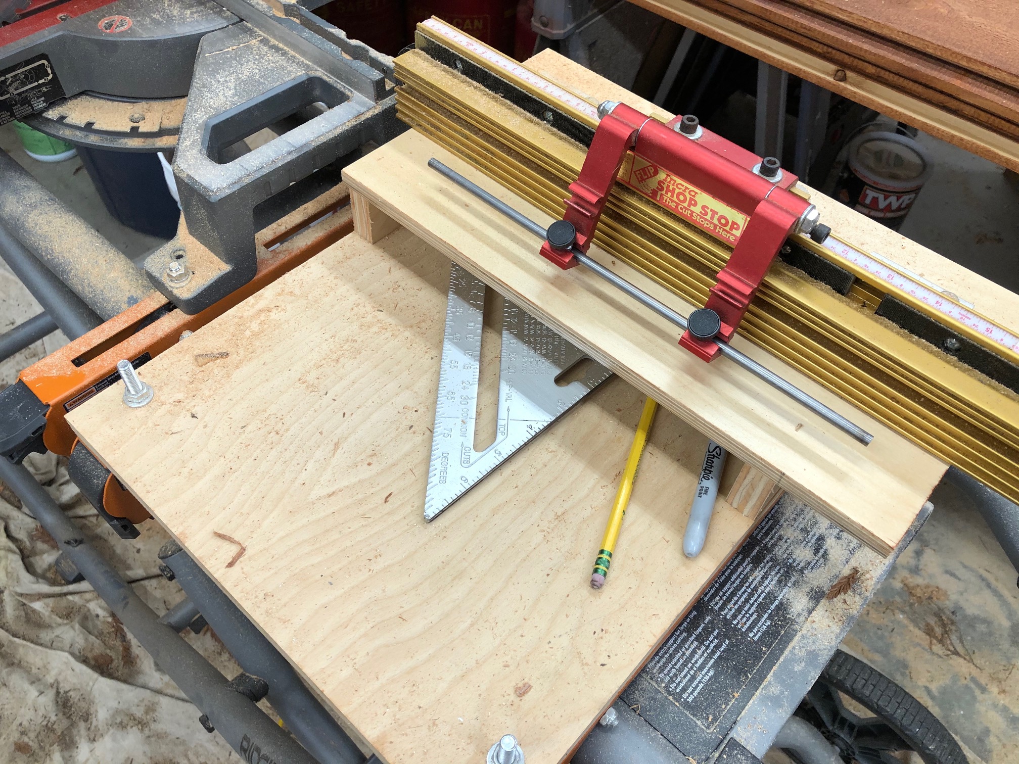

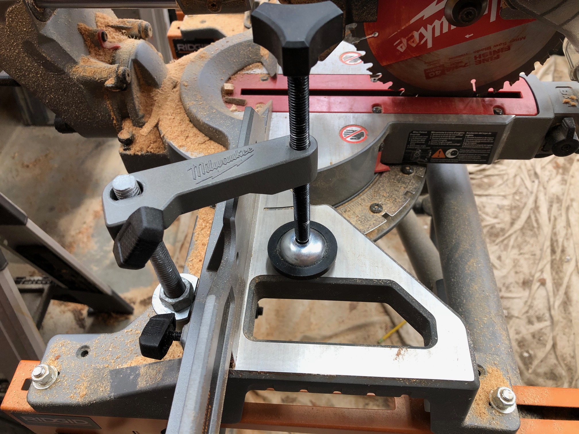

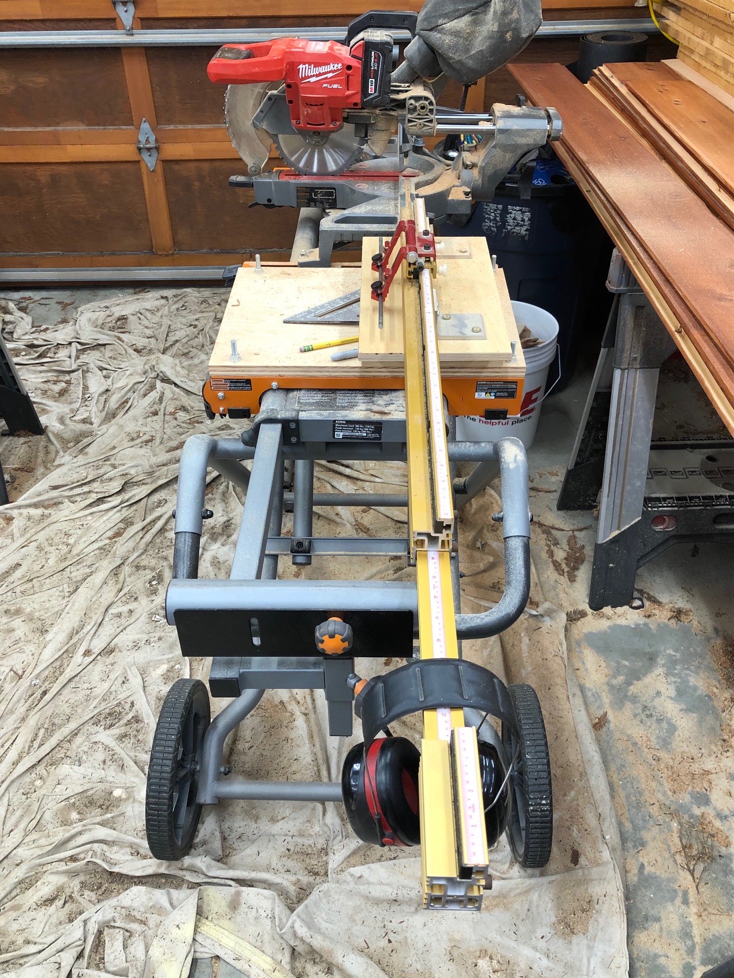

I added a Incra cross cut gauge to my miter saw and stand. I can do fast and perfect repeat cuts up to 70". If you dont have room for a table this can be handy. Also think about the clamp. 99% of the time it is not needed. But for instance doing perfect bevel cuts on floppy 8" siding you need to hold the wood flat and tight. The standard clamps on every saw I have seen are all the same and clunky to the point of useless. Festool makes a nice quick release clamp for $90. But you can get the same functionality with a 1/2" bolt.

Downsizingnow48, how do you like your stand for your miter box?
