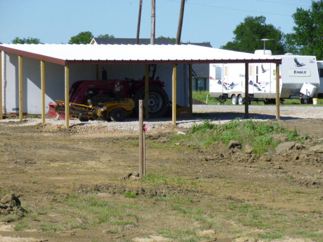

The tractor set the height of the opening and I don't want to put doors on shed.. I am looking for a cost effective method of minimizing the rain that blows in (and we get a lot of it). I have seen the heavy hanging fingers of what looks like leather or rubber in industrial buildings that you can drive thru but I can't find the right search terms to locate them. Anyone found a good solution?

Build a larger eve/overhang?
   / Minimize rain blowing into open tractor shed #6
What size is the shed, and would it be possible to pick the whole thing up and rotate it so the opening is on the leeward side of prevailing winds? I have a 12 x 36 shed, one side open, nothing ever gets wet inside. The north is the high/open side - our prevailing winds all come from south - south-east except for a week or two in spring... Steve

Attached is picture. Will look at suggestions and see if I can find good fit. Shed is 28X30 and on the 30 ft side I will install clear siding I already use on a carport.

Just adding sides would do it :)

With sides i won't be able to drive thru it. Attached is better picture. This is and far side is what I am trying to not stop but minimize rain blow thru but still be able to drive thru. TractorShed 5-21-2013 (6).JPG

We used "strip curtains" on our freezer doors '' The forklift can drive through the strips , yet not lose as much cold when the door is open..We used them in a factory to block welding flash .. Maybe try something like that, might be able to buy used ones cheaply.
