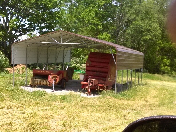

I have 3 of these sheds in different sizes to store balers and tractors. They cost between $2000 and $3500. The one in the phot is 24'x30' with 10' interior clearance. Get a pad prepped and they will come and install it in a few hours.
I suggest you install your own corner anchors, augers concrete and chains. Mine survived a severe storm with 90MPH winds. Google "carports" the RV people use a lot of them. Most companies will enclose them too. Much more useful than shipping container.
