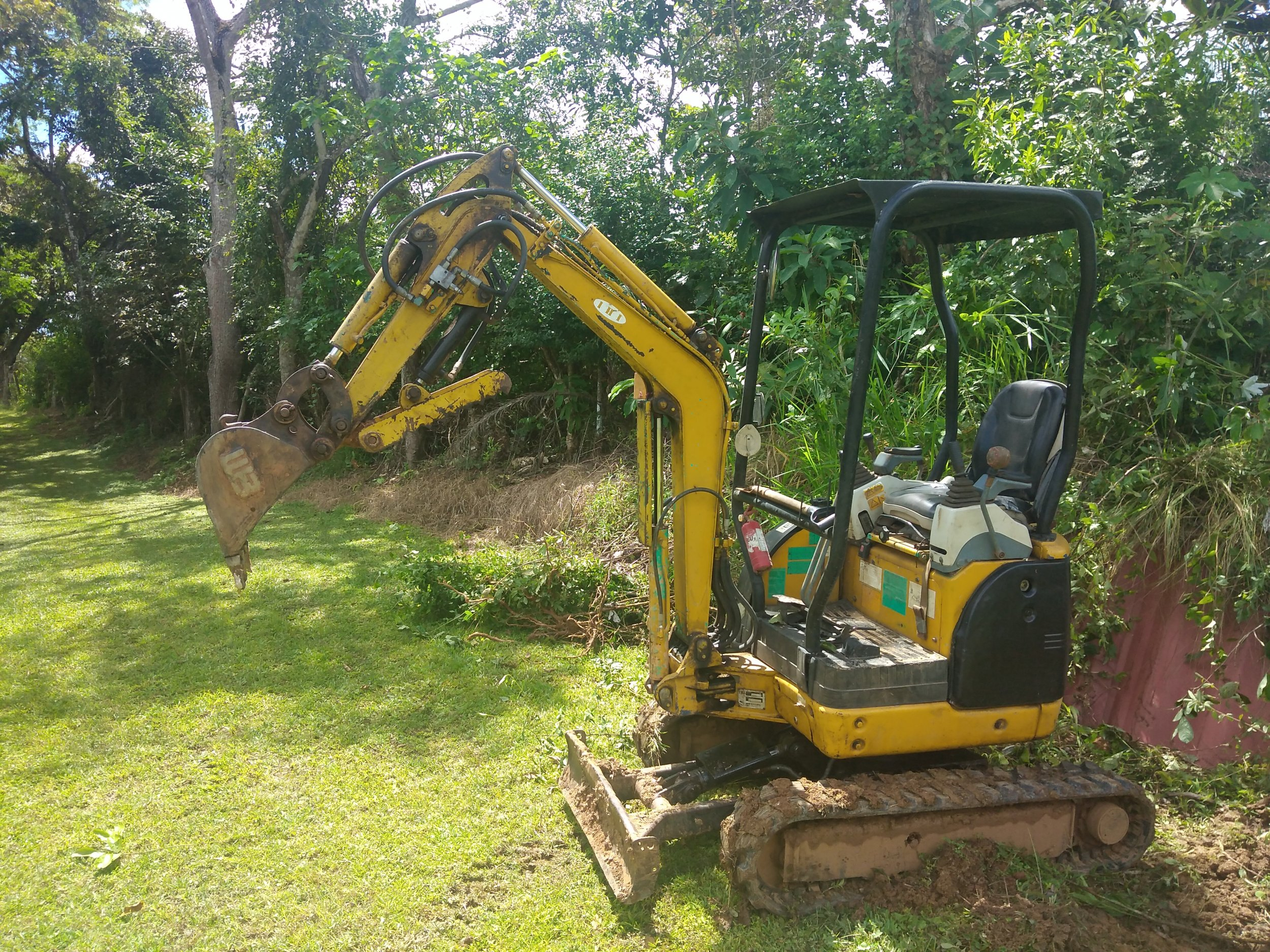

I've got 20 acres of timbered property on a mountain in Northern Idaho. I also have 1,000 feet of steep road that I have to maintain. I've been using a Mahindra 2015 for the past several years to log and maintain the road among other things. I've always felt this tractor was about 15hp shy of what I needed for size, power and options for what I'm doing. My long term plan was to get a 30hp tractor with a cab for the winter months.. Lately I've been talking to friends who suggested I consider a mini excavator and keep my old tractor. Thoughts? How well can a 6-way blade on a mini move snow and maintain a road? How well can a mini do at pulling logs off a hill?
Wrong machine. I own a IHI 15NX here in panama and with the thumb I put on it it is great machine. I can pick up a 24 inch dia rock and also great for trees but it would suck as a plow.
