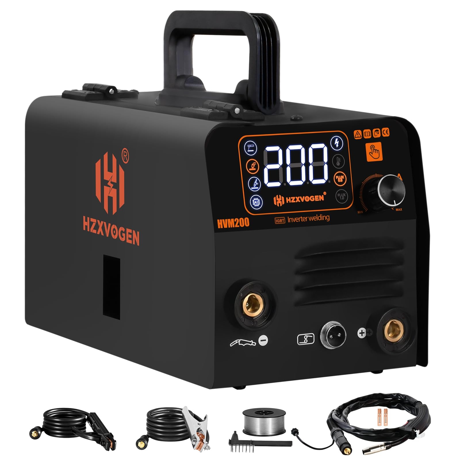

Soooo, I finally got to try your suggestions to help me with my un-pronouncible welder.
It's not in the manual, so apparently we're born with the knowledge, that I didn't get in my dna.
You must pull the wire feed trigger to make it work.
Thanks for the help all (he said embarrassingly).
/ MIG Welder for Beginner/Light Use #108
By the way, even though I can never tell anyone what brand of welder it is because I can't pronounce the name, it works pretty slick.
And that's without a chance to practice yet. My 3 small test beads were better than my best when I first
learned 40ish years ago.
