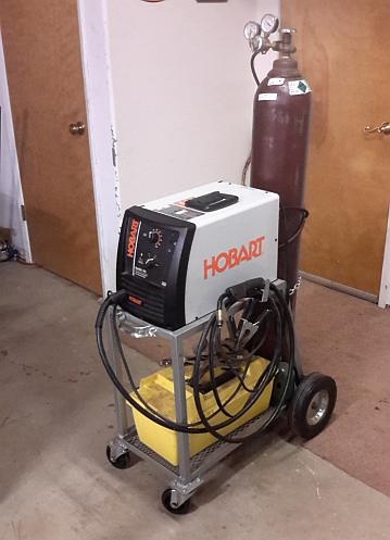

Personally I prefer American made (or maybe assemble) HOBART welder, I have a Hobart Handler 140 .... It is a 120 Volt machine with 5 preset heats, and will run either shield gas (solid wire) or fluxcore wire..... Will weld up to 1/4 inch material at top heats with ease....The only thing I found is to use top heat the requirement ( by documentation) for a 20 amp circuit to be false, I did my home work and found that it require at about 25 amps to run at top heat, so to keep from tripping breaker I upped my welders AC supply circuit to a 30 AMP.... About 10 years now and don't remember how many rolls of wire through it and still happy with it....
I actually have 2 Hobart Handlers, both on shielding gas and both mine are 210's Both are of course heavy because they are transformer machines and Hobart has also succumbed to the Chinese components and not just their welders but everything. Just bought a new Hobart electronic hood and it was Chinese as well.
The 210's will just barely do spray arc transfer. Gotta be wide open. Never found the circuit breaker on either of them and I tend to run them extremely hard
