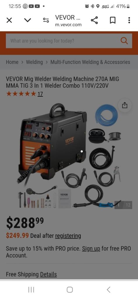

Let's take the Titanium Unlumited 140. It's 110v only, $599.99, and is less powerful, double the price, then a lot of the Vevor/Yeswelder/others, all with only a 90 day warranty.

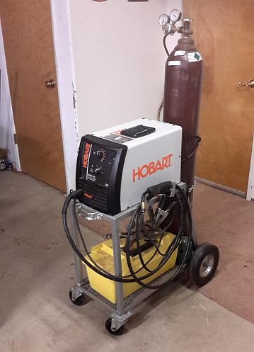

Not any more, back then maybe, not now. Miller and Lincoln use 'cheap Chinese' parts today and Hobart is almost 100% offshore built. If you doubt me, take the cover off a new Lincoln or Miller and look for yourself. I like domestic made products just like everyone else but it's not gonna happen with welders today, especially with the IGBT technology. Go read the reviews on the HF website, one thing about HF reviews, they publish the good and the bad unlike Amazon...lol
Why I keep the pair of older Hobart MIG machines I have because they were built in Troy, Ohio from domestic components and are transformer machines and so is my Lincoln Ranger engine drive. In reality, I prefer a transformer machine over an IGBT machine as the arc is smoother and the duty cycle longer but those machines are no longer made today, sadly.
If I was the OP and wanted a good and capable MIG welder, I'd be perusing FB Marketplace or Craigslist for a used Hobart Handler, they are out there but you have to look. Any of the older Hobart Handlers are good smooth transformer machines. I believe the lower output Handlers are 110 volt, not sure however and in my case, I'd never purchase a 110 volt machine in the first place simply because of the limited output amperage. I'd say my Handler 210 has the best wet out of any machine I've ever used and it's very forgiving as well.
Like I said, I'd never part with the 2 I have.
When I'm building my motorcycle stands that I sell, I run either one of the 210's almost continuously, all day and at high amperage and they never complain at all.
I'll jig up numerous stands and start welding and I don't stop until all are done and I usually weld up 20 at a time, all heavy gage rectangular steel tubing and plasma cut 3/16" uprights.
