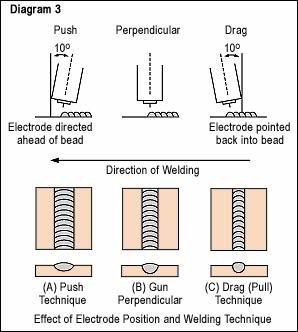

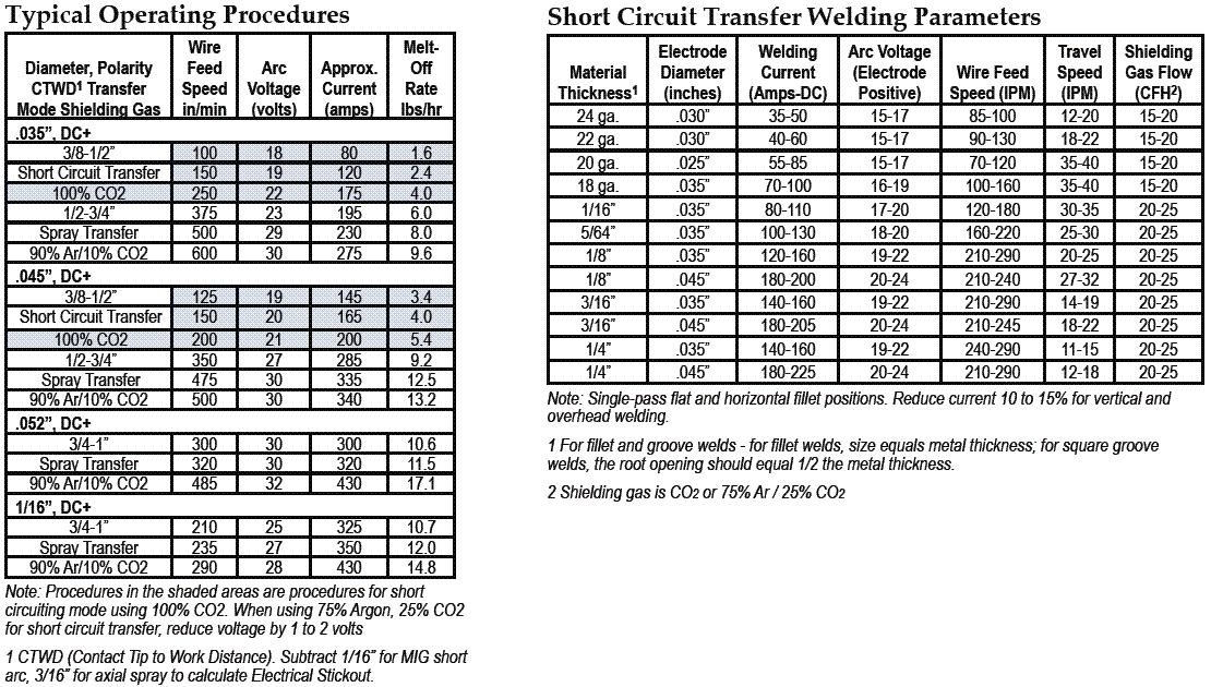

/ ??? Mig Amps and Wire speed #5
/ ??? Mig Amps and Wire speed #6
Wire speed and amps vary depending upon the wire size and type you are using. It's not one size fits all.
/ ??? Mig Amps and Wire speed #7
You just need practice. There's no 1 knob here other knob here all the time it depends on position and the other things mentioned by the poster above.

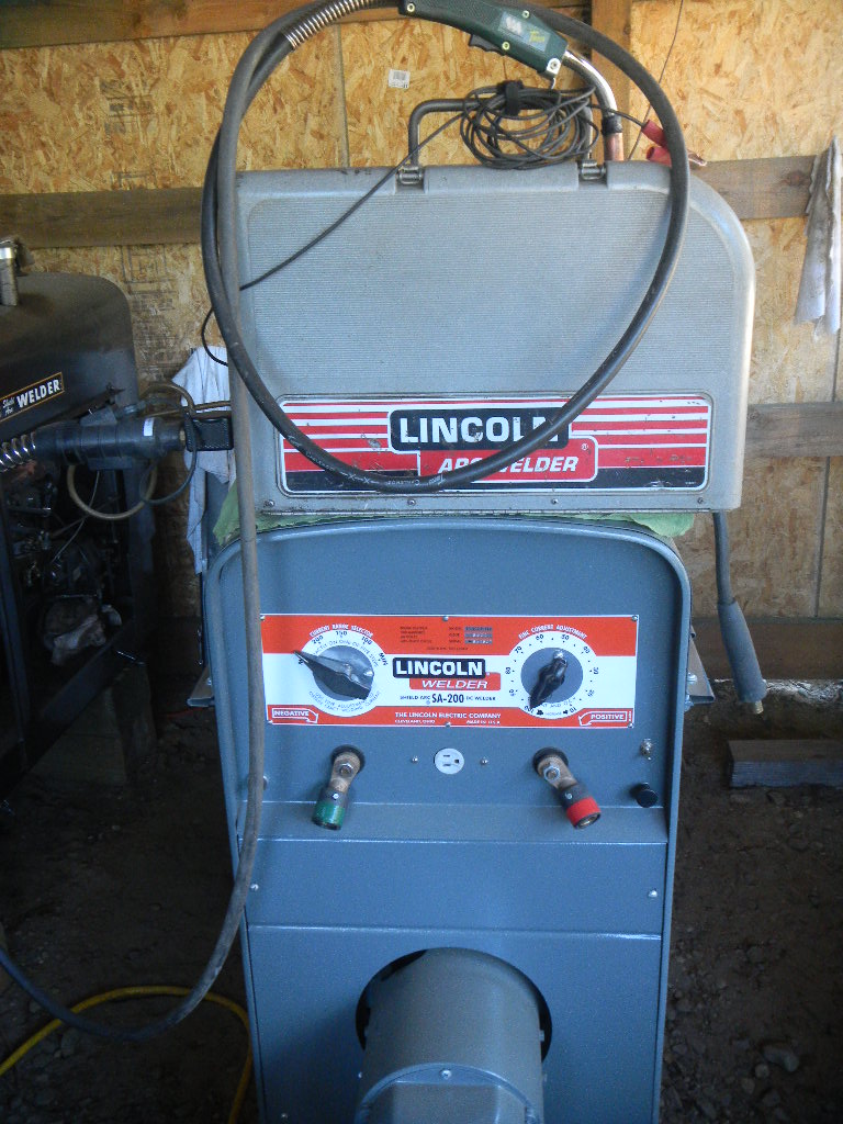

P.S. Shield Arc , Don't know if any are for sell , but I Know of 6 of those Grey SA200's ( ????? Look like pictures you have posted but not sure about actual name for them ) sitting around here locally . 5 are just a few doors down from were I park my trailer on weekends and the 6th is next door to my Dad's , just sitting next to a old shop building . Should I try to make a offer ? No idea if any run , but ???
/ ??? Mig Amps and Wire speed #9
Well thank you Fred for thinking of me!:thumbsup: I have 5 of them now, and I'm trying very hard to curve my addiction.:eek: If I get anymore I'd have to build a bigger shed to store them in.:laughing:
