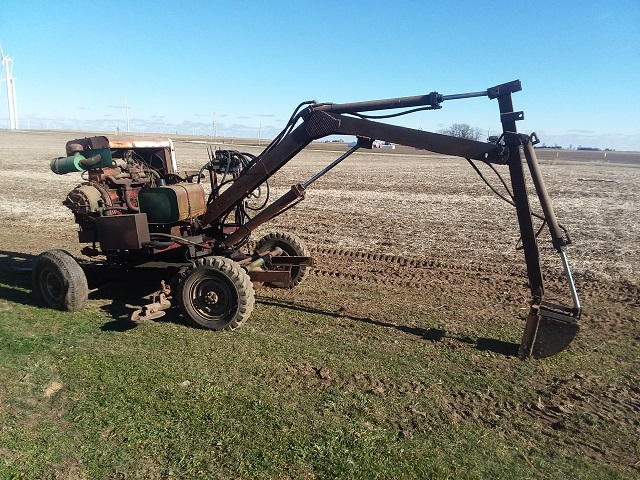

Wish it was that easy around here!lol! we have to put water lines a min. of 42 to 48 inches deep! I put in a couple runs for a neighbor and we decided on 60 inches because 48 was freezing up at his place.
used my homemade excavator to do the job.
Too cool man
