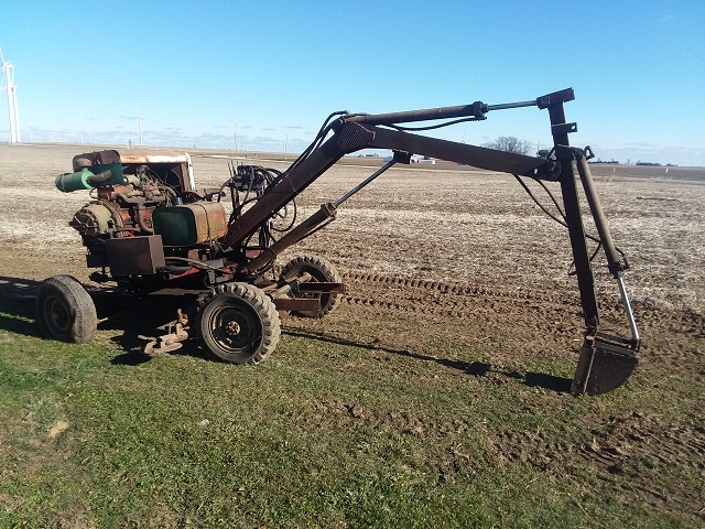

Wish it was that easy around here!lol! we have to put water lines a min. of 42 to 48 inches deep! I put in a couple runs for a neighbor and we decided on 60 inches because 48 was freezing up at his place.
used my homemade excavator to do the job.
Too cool man

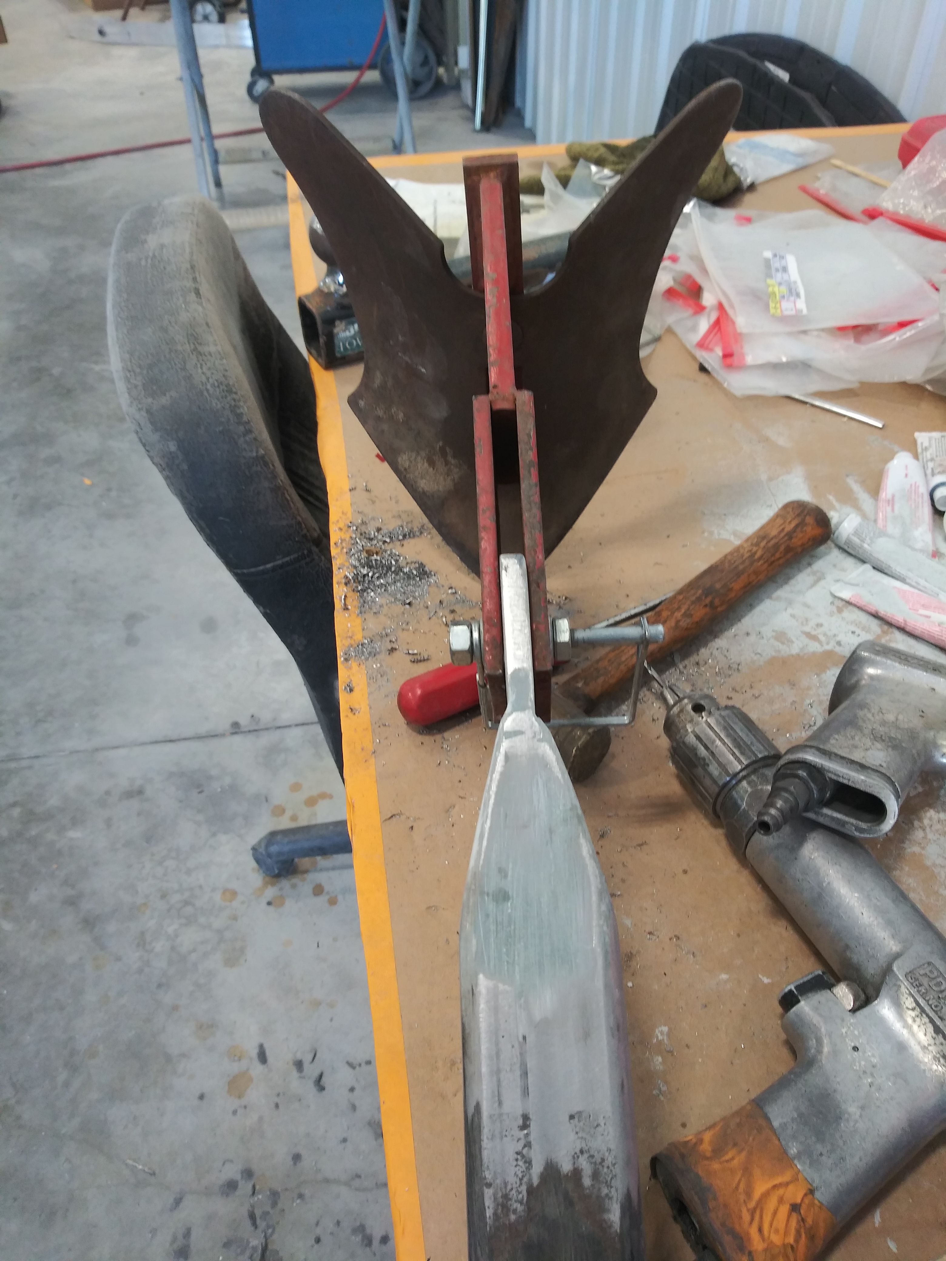

I don't know how well that Troybilt furrower is going to hold up. You have a welder though, and seem to know how to fix what you break. :thumbsup:
Let us know how it works out.
I've made a decent living out of fixing broken things so why should this be any different?
one way or another I'm going to have a good time

I did use this yesterday and it worked great, I need to modify it to go a few inches deeper, I also may want to modify the spade portion so that its wider and dumps the dirt further out and away from the trench ( or I may just purchase a larger spade )
I used for the first time the low gear setting on my B6100 tractor yesterday whilst working this and it is amazing, having little experience with tractors I was amazed at how slow my tractor can go, I literally jumped off the tractor and steered it whilst walking next to the tractor and watching the middle buster perform its duties.
I found it best when I jumped on the back of the 3 point hardware cause an extra 200+ pounds kept the spade deep into the soil instead of having the tendency to ride partially down. I can easily ride on the back of the 3 point and steer the tractor.
Whatever minor roots I encountered were easily torn and ripped, Im sure a major root would stop the tractor but at the speed Im moving I feel it would spin the tires/lose traction before the tractor toppled.
My phone took a dump yesterday, everything on it was lost forever I.E factory reset, Ill take some pict next weekend and post.
Once again this little Kubota B6100 is gonna save me a ton of time and money and potentially back breaking work
