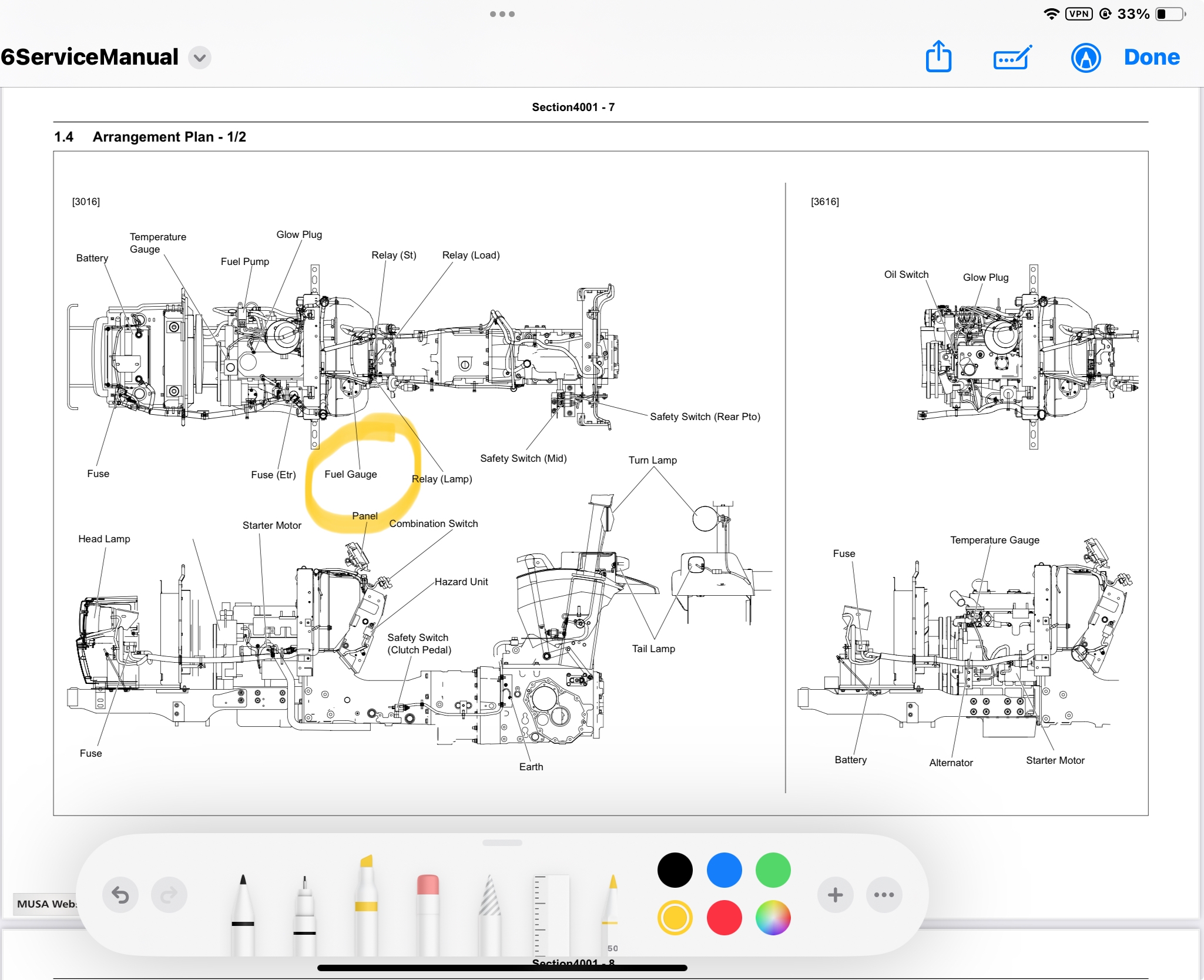

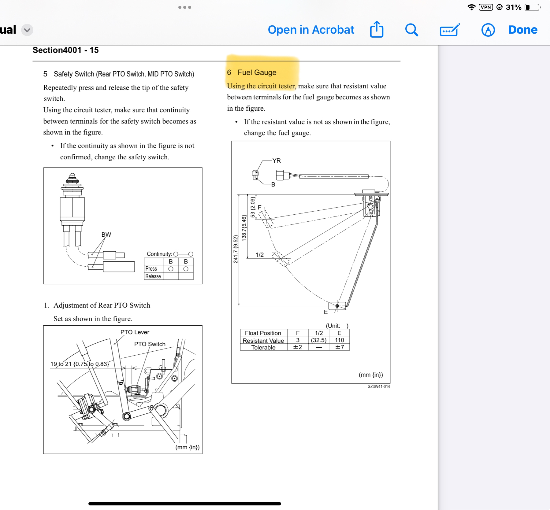

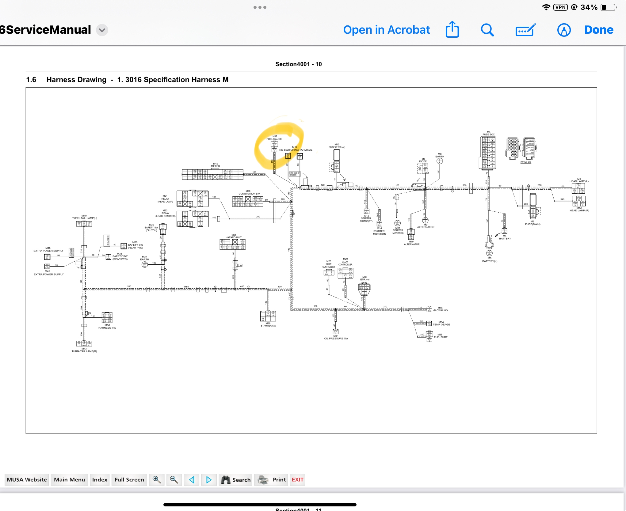

Mahindra 3016
I have a Mahindra 3016 and mice made a nest under my dash and ate wires. I bought a new dash harness and a new fuel sending unit, but I can't seem to locate where the fuel sending unit plugs into. The male and female couplers are there but I can't find where the wires feed into the harness. I also can't seem to find any pictures online with the instrument box removed. The bundled wiring harnesses are fine. The mice seem to like wire insulation and wire but not the loom wrap and tape. Any help would be appreciated.

Here are a couple of pics from the manual (about 8yrs old).
Hope that it points you in the right direction. Cam

/ Mice ate my wires #3
Is the plug within the taped section of the harness?
