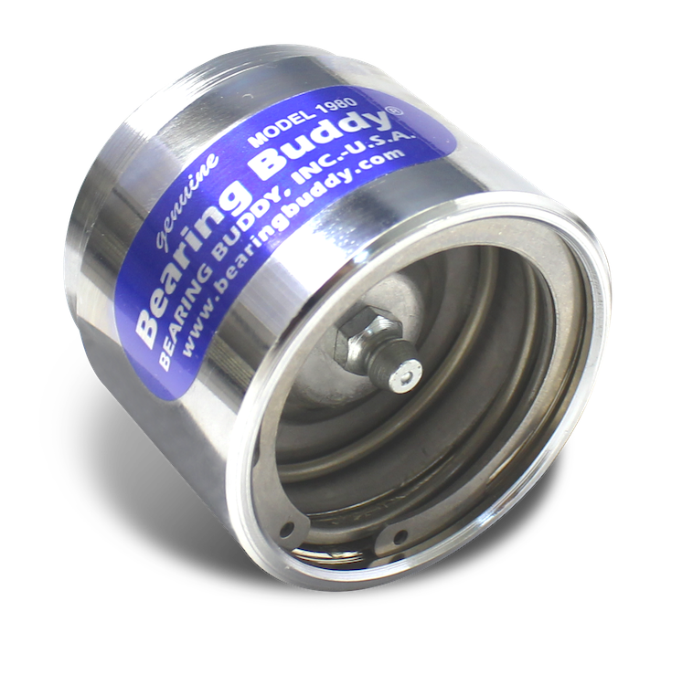

Genuine Bearing Buddy

When I inspected cars in the 1960's, we had to remove those caps to get the drum off to look at the brakes,,
We used a pair of VERY large ChannelLock pliers,,
Grab the cap, press down, rotate the tire 1/4 turn, grab the cap, press down,,
Usually on about the 4th "press down", the cap would come off,, no hammer needed,,

I loosened the cap with a hammer and board and then used the channel locks. I can see by the pictures mine are a generic bearing buddy. Mine isn’t spring loaded.

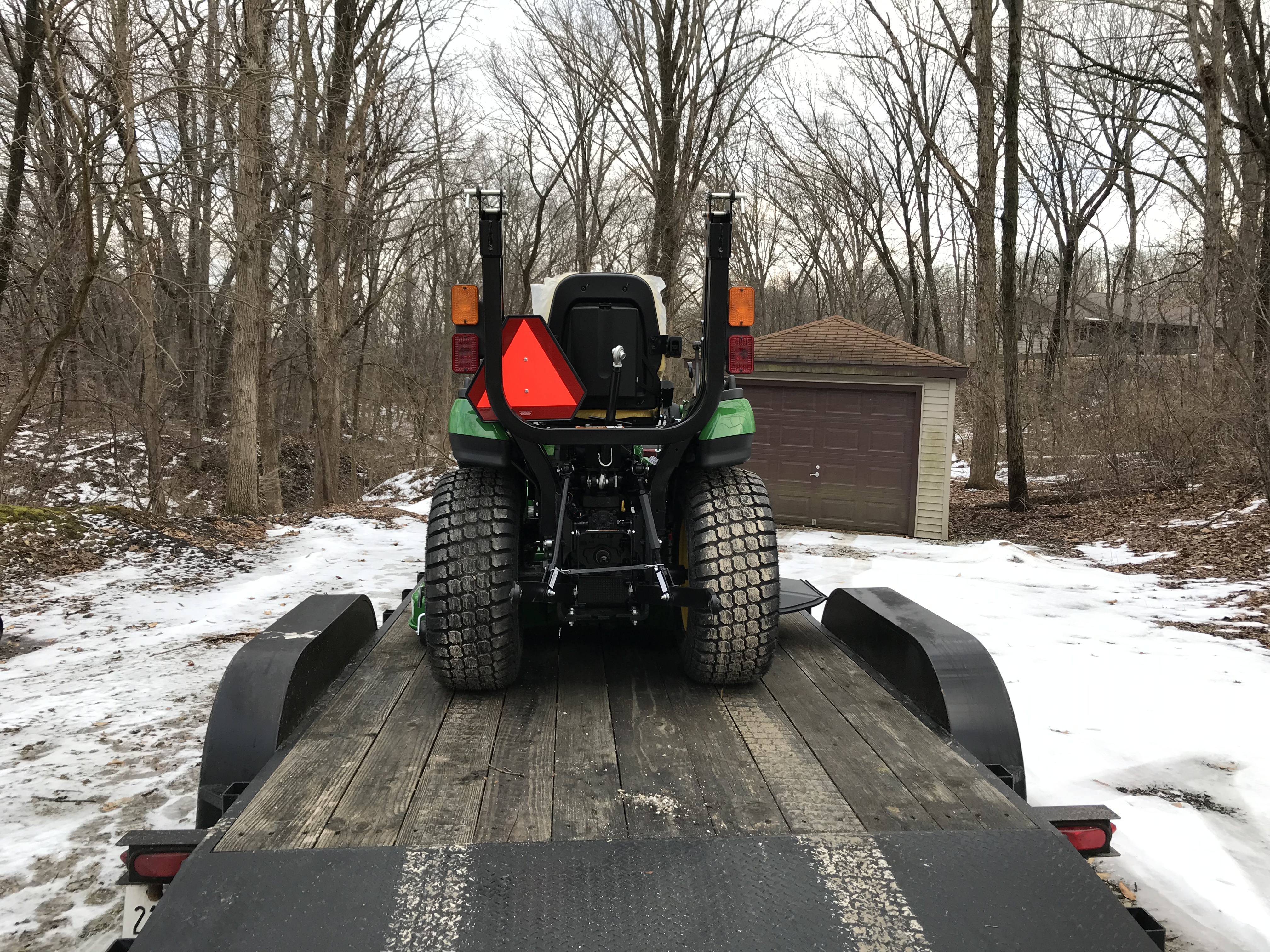

2CB9743C-20C9-47C6-8ED4-DD2AA4A624C4.jpegMine has very similar boxed tail lights. Some how mice were getting in, building nests and eating the wires. I noticed yours has LEDs. I just replaced one of mine with ab LED unit. It cost $21 but should last much longer. All my lighting is sealed units, you can稚 replace the light bulbs, the entire thing pops out. You can kind of see my lights in the pic.

Bearing Buddies are great!
They are an option used on virtually ALL salt water boat trailers, to help protect the wheel bearings from water intrusion.
