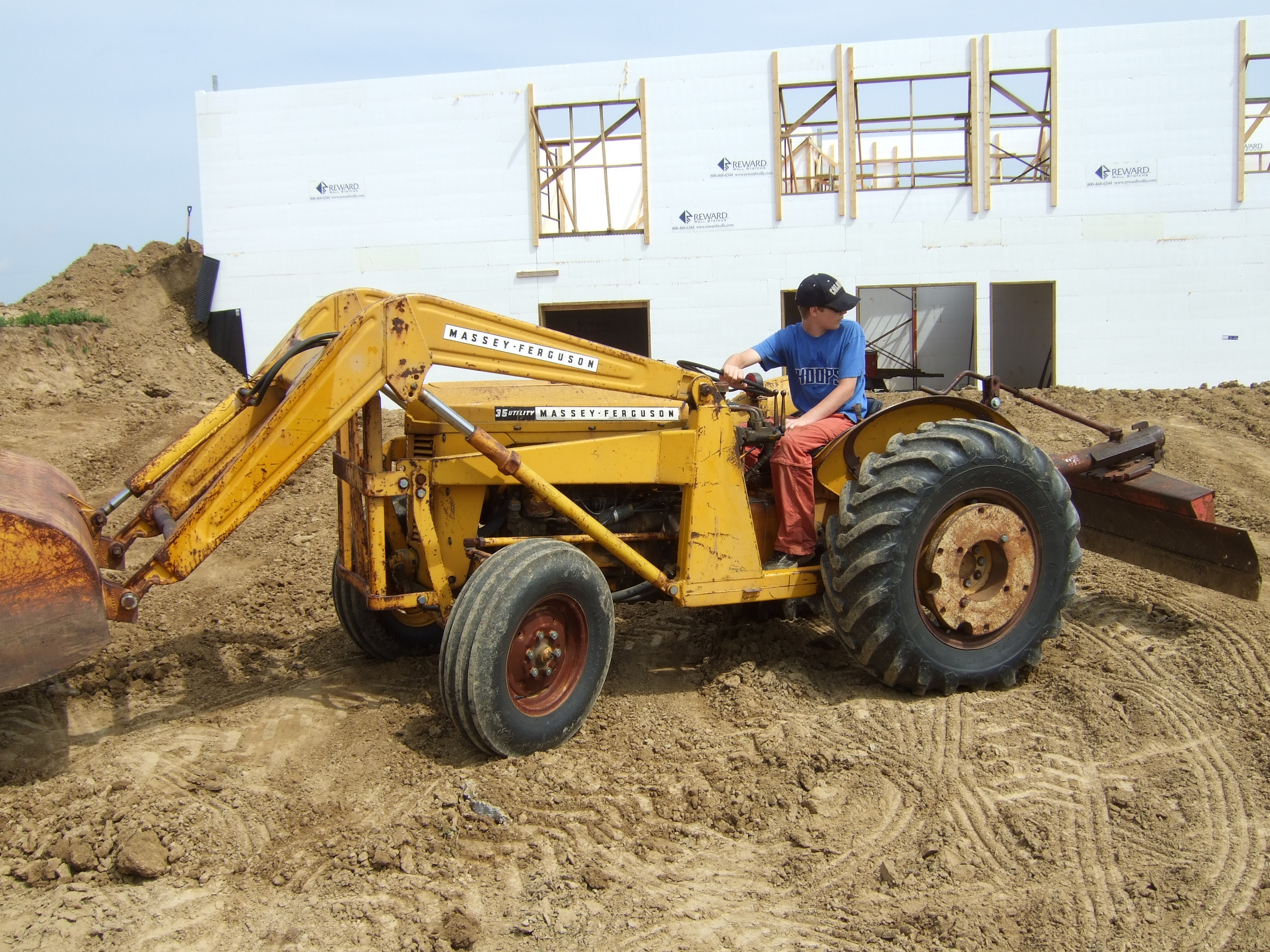

The first is my son grading when we built our house.

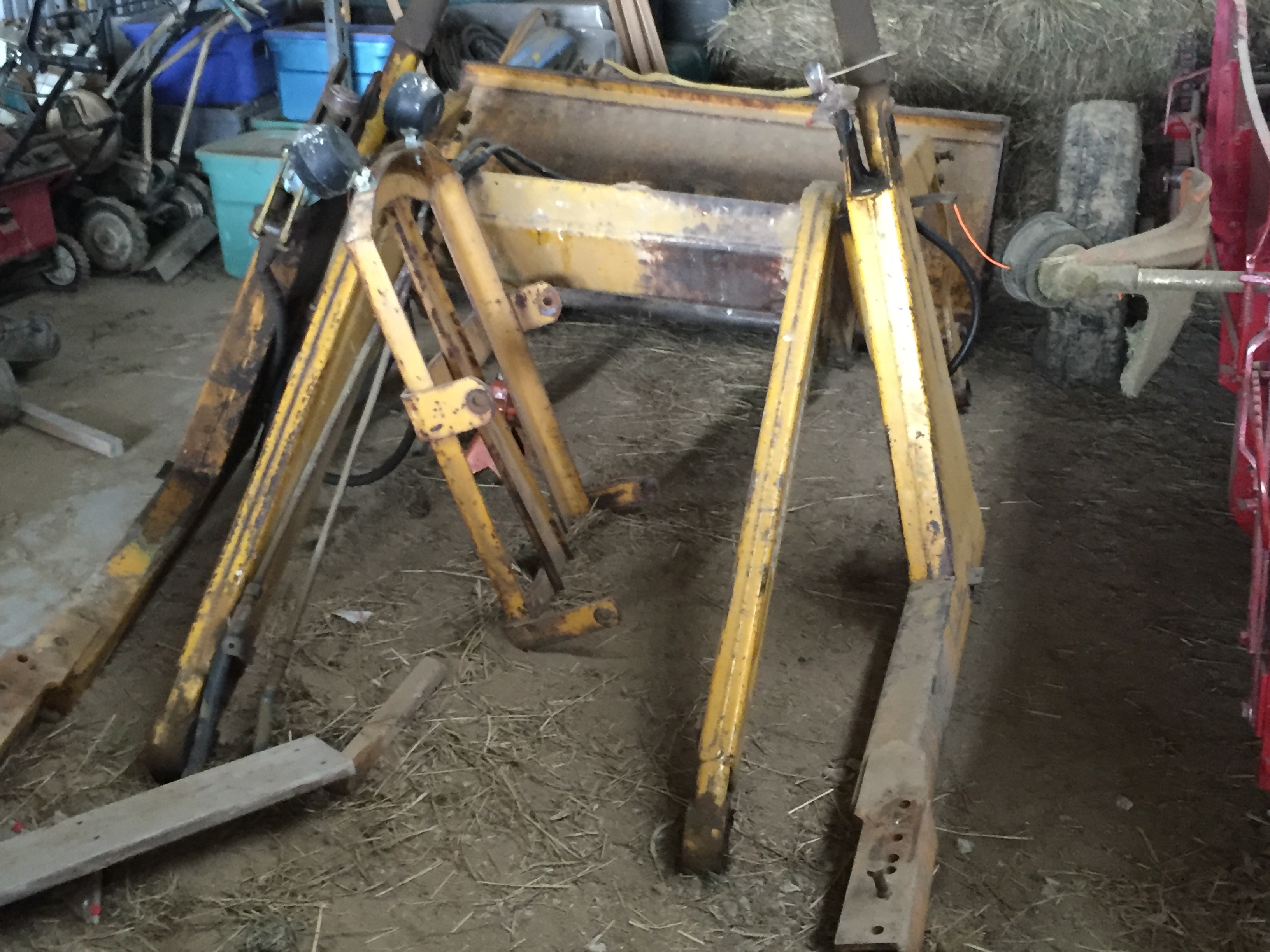

Second show a bale spear I had made. We were test fitting it. It works well but the tractor barely lifts large bales.

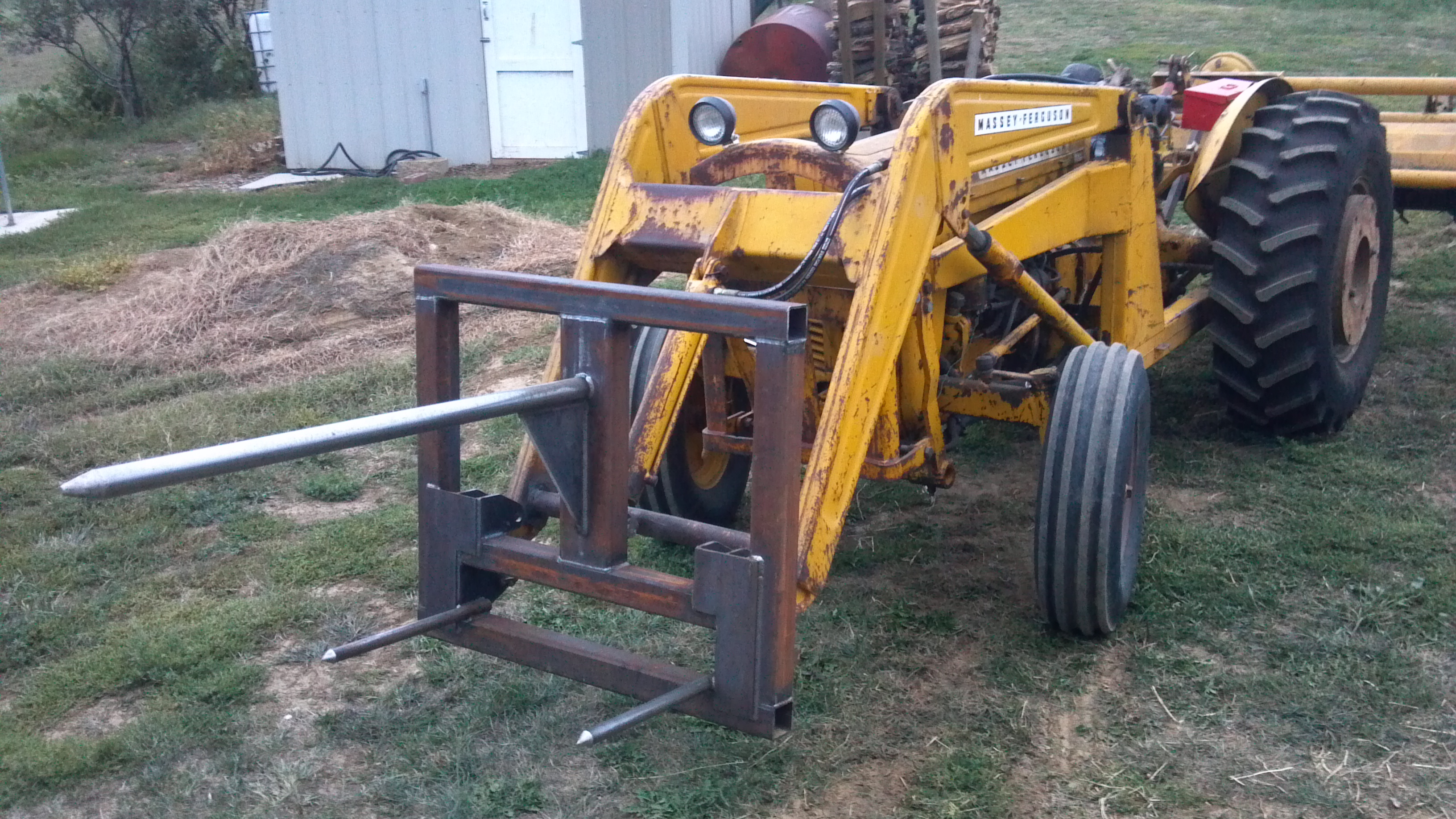

Third is using it for snow removal. I sometimes keep the flail mower on the rear for added traction.

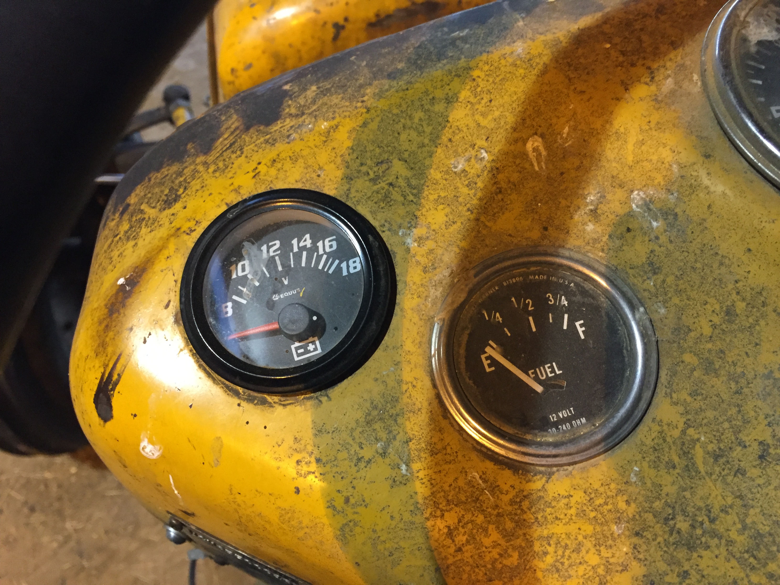

I also replaced the ammeter with a voltmeter. Twice over the years I've had the tractor just stop on me. The first time it was because the ammeter had failed. The second time, a connection at the ammeter had come loose. We were baling hay and had to borrow a tractor to finish before it rained. I had to do some minor rewiring to get the voltmeter to work but I'm happy I did so. Even if it fails, the tractor will still run fine.
