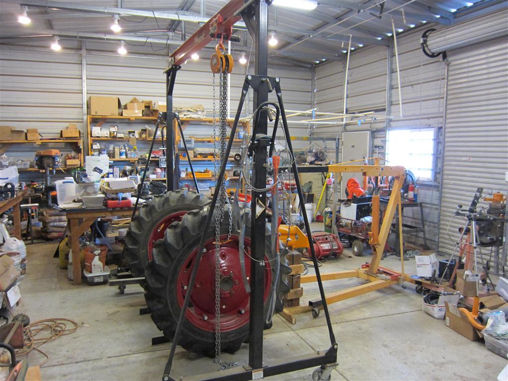

I prefer an easier way. I use my 1-ton gantry crane with chain hoist since I work alone.
It's hard enough for me to roll one of those rear wheels around the shop. Getting them reinstalled
without that gantry would be hazardous to my health.:eek:
BTW: that's the rear end of a 1951 Minneapolis Moline BF tractor that I'm restoring.
Good luck.

GoodMornin Ray,
Gee that gantry crane looks very nifty !!!
Did you get it through Northern, and how much was it if you domt mind me asking ? ;)
I can see how handy that would be for similar jobs, or splitting tractor etc...

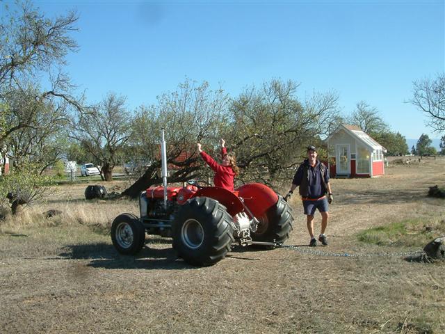

Here are the rears on my 1964 MF135 diesel.
They are BF Goodrich 6 ply 18.4-16A tires (18" wide, 16" dia rim, 40" tall overall) and are loaded with water. My guess is that each weigh at least 350 lb loaded, probably more. Haven't had to remove/replace these yet, but that day may be coming.
My 135 is a field tractor that's been modified to squat low for mowing/discing in the olive orchards around here. The front axle spindles have been shortened to keep the tractor level with that BFG rubber.

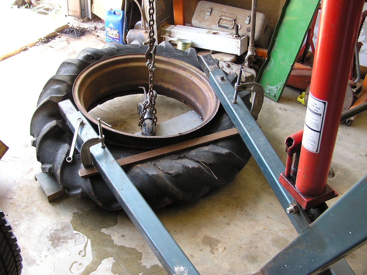

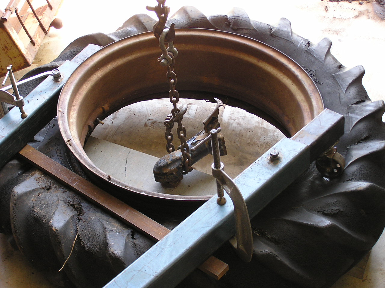

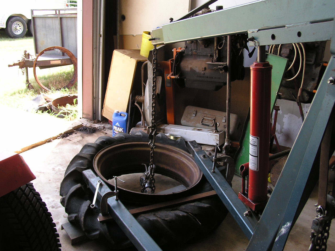

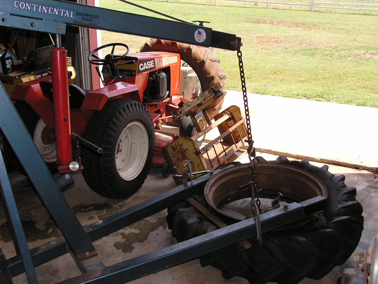

I use the Shop Crane to lift the wheel and move it, same thing I use to break the bead.
/ MF135 REAR WHEEL REMOVAL #16
That's a neat way to put your hydraulics to work.:thumbsup: Good thinking.
Thanks, I wish I'd taken a picture of the setup before I applied pressure, the solid steel bar was up on edge, next to the C clamps, against the bead. It still took a lot of effort on the jack handle! :)
