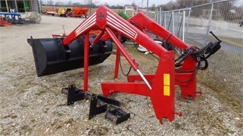

I never really looked at the modern loader frames. I didn't know they made some with no nose bar. The nose bar on my Farm Hand loader would stop that from ever happening. Mine looks like this one, just not as pretty.
Yes the FEL nose bar is not pretty and is sometimes a pain, but it clearly does it's job!
Here's 1986 model with no loader frame support issues so far, and for sure it's been tested to max many times...
