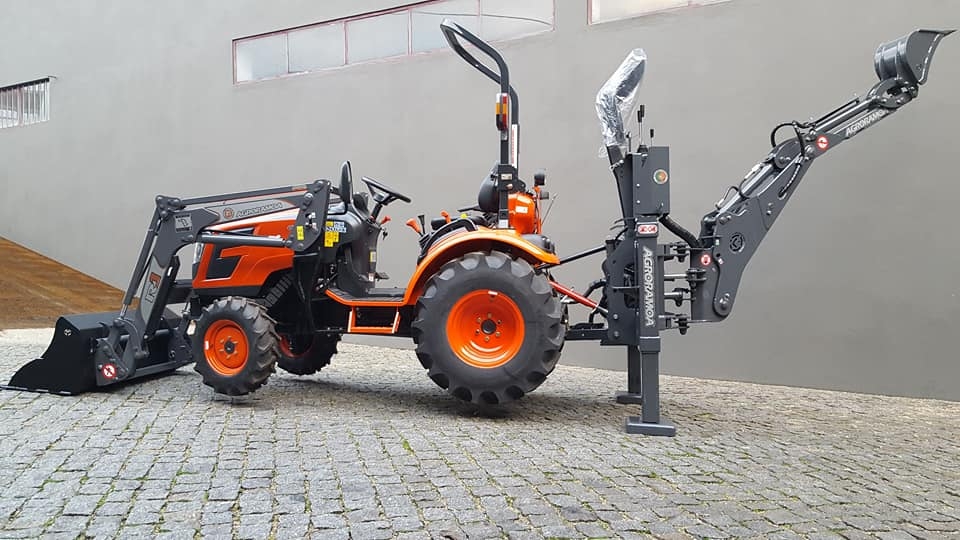

Commercial backhoes are built a little differently than a 3 point hitch mount BH. If the tractor BH has a subframe mount it's all good however, if it's a 3PH mount with no subframe (like the picture shows), the game plan is much different and the chance of casting failure becomes much greater and that is why subframes are supplied with all OEM backhoes today.
Not that I have one because I don't. Did in the past but it's long gone.
Oh okay....I don't know anything about three point hitch backhoes. I would never buy one of those. Mine is subframe mount.

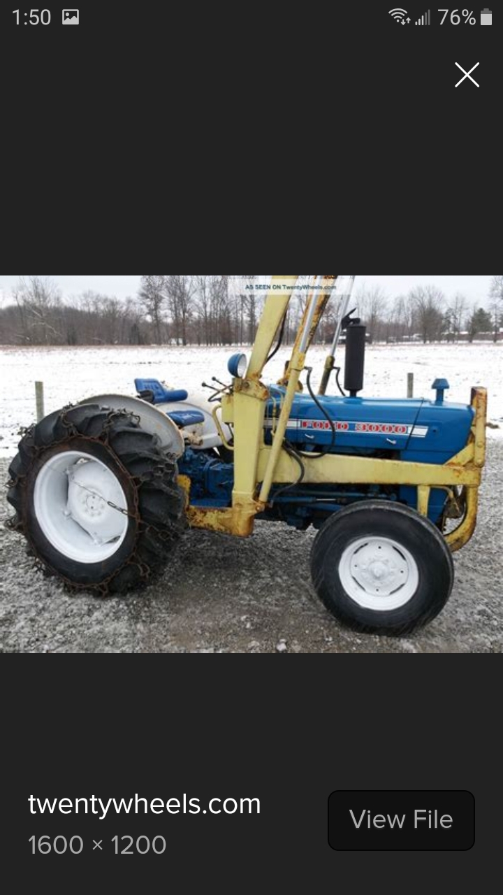

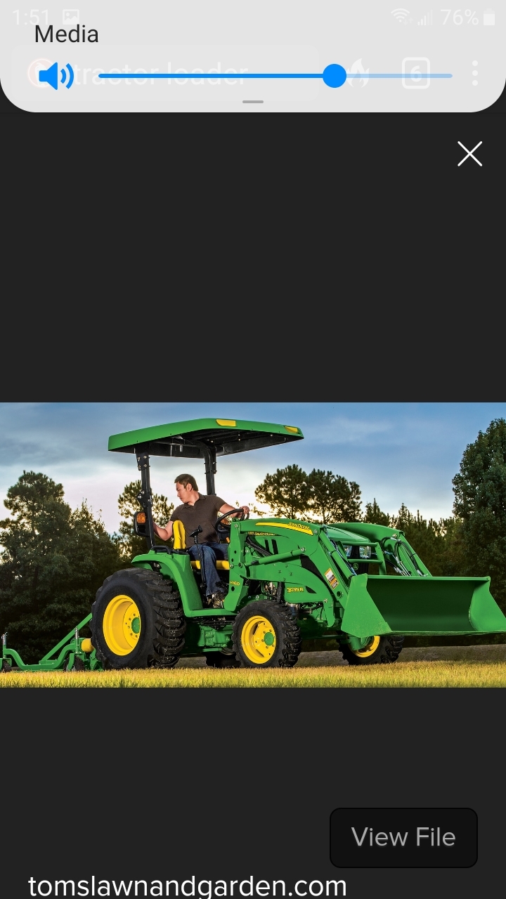

This most recent (last 25 +/- years) breed of detachable loaders has lost the rigid forward support of the loader towers. This is great for engine access and service as there's always a pair of beefy metal components running out to the front with the "old style" but these 2 point mounts really puts the engineers to the test.
Searching for these pictures, it looks like Deere still uses this additional front support on the smaller models, but the Kubota is more typical of what I see on today's tractors.
These bars are down low but have to take the rotational forces to the towers.
This is what I'm calling the old style or design.

No way I would try it with a 3 point mount backhoe on a utility or CUT.
I have a 3pth Woods 750 but will not put it on my Kubota again. I thought that as long as I was careful it wouldn't be a problem, yet there is also a lot of sideways stress and I don't need to replace the rear housing.
