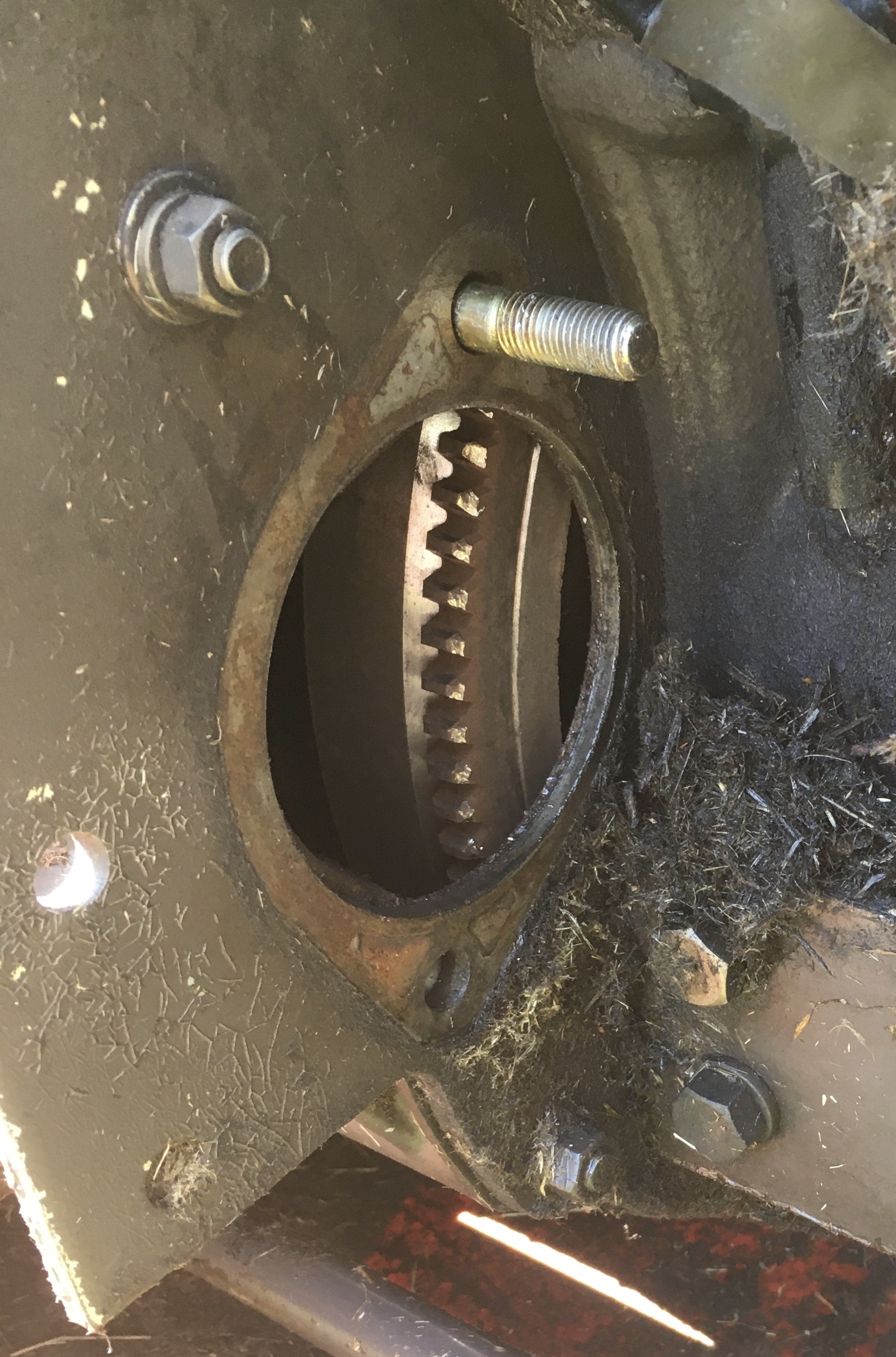

Any tips on getting the old starter out?
Worked for hours today trying to back out the flange bolts a quarter turn at a time. Got the starter to wiggle a little but cant get the bolts out.

Try to remove at least the lower bolt. You could tap it back using a block of wood and a hammer. Then tap it out using a similar sized bolt and light hammer taps. It’s held in place by the just the two bolts but also has the gear against the flywheel. So you need to remove at least one bolt so that you can wiggle it back.
Here’s a pic with the bottom bolt removed (and years of dirt from behind the old starter).
For my replacement starter the flange was thicker but the old bolts were just barely long enough to work.
