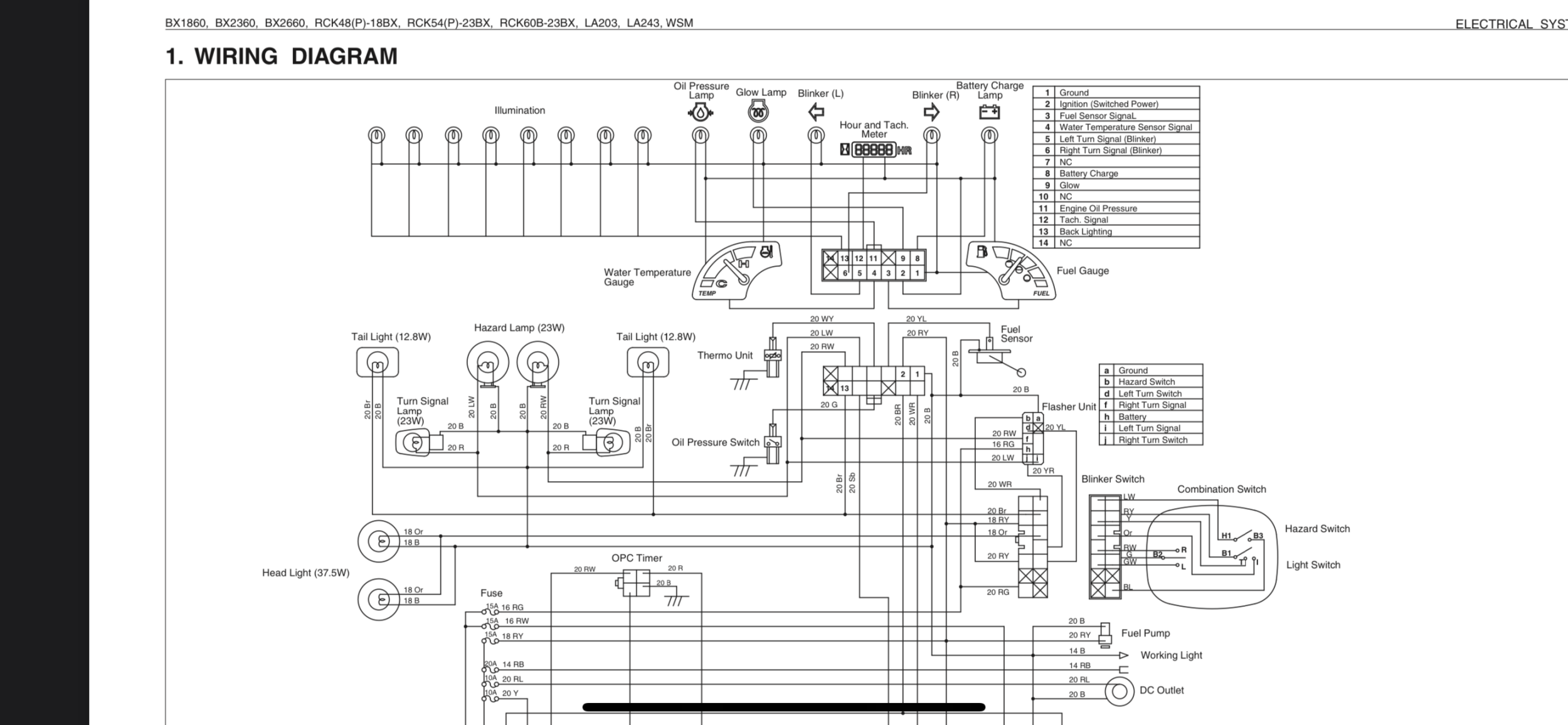

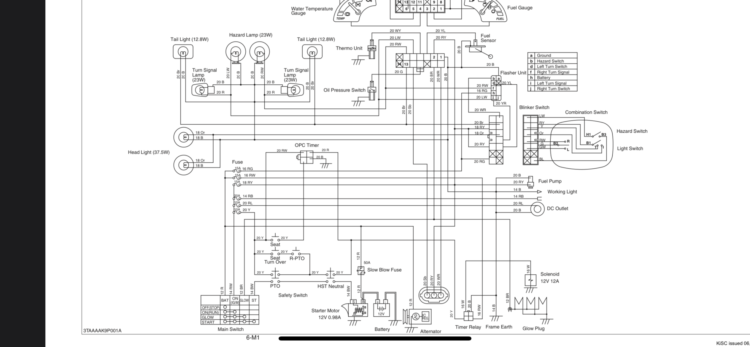

Are the dim lights on the instrument panel the oil pressure switch light and the charging system light? It’s time to whittle down this oak tree. Is there a difference in brightness between turning on the Hazard flashers versus using a turn signal? They’re not on the same circuit (WSM). One is on the battery (RG hot) circuit and the other is on the fuel pump (RY) circuit.
Yes and Yes.... spent hours yesterday working through each circuit.
  1. Battery tested good. Took to Oreilly's (And I yes I did that volt meter on battery while attempting to start prior to taking to Oreilly's)
  2. Battery connections cleaned
  3. Ground connections cleaned (except at starter - but they looked good and not loose). Tested from positive of battery to several grounds on tractor - 12.7 volts
  4. Tested each circuit from switch through fuse - 6-7 volts
  5. Although ignition switch tested good, i.e resistance through the 4 connections depending on key position, when sticking meter probe into back of plug, (to see what the switch is passing). measuring 6-7 volts. One time I got 12 volts.
  6. We believe we have a short in the plug now, I'm guessing because I have attached and removed so many times. No reason that should have loosened over time, or at least find it hard to believe. So may have found the problem, or one of them anyways.
  7. Re: lights above - only light is oil pressure and battery. No hazard lights, although you can hear the relay (sometimes). Fuel pump comes on when the switch is on.
Will give another update after today's work.

And I have these prints too, I'm working through them for sure.
