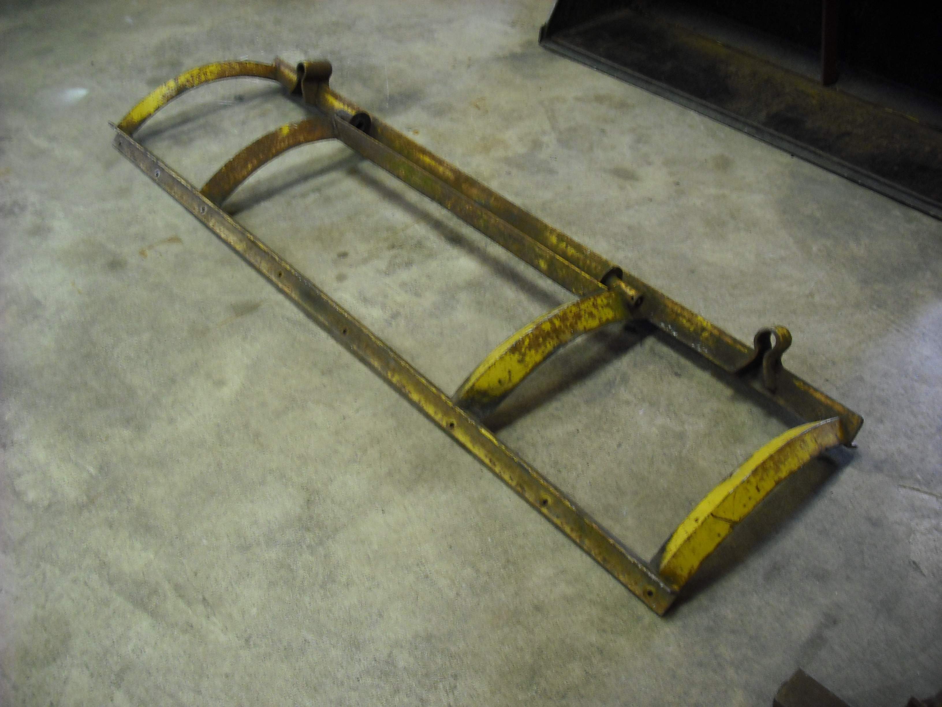

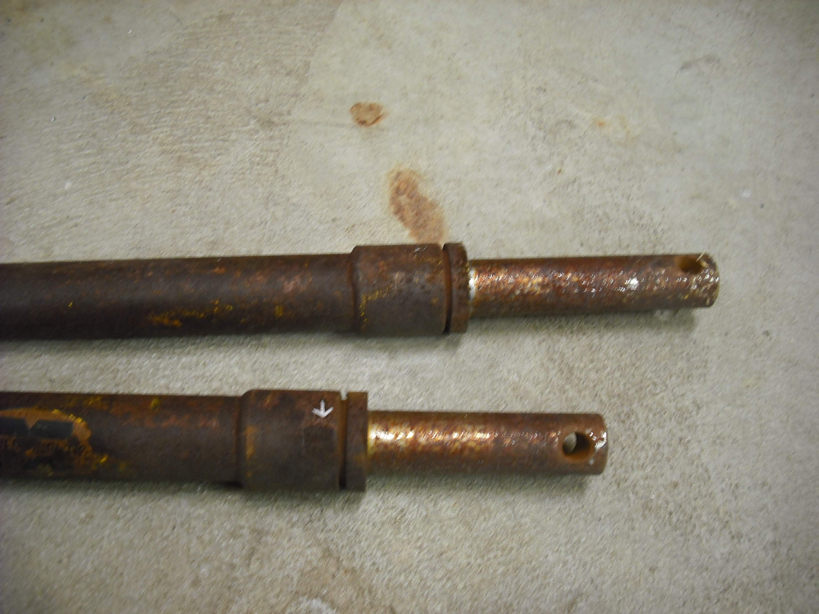

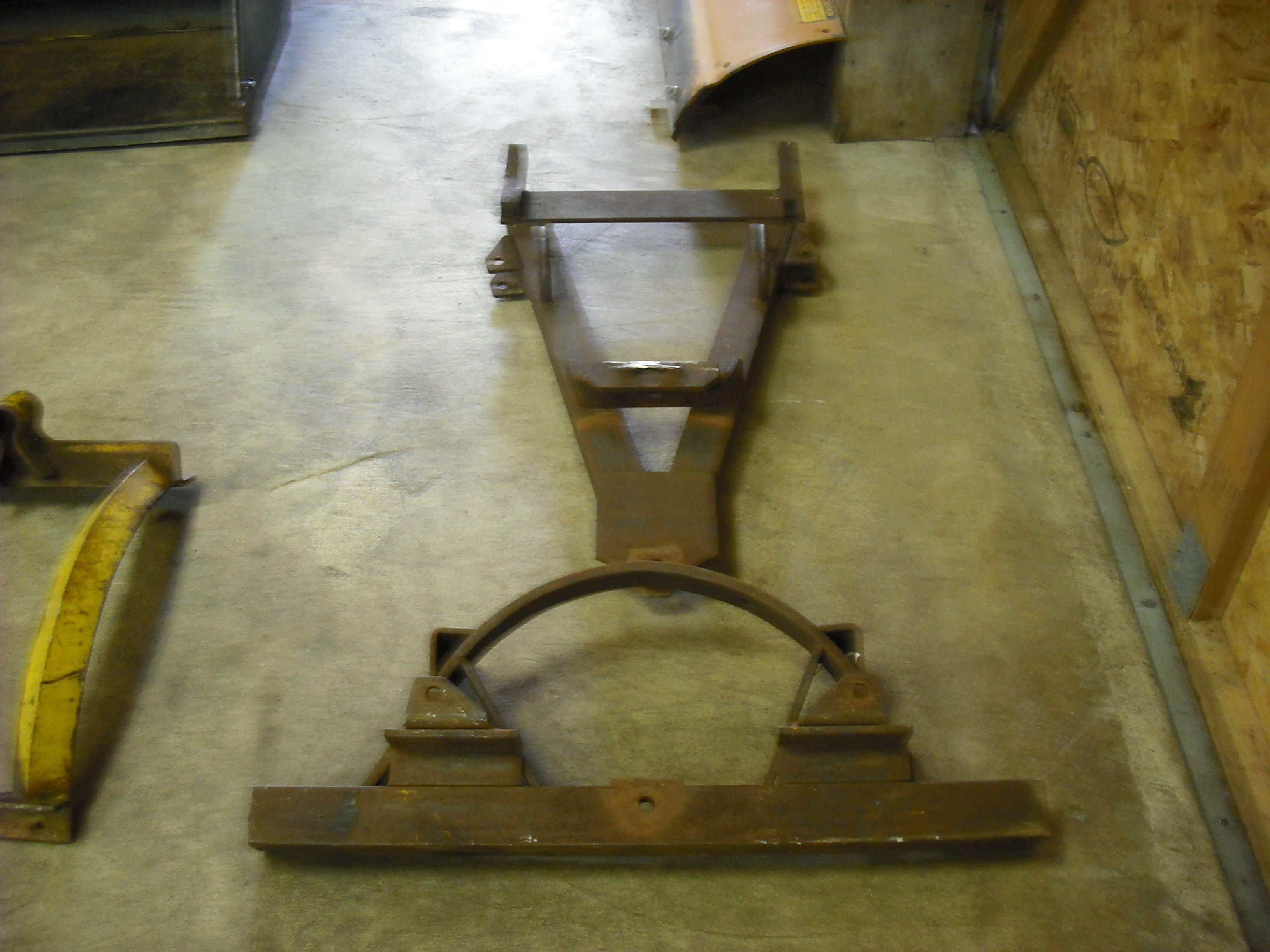

Ok, its been beat to death but here is my setup.
I started off with a old Meyer ST-78 plow I got of CL for $80. The cylinders were rusted and the plow face was rusted through in 2 spots. It was solid other than that, not bent, and had a brand new cutting edge included. Every nut and bolt fought me and many had to be cut off with a cutting wheel or sawz-all.
Here are a few pictures.

After cutting all the bolts and removing the plow face it was off to the sandblasters. I also made a shopping list and hit the internet, TSC, and my local hardware store.
I spent $100 on the sandblasting and another $30 on bolts and paint.
I also got new plow shoes ordered, plow markers, and trip pins for $80.

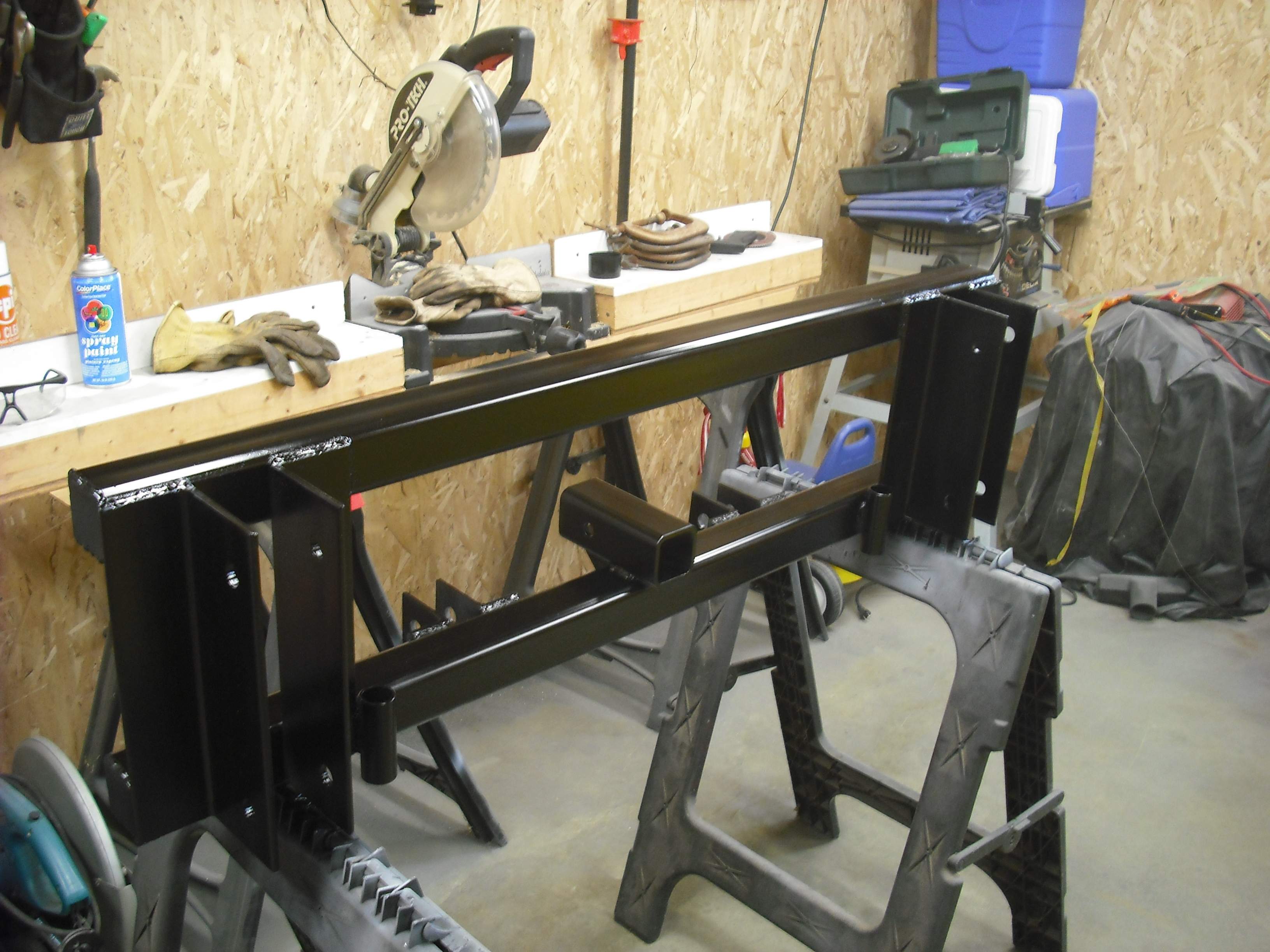

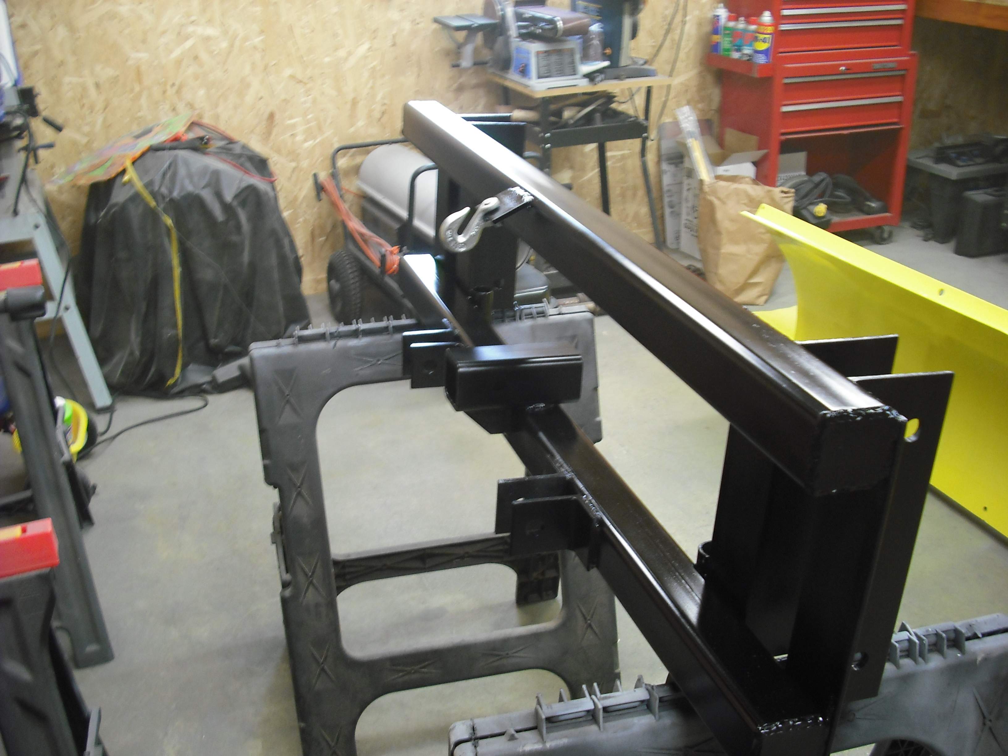

I then had to order the steel for the mount and new face. I had them make the face out of 11ga steel and they put the roll in it per my templet I supplied. For the FEL to plow adapter I use 1/4" stock and did the additions of putting on a 2" hitch receiver tube and tubes to accept another set of plow shoes if I feel they are needed later on. I have $140 in all the steel.
At this point I am into it about 10 hours of labor and $430

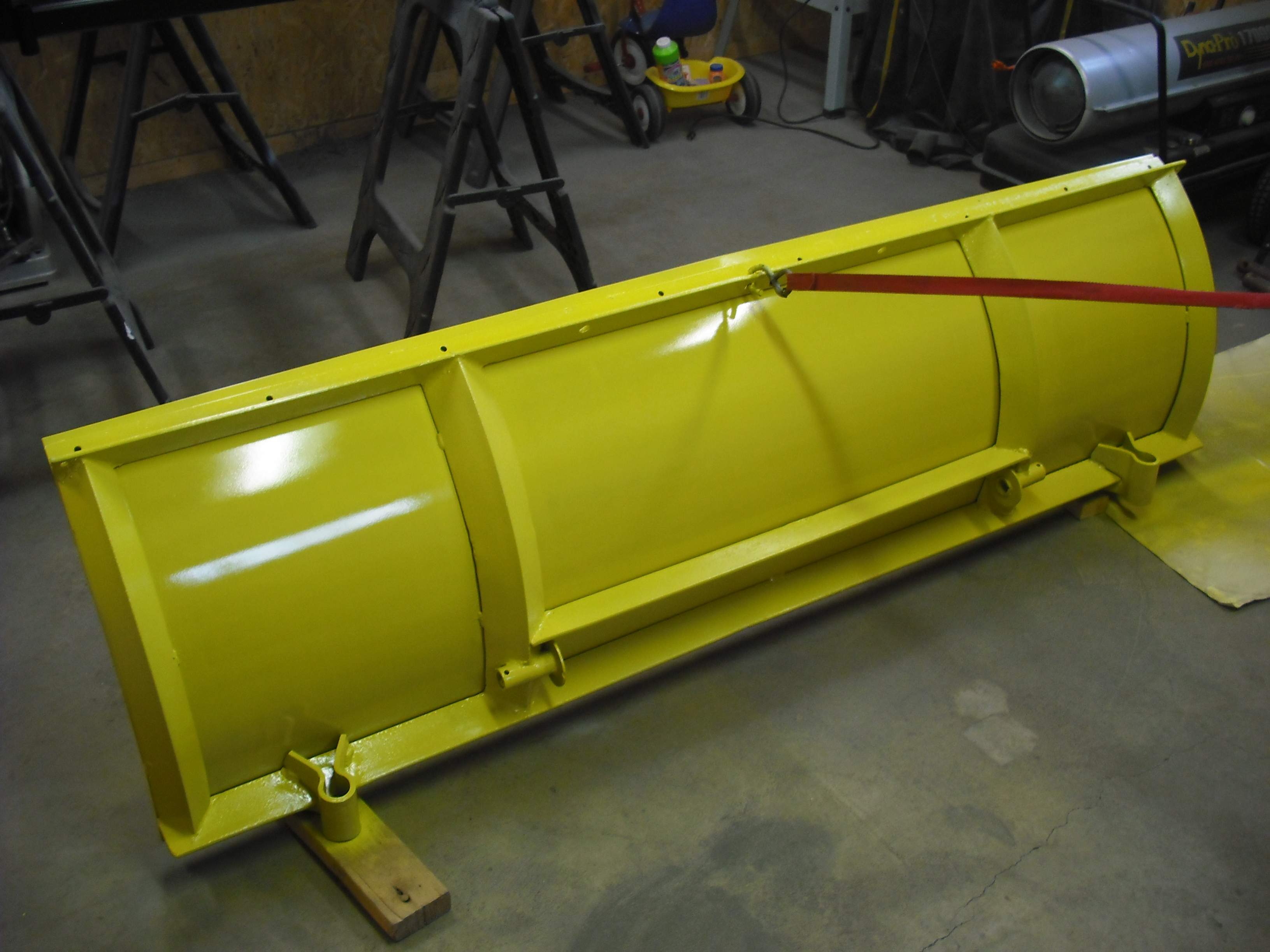

/ Meyer Plow for my tractor

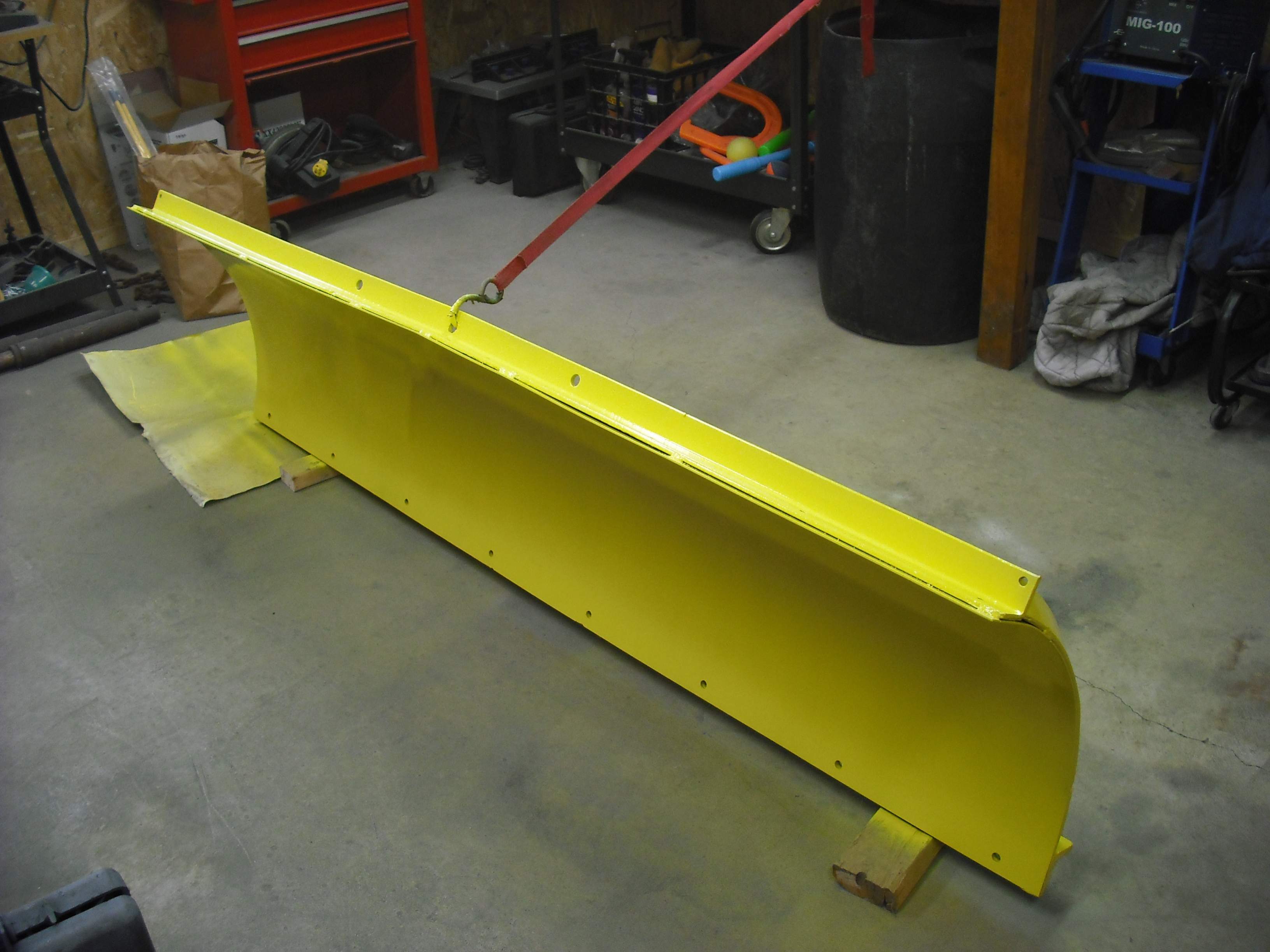

At this point everything has came back from the sandblasters and I had welded up a few cracks, welded on the new plow face, and welded up the plow to FEL mount. I then primed everything and put the plow in yellow and the rest in black.
I also ordered custom hydro lines to go from the remotes on my tractor to handle the left right movement of the plow and the new cylinders and a Meyer Decal Kit. I have about $220 in this which brings the grand total to just about $650 and about 20 hours. More than I envisioned at first but much cheaper than the $2000 to $2500 I was quoted for a plow new.
Later today I will assemble the cutting edge, A-frame, and odds and ends. I am still waiting on the cylinders, hydraulic hose, along with the plow shoes. I will update this as parts come in and post some pics once I get it on the tractor and working.
Chris

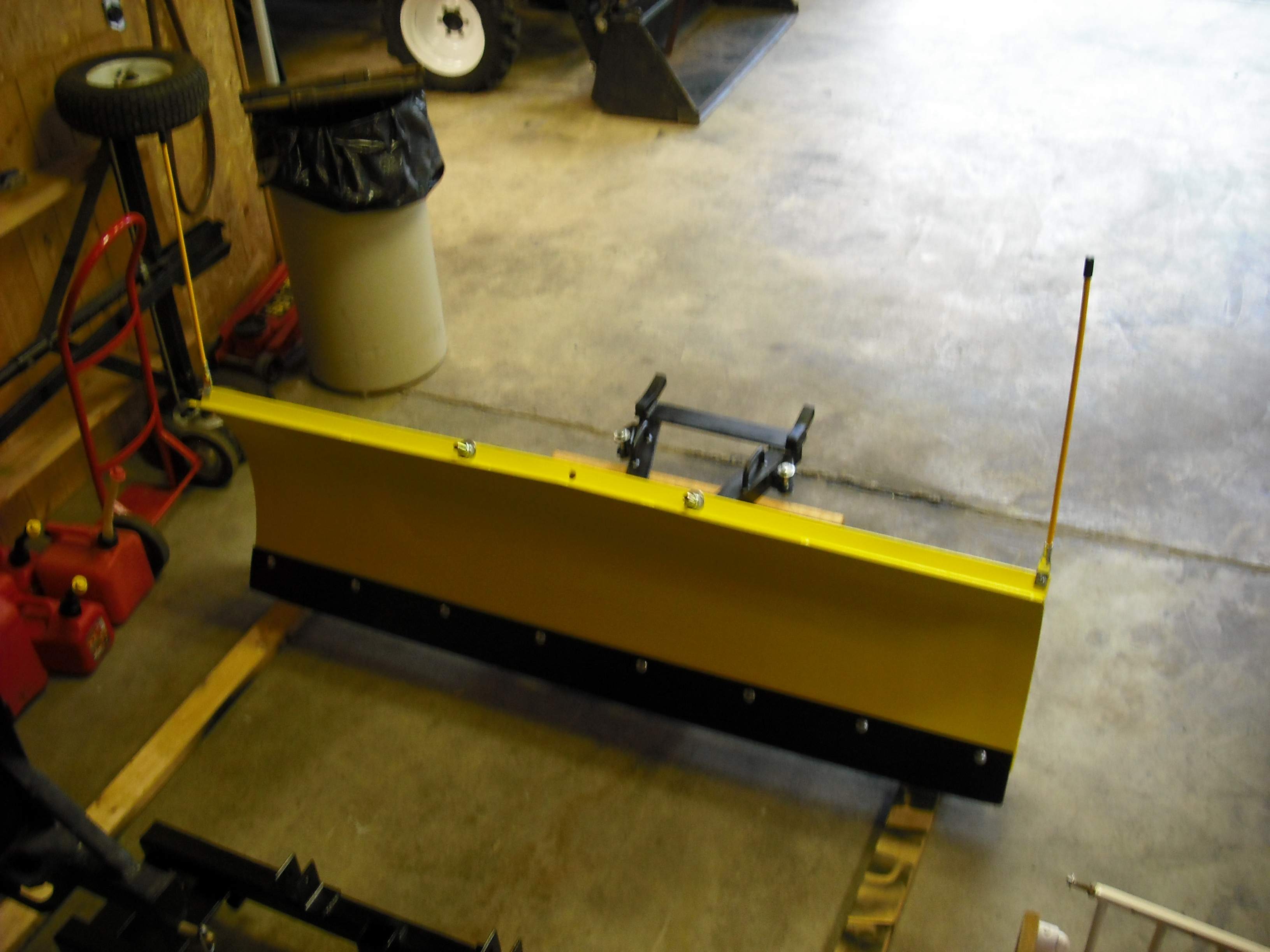

Well I just got done putting it together. I am still waiting on the hoses, cylinders, and shoes but its all done other than that. I will mount it up next week but I first have a job moving gravel and leveling off a area for a neighbor.

/ Meyer Plow for my tractor #13
Chris,
Are you going to mount that blade to the bucket or directly to the loader arms? My 6.5' Meyer project is nearly done and it will mount to the Koyker loader arms.
The Meyer original A-Frame is made of tubing and one angle iron. We cut off the chain, hose loops, and the two quick mount lugs, leaving only the bare A-Frame. The moldboard and trip frame are temporarily disconnected. We are boxing in the upper and lower part of the A-frame and making the box as close as possible to the moldboard in order to bring minimize the distance from the loader arms to moldboard.
Each end of the box has two welded vertical brackets that will pick up the four pin holes/pins previously occupied by the bucket. Can send you photos.
The angling valving, with help from Rob, is done along with another valve to the new rear remotes for the log splitter.
#14
Steve I am made a mount to take place of the bucket. I did not want to modify the plow because I may put it on a truck someday. The mount I made can be seen in the pictures. The mount will go on in place of the bucket then the plow will attach to it. I will post pictures in 2-3 days after I am done using the FEL for some gravel work.
Chris
#18

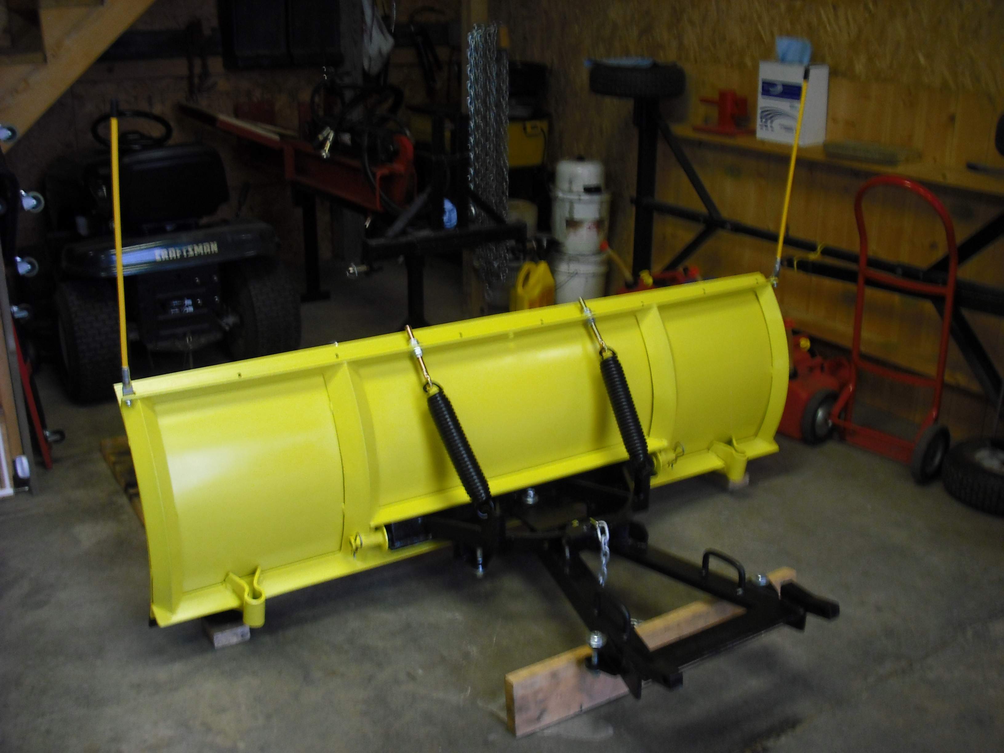

I got the hydraulic hoses and cylinders last night so I mounted up the plow for the first time. I also go the shoes on Tuesday. It worked great. I am just now waiting on the decal kit which may be here today.
Chris
