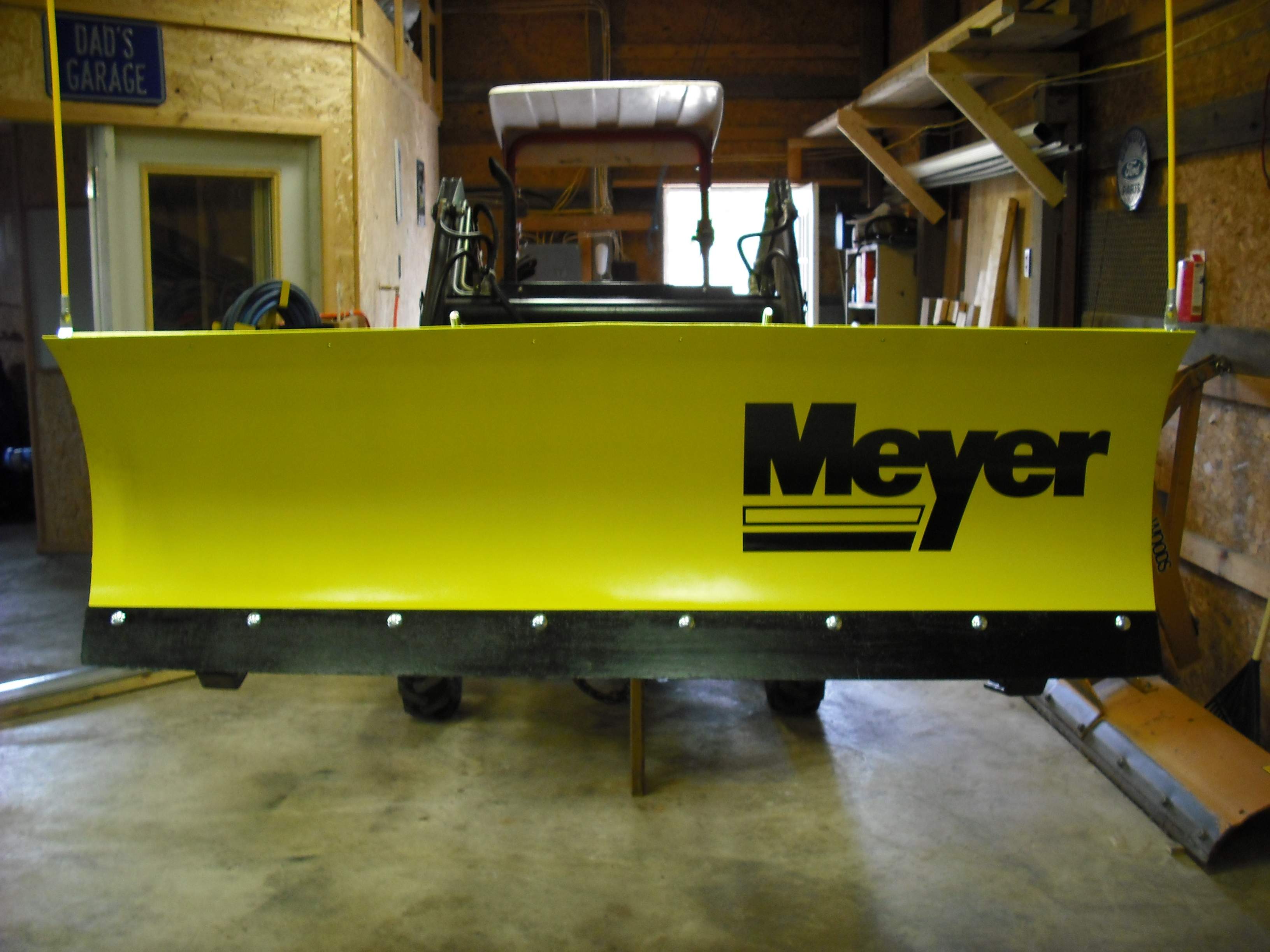

Beenthere,
Thats the best looking set up I've seen. Looks clean & simple.
Custom by you or a kit?
Seems like a lot of these plow companies (Meyer, Western, etc.) could make some profit selling plow frames for tractors as well as trucks.
Actually Meyers does make them now. I recieved a flyer from one of their distributors and they have plow setups for compact tractors.

He is right. I run my angle for the plow off the rear remotes which is 1/2" then its stepped down to 1/4" to the plow with 18' long hoses or so. No problems what so ever.
And yes, I am very happy with it still. We had a heavy winter the first year I had it and I gave it a work out.
The only failure I had, actually twice, was I broke the lift chain. Once I was driving through a customers property plowing a path to the wood pile. The snow was a 1' deep or so and I hit a log laying under the snow with the plow up in the air. It made the tractor bounce up a foot or so and the plow snapped up then back down violently snapping the chain. The other time I had the plow off the ground about 2' pushing snow banks back and it busted it. I have learned not to do either one of them things.
I now use my rear grader blade to push back the big frozen snow banks. The fluffy stuff is no problem. I had 50 hours of pushing snow on my land and my 10 or so customers and it worked great cutting my plow time in half easily via using the rear grader blade and FEL bucket.
Good luck with yours.
Chris

I caught your build and its going good. I think yours is a better plow to start with than I had. Got to use mine Saturday when we got 5" of snow.
Anyway I got the moldboard off with a cutting wheel and torch. It took some time like everything else on these old plows but do not remembering it to be too tough. I had steel rolled for mine. I got prices all over the place so shop around. I made a templet out of cardboard and got it rolled and the material for $65. One place wanted $300
Chris
/ Meyer Plow for my tractor #60
After cutting all the bolts and removing the plow face it was off to the sandblasters. I also made a shopping list and hit the internet, TSC, and my local hardware store.
I spent $100 on the sandblasting and another $30 on bolts and paint.
I also got new plow shoes ordered, plow markers, and trip pins for $80.
I then had to order the steel for the mount and new face. I had them make the face out of 11ga steel and they put the roll in it per my templet I supplied. For the FEL to plow adapter I use 1/4" stock and did the additions of putting on a 2" hitch receiver tube and tubes to accept another set of plow shoes if I feel they are needed later on. I have $140 in all the steel.
At this point I am into it about 10 hours of labor and $430
Chris
