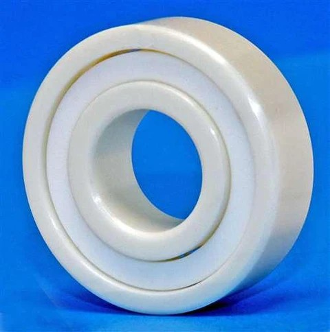

Well, im glad my hunch that those curves weren’t cut ‘freehand’ was correct so i dont have to nurse a sense of inferiority.. Sounds like your process is pretty good considering what you’re working with. I wonder if you can put a tiny bearing on a plasma cutter tip the way you can put a bearing on a router to follow an edge? Might make it smoother, but conductivity of the bearing is probably an issue.. lol.

You probably could use a bearing - but if you go slightly too fast once, it throws slag out the top instead of the bottom, buggering up the tip and surface. This would be a problem with a guide, where freeish hand, you just plow through it. (photo example attached)
As far catching the fab station on fire, it gets what it gets! Thats the beauty of owning/building all your stuff vs borrowing, renting, or paying through the nose for new.. You dont HAVE to care any more than you want to. 🙂
Maybe a shielded ceramic bearing?
