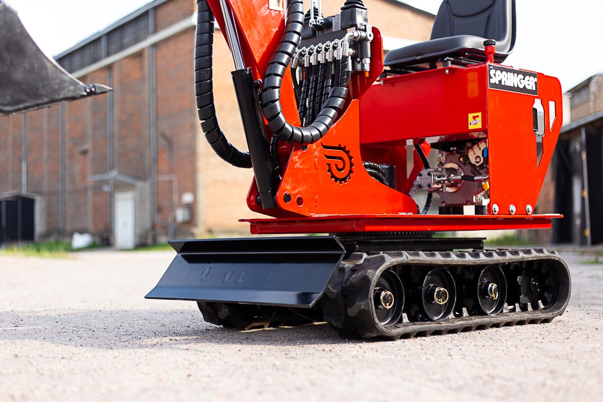

Pic here, looks a bit thicker than 1/4"
I like that the hydraulic tank is the seat, but I don't see a filter....

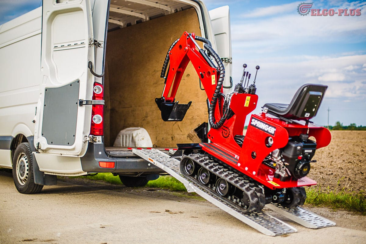

Im going to try and build myself a mini digger, similar to the one pictured.
Its a small machine with just under a 2x4 base, powered by a Honda GX160.
Without the tracks - given the cost of the tracks, motors, roller wheels, sprockets, rotary union, and a turret bearing large enough for the union, it'll have 2 roller wheels and 2 legs.
Anywho, I was going to use 1/4" steel plate, but the pictures look like it might be a 5/16 or 3/8 (or, given the country of origin, 8 or 10mm)
Think 1/4" would work?
I have a Weld-Pack 180, which technically can weld up to 1/2", however as I'm not a pro-welder, I'm more comfortable with 1/4"; but I don't know if it'll be strong enough.
Also, cylinder bore size, should I do 2", or smaller?

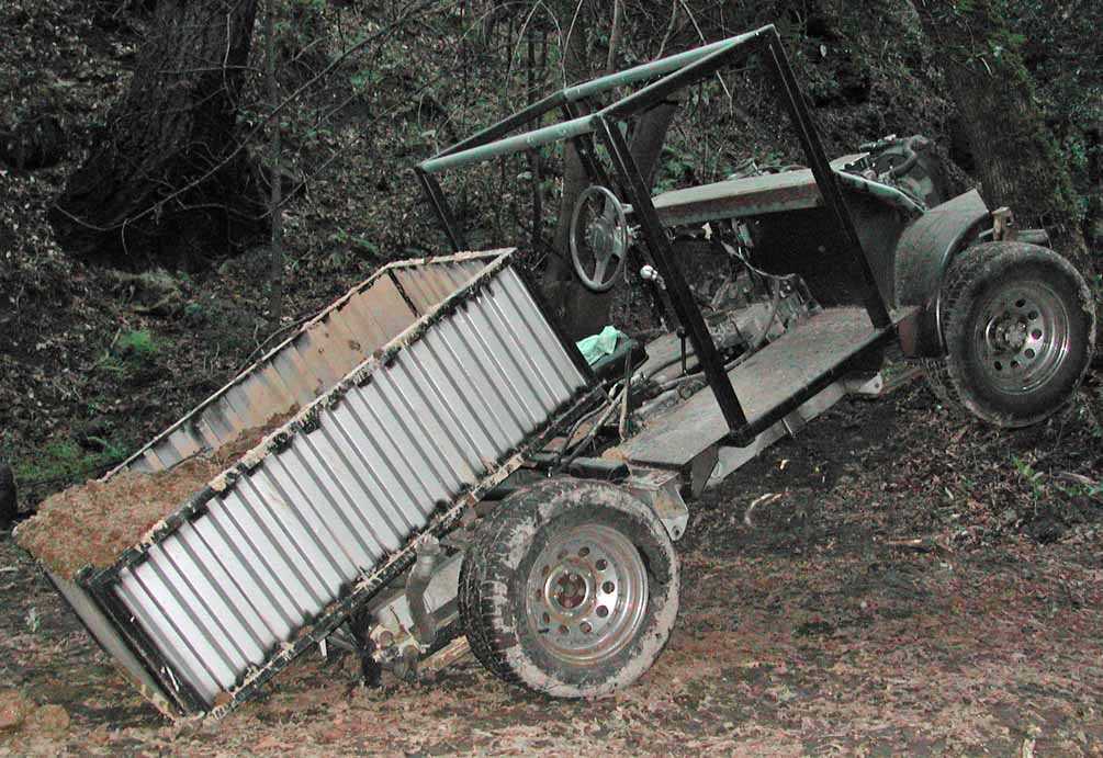

I posted this thread about 9y ago. Still works well, but need to upgrade to electric fuel pump. Kinda like to replace it with a 4x4 Workman or ProGator.....
To reuse "junk", I made the deck of the box from a Ford Ranger box, the hyd cyl was the first dump cyl on my concrete mixer, the PS pump stolen off an Infiniti Q45. The Weber carb I had to buy (used for $100). I used a new Grammer tractor suspension seat.
I just read thru that old post on your Frankenzuk and giggled the whole time. I love seeing statics and dynamics discussed on tractor forums...by us dumb, redneck, farming and ranching country hicks.

I have moved many tons of dirt with that machine. Mud, however, was an adventure.
Always thinking of ways to DIY it differently. (Scrap the OEM engine and replace with Goldwing engine, then put seat over engine?)
You will be sadly disappointed. If the ground is hard you will plant the bucket and just lift the machine. I have a IHI 15 NX that weighs 4000 lbs and would not get anything lighter. A friend has a micro CAT hoe and tommow I use my machine to dig him a swimming pool. Micros are really small and really cute but worthless. The way the economy is headed just wait a few months and then go shopping with cash. Read banks are buying there own car lots because they are getting so many back. Cash will be king in 6 months

Nephew bought this littl one does a lot of job and came with serveral attachments was only $11k NZ dollars new
