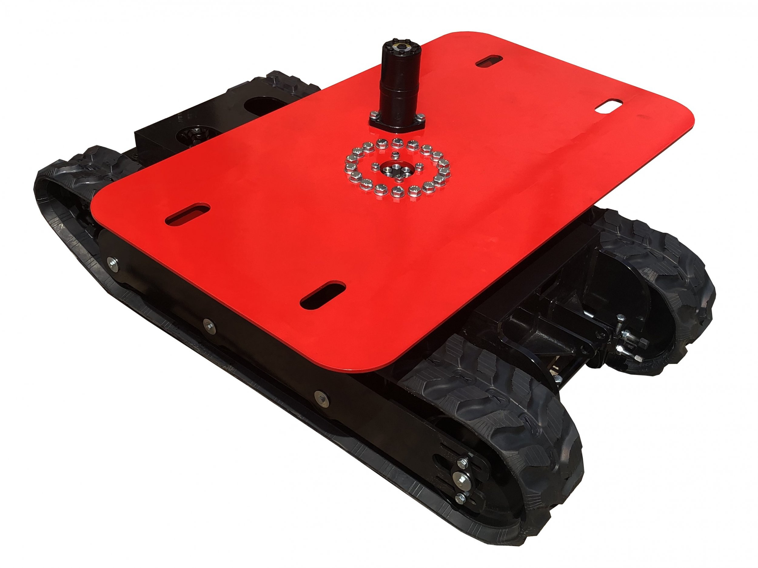

If I'm going to build a tracked machine, I would want the beauty of 360 degrees of rotation. After the cost of the rotary union, turret bearing, motors, track and rollers, I would be better off going to the Kubota dealer.
As far as the material thickness, throw yourself into the rabbit hole/bottomless abyss of excavator arm design a little and i think you will be surprised how thin some of the sections are. But, there is almost always something going on internally that is not obvious from the outside on a commercial excavator arm. Only the homebuilt or the towable type stuff actually uses 'just square tube' for arm sections. But to answer your question, 1/4" wall thickness on the arms of a small digger is more than adequate. I have two small backhoes here and neither of them has 1/4" wall thickness ANYWHERE on either arm of either hoe, except where i am adding some (and not because the thinner stuff failed) or where the material is doubled because of the pin brackets welded to the arm walls.
Thats what I was curious about. I didnt think the arms were that strong, or needed to be, but the pin mounts I think I'll need to add material too.
As far as size, my experience with small backhoes is that UNLESS the thing easily and conveniently propels itself, then you should really build the arms (thus the whole machine) to a length that doesn't make you constantly have to reposition the machine.
And thats the problem, they all suck for this reason.
But they are cheap becasue of it. As Ive now learned, the driveline is the complicated/expensive part.
A short arm is fine on a real excavator where you can scoot yourself around effortlessly, but it's irritating on a backhoe where you have to change positions to move the machine. Narrow is one issue but if you aren't trying to fit it through a particular gate or doorway then that is a small issue. Length, on the other hand, has a huge impact because it changes the leverage your machine weight has on the fulcrum point created by the front blade.
Oh its worst than that, as I want the 360 degree rotation, It'll need to be long and wide.
Making a machine of the same weight longer will make it 'stronger' in that sense. Real excavators often need to be built as heavy as possible in their footprint to achieve 'zero swing' or something close to it where the entire back half of the machine basically stays in the same radius as the corners of the tracks no matter how you spin it. They usually have counterweights a lot like a forklift where most of the stuff on the very back of the machine is built out of solid metal to fit as much weight into the footprint as possible while reducing rear 'swing'. If you aren't concerned about that type of maneuverability, just adding length on the backside will reduce how heavy you actually need to build it.
Looking at the design of my example, the engine and operator are the counter weight.
I think fully boomed out, with material in the bucket, you are at its tilting limit. Should you step off, over it goes.
I really do think the operator is the intended counter weight here.
When trenching, I don't think the minimal self propelled limit would be an issue, moving the machine across the yard would be the worst part.
I planned on adding a detachable trailer/handle bar, so I could insert it, and tow it with my mini dozer, then remove it when on the dig site.
Or, by hand by just tucking the boom in and lifting.

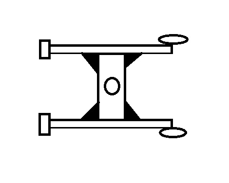

Here is my idea for the base (top view)
And it'll be easy enough to swap out should I ever want to add a drivetrain.

I would have to agree with other posters about the tremendous amount of engineering and iterative improvements involved in something of this complexity. Additionally, it sounds like you don't have much in the way of welding or fabrication experience, hydraulic design and sizing, etc. If all that is true, this sort of huge project may not be the best idea unless you enjoy it and are doing it as a hobby.
Have you thought about buying a basket case/ready to scrap commercial machine and repairing it? That way you don't have the initial cash outlay but you benefit from all the engineering and you can expect reasonable residual value after repair. The skill set and tools required for repair of an existing complete pre-engineered machine is much lower than that required for complete design and fabrication of a new one from zero.
If you are set on designing and fabricating it: in answer to your initial question -the base that the boom attaches to will need to be stronger than just single thickness 1/4 plate as it will take a lot of stresses. Note in the commercial version it is made of several plates welded together. Another thought is you should buy your plate steel from a place with a waterjet or plasma table and have the plate precut for all your pieces -this will be well worth the relatively small additional charge with the handling and attempting to cut to size yourself

You might want to make it heavier since the weight is all that's going to stop it from moving while digging, especially in harder ground. Might be better off finding one of them pull behind backhoes Northern use to sell for around $5000 years ago.
