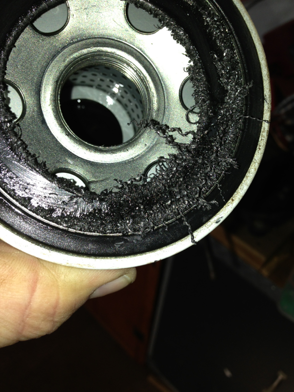

Ok I read a lot and get good info tonite I need advice and help not to panic. I just changed filters at 230 hours little late but had it in my head for 250. Did engine oil and filter and fuel and air no problems. I used shop vac to keep hst fluid in ( hope I remembered right no big mess so I'm happy). When I took off the larger suction filter I found a pile of shavings on the magnet some curly some straight I'm not a mechanic but changed a few filters over the years never saw this much stuff the other filter had nothing. Less than a 1/8of ring had stuff on it. Have not drained oil but think it will just go to shop if there is reason to be fearful. Don't need to be scared into going to shop but don't want to panic if this is ok. The shop did the last full service at 50.

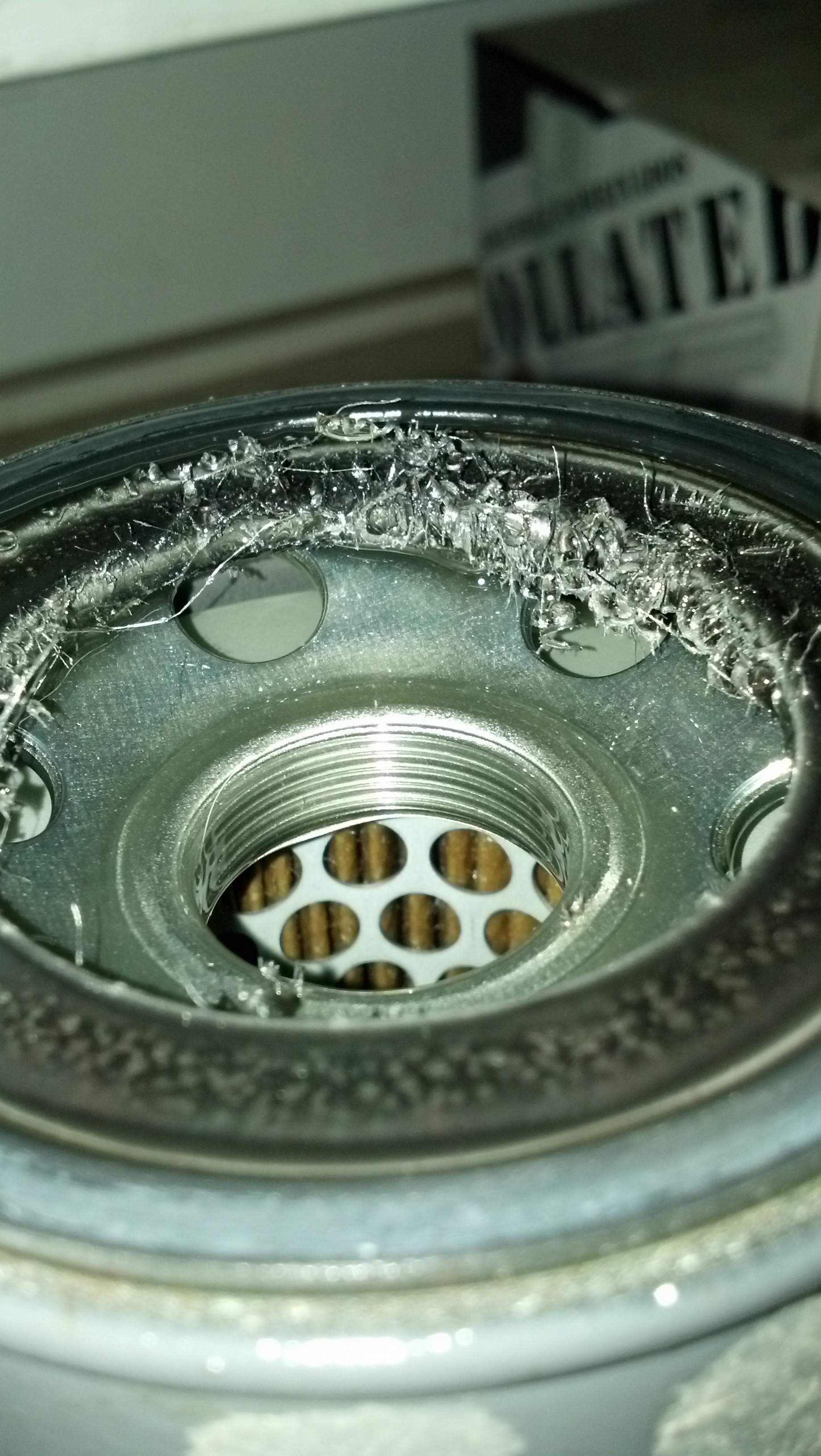

Here is what mine looked like @ 50hrs from what Ive heard its to be expected.

Thanks here is a pic of filter. Talked to shop said to run a few hrs take filter off if a lot of stuff again drain fluid and see what comes out so working with it today. Ok tried the pics got two of same

Wow dgoat, i can see why you are concerned..
I did my 50 hr last year and had maybe a couple specks of metal. If i saw that id probly need an underwear change:)! I hope it is ok for your sake tho

Good pics. Those shavings look like the castings were not washed out good at the factory after machining. They way they are curled and spiral shaped looks just like the way they spiral off a milling machine. I have never seen spirals like that come out of transmissions or rearends that have had catastrophic failures. Those have got to be leftovers from a sloppy washout at the factory.

This isn't unusual for the Kubota L series. Mine wasn't that bad but still had a fair bit of debris.

Well, as disturbing as it is to see that much metal debris loose in a transmission and hydraulic system, they don't seem to have many problems as a result of it.
The filter is on the suction side of the pump and removes the stuff before it gets somewhere critical. If it stayed in suspension and got into bearings or gearing it might be a problem. Cold weather and heavy oil might cause that kind of condition.
