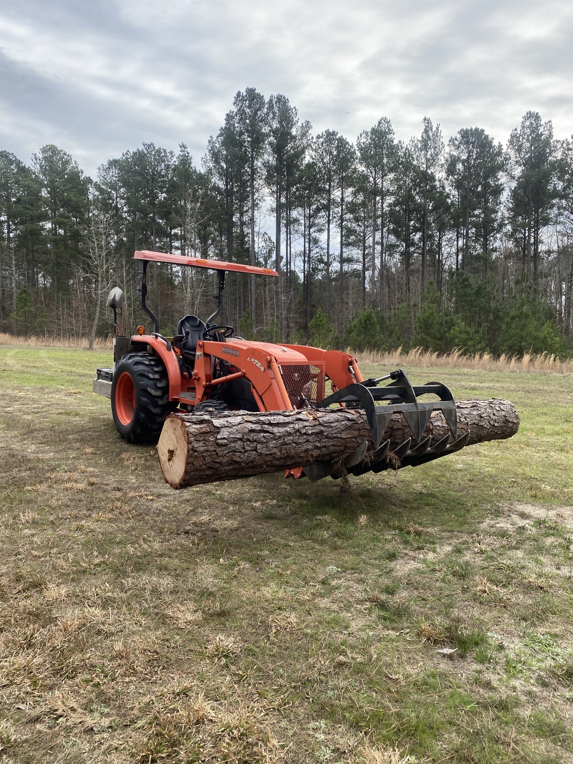

I have an L3540 Hydrostatic 4 wheel drive tractor, have had it maybe 8-9 years. This problem seems new or has been slowly getting worse and I'm just starting to notice it.. When I have a mower on and either going on flat land or downhill it seems to be fine, BUT on even a slight upgrade I seem to lose power and RPMs pretty bad! I thought it was due to running the finish mower as it seems to take more power than a brush hog, but using the brush hog yesterday it seems the same. I do not use this for business just maintaining my own property so not a ton of hours, bought it with 320 and now has fourteen hundred something. Did the hydraulic oil and filters last year and it just had a recent oil and filter change. Thought maybe it was leaking trans fluid, but I checked, and it was full and crystal clear. Any Ideas before Ie to drag it to the dealer???

Nice photo...
Well, there's really no good reason why a tractor that young would have any change in power. My guess from what you say is the HST is fine. But before taking it to the dealer, I'd want to also make sure that the engine is up to power. Mostly that is going to be fuel and air filters, maybe check the valve clearances, and that the exhaust is not full of carbon. One of ours was down on power from a fuel filter that needed changing.
I mention the exhaust because yours is like mine in being right at the age that saw a changeover from the old interim Tier IV EGR emissions control to the newer full Tier IV emissions with regeneration.
I prefer the older type EGR emissions, but some Kubotas from that era have a pre-muffler that needs to be cleaned or replaced from time to time.
In choosing a dealer for something that is this vague, I'd want a real dealer with an experienced mechanical shop. I had a shop. The shop mechanic is going to need a dynamometer for sure, and either a hydraulic test stand or at least some hydraulic gauges.
Otherwise the mechanic is just guessing, and we can do that here for free.

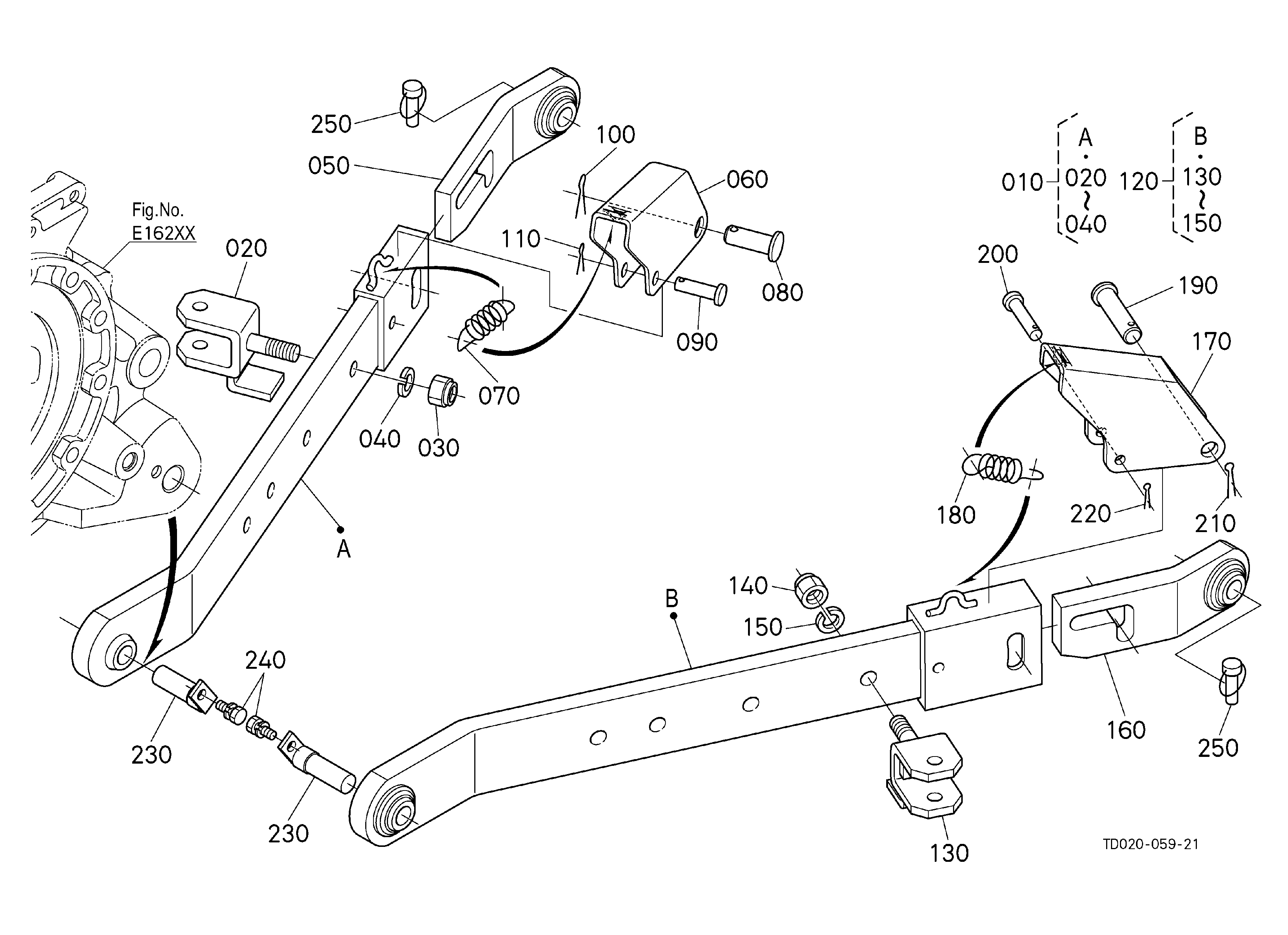

So I have 2 small fuel lines that run from the top of the tank to the filter assembly and was going to try to blow them out. When I pulled one I got a strong stream of fuel coming from the filter where I detached it, plugged the hose back in and went to the connection at the top of the tank. I unhooked both those lines and blew into them but all I could hear from the tank was air blowing in and no bubbles so I'm thinking they were both some sort of breathers/return lines. I've looked through my shop manual and the internet and cannot find a schematic of the fuel system!! I'm guessing there is another line somewhere feeding the filter but can't find it with all the stuff in the engine compartment.. more searching/researching today....
Tracked this down at messics
Ok, I can't get the right screen to load here, If you click the "Category box and go to Fuel system then click the diagram box and go to fuel pipe and fuel filter it shows the correct hose attachment on the bottom right of tank. I'll be checking this out today!
