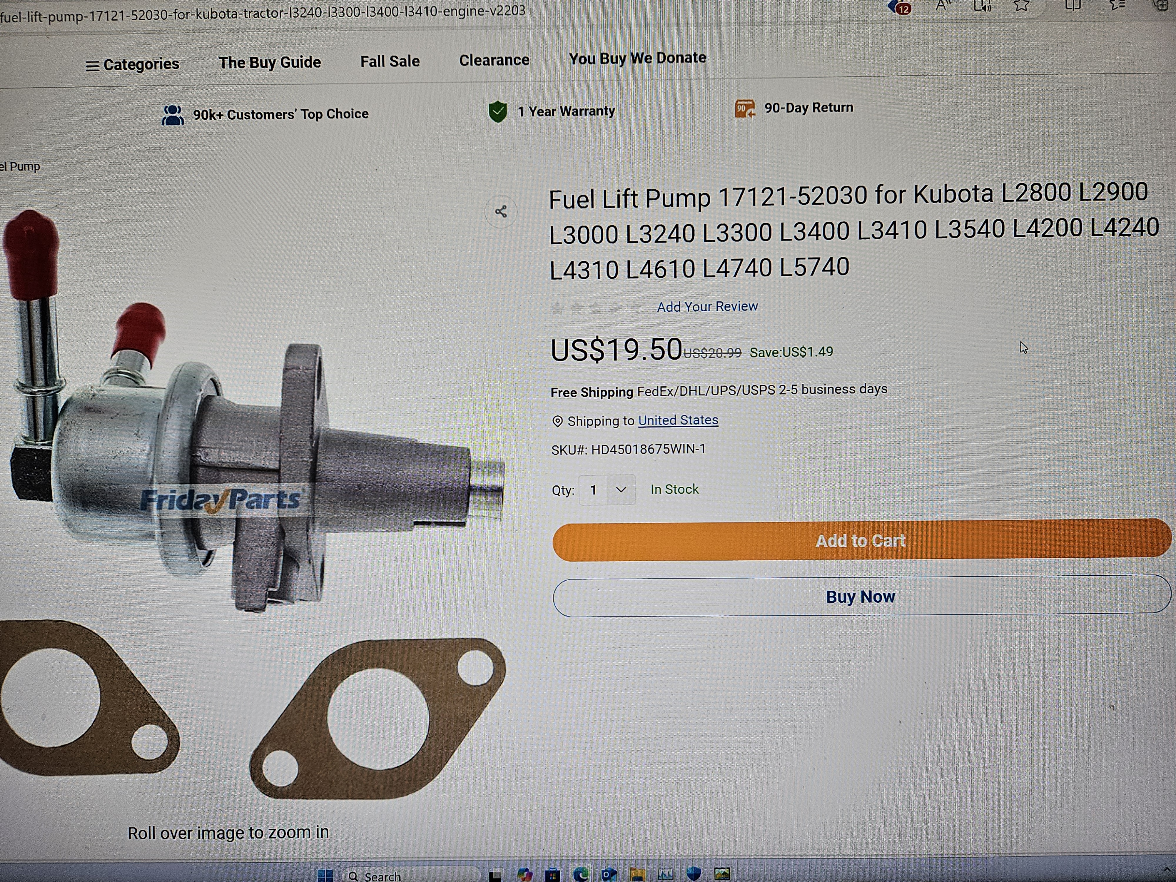

I have a 2012 L3540HSTC-3. It has a lift pump, which failed and wouldn't start, I had changed a few years ago.

So what do you think that the injection costs $35 is lower down middle on the right side of the engine. It wouldn't start,
no fuel, changed the small pump and guess what started right up.

This is what my mechanic changed when my L3540HSTC-3 wouldn't start a few years ago. My friend found one on the
internet for $35 or so, but I was in a hurry and had already ordered one from Messick's, maybe a $100 or so.
Thats mounted directly to the engine?

I stand corrected, sorry for spreading mis-information about the 40 series on the forum. we do indeed have a lift pump. I was not expecting to see a mechanical pump on the injection pump. that pump is now 210$ CAD. so about 145 USD
