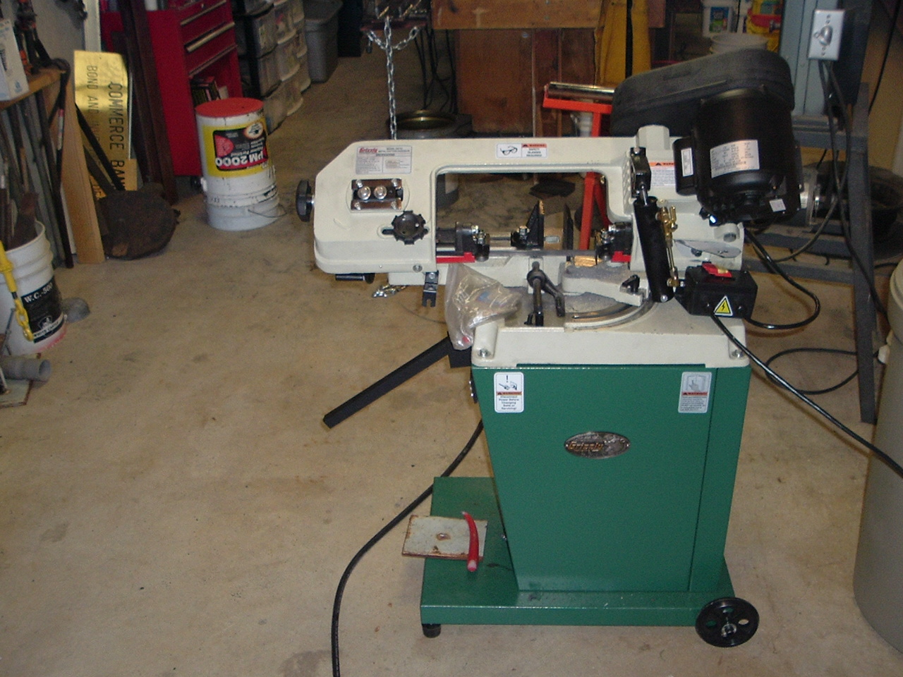

These are the 3 band saws I use most.

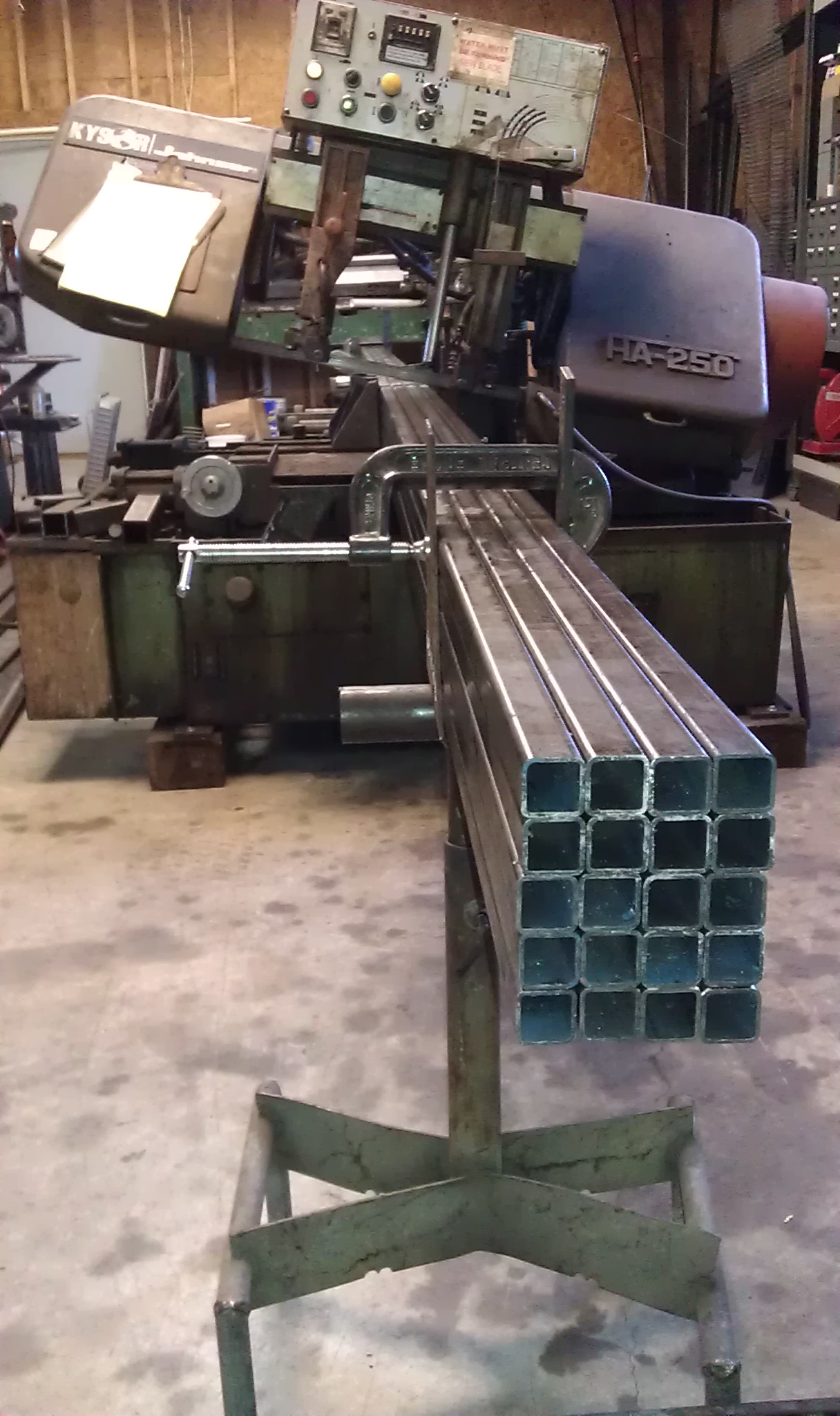

The old Kysor is automatic or can be used manual. It can cut more than you can prep for welding if you have it setup right but it does let you multitask.
The next is an old Roll In, it is fed by gravity. Very simple, will let you miter and can even be used as a vertical bandsaw. There is not much that can't be done with one of these. I setup a stop switch for this one so I could be doing something else while it worked too.

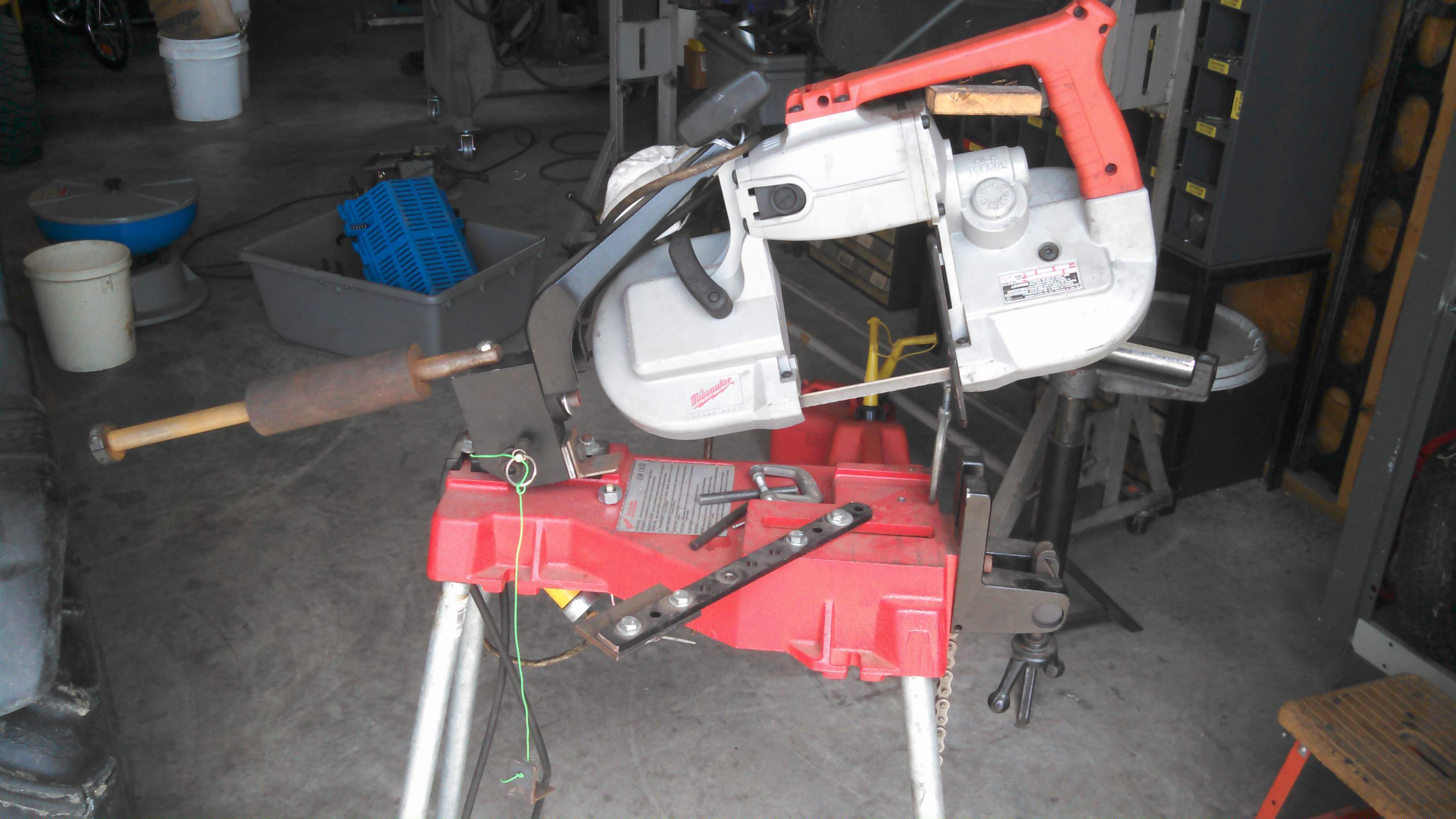

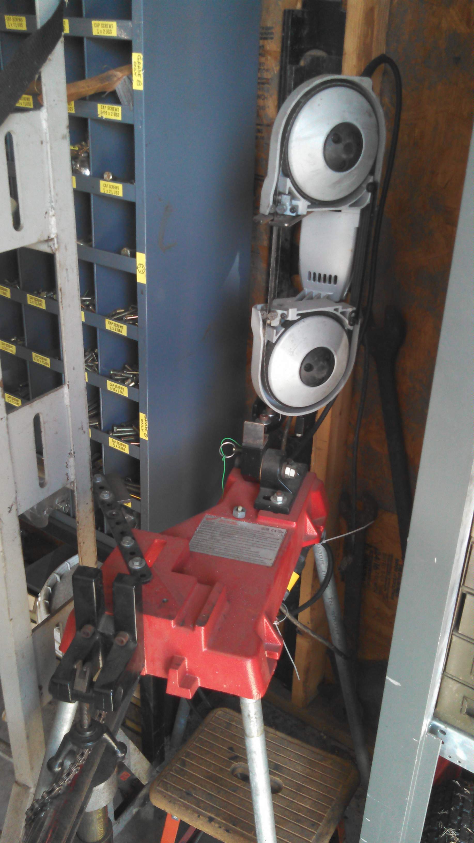

The last is a portaband with a table for it I picked up new in the box off of craigs list for $70 (just the table).
It is almost as mobile as a chop saw but non abrasive. I made a counter balance off the rear to set cut rate and added a switch so it would shut off as well when the cut is finished. Also drilled and tapped the base for miter cuts. You can also make a stand that will turn them into mini vertical bandsaws.
How do you like the Milwalkee portaband on the stand? Is the stand worth it? Last time I checked the stand was $$$, but it is something I'm considering.

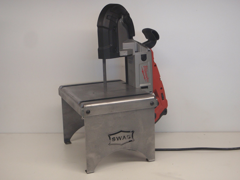

I also picked up one one the Milwaukee portaband tables off CL used for about $100. It imakes the portaband a whole different tool. I especially like the miter set up jwmorris set up on his. That really increases the utility of the table stand for fabrication.
There is also a very nicely made mini saw table from Swagoffroad that allows the portaband to be set up like a vertical bandsaw. Makes freehand cuts possible and also accepts a sliding miter gauge. Only useful for smallish pieces but nice. They sell several models including one that simple clamps into a vise. I have the one in the photo which cost a bit over $100.

The portaband is a very usefull tool, even more so if you can weld blades. The stand makes it that much more useful. Worth the $70 I paid for it but I was going to build my own before I found the deal on CL. New they cost more than the saw. The feet are just sections of pipe, so you cut them to the height you want and can break it down for transport quickly.
My nose can't stand much dust, I only use my abrasive saws for hardened materials now. A chop saw is cheap to get into but that is about the only thing good about them.

I'll have to get a pic of the counter balance. If you look at the photo above you will notice a large nut holding the switch in from the bottom near the pivot and a section of angle iron that depresses it when finished (or all the way down). The switch is the one that throws out the cruse control if you push in the clutch, out of an '86 f150.

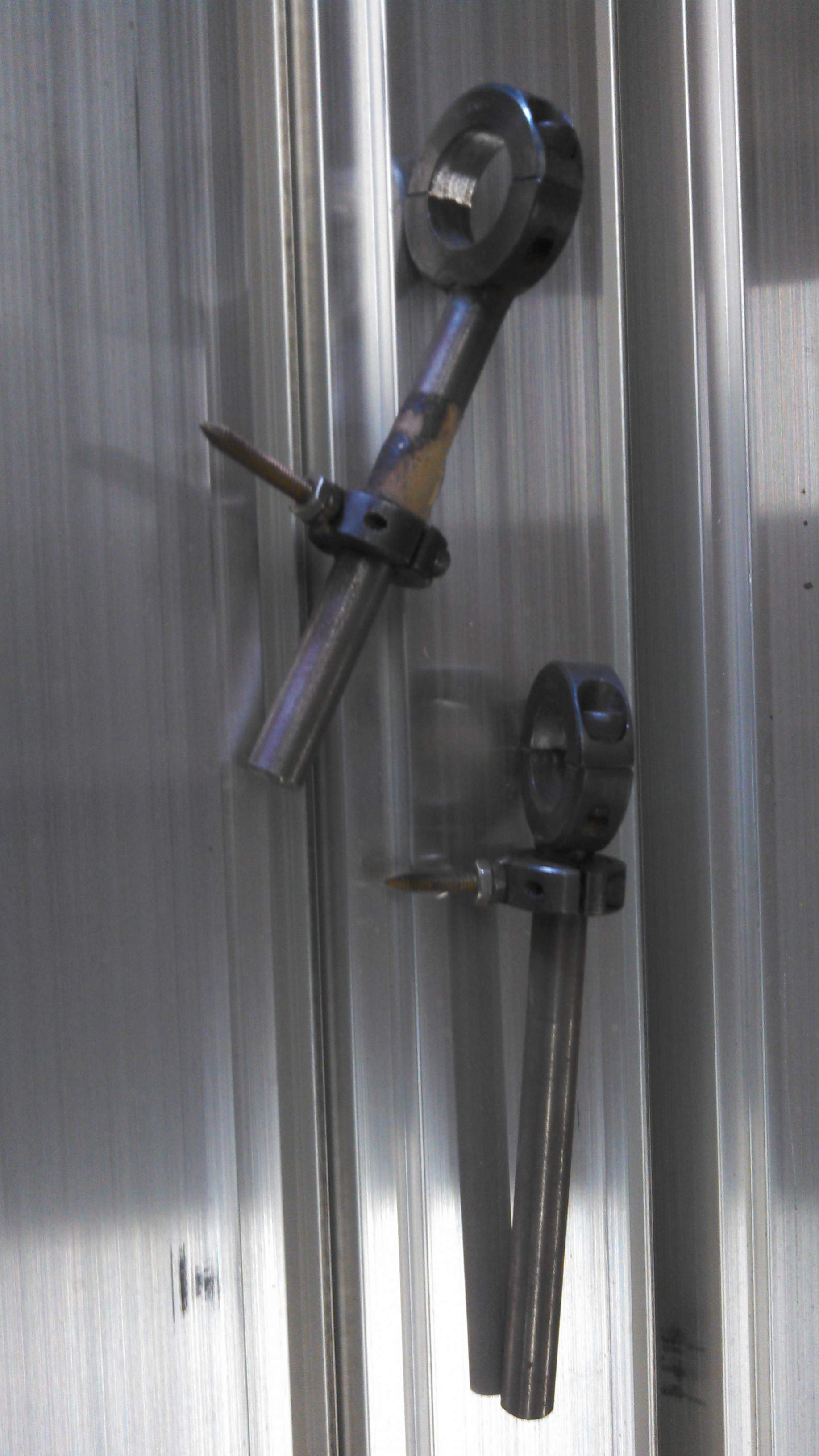

Here is another view of the switch and the counter weight. Its a section of 3/4" bar stock bolted to the bracket that holds the saw and a section of 2" barstock with a 13/16 hole in it so it can slide up and down. The set collar sets it on the shaft.

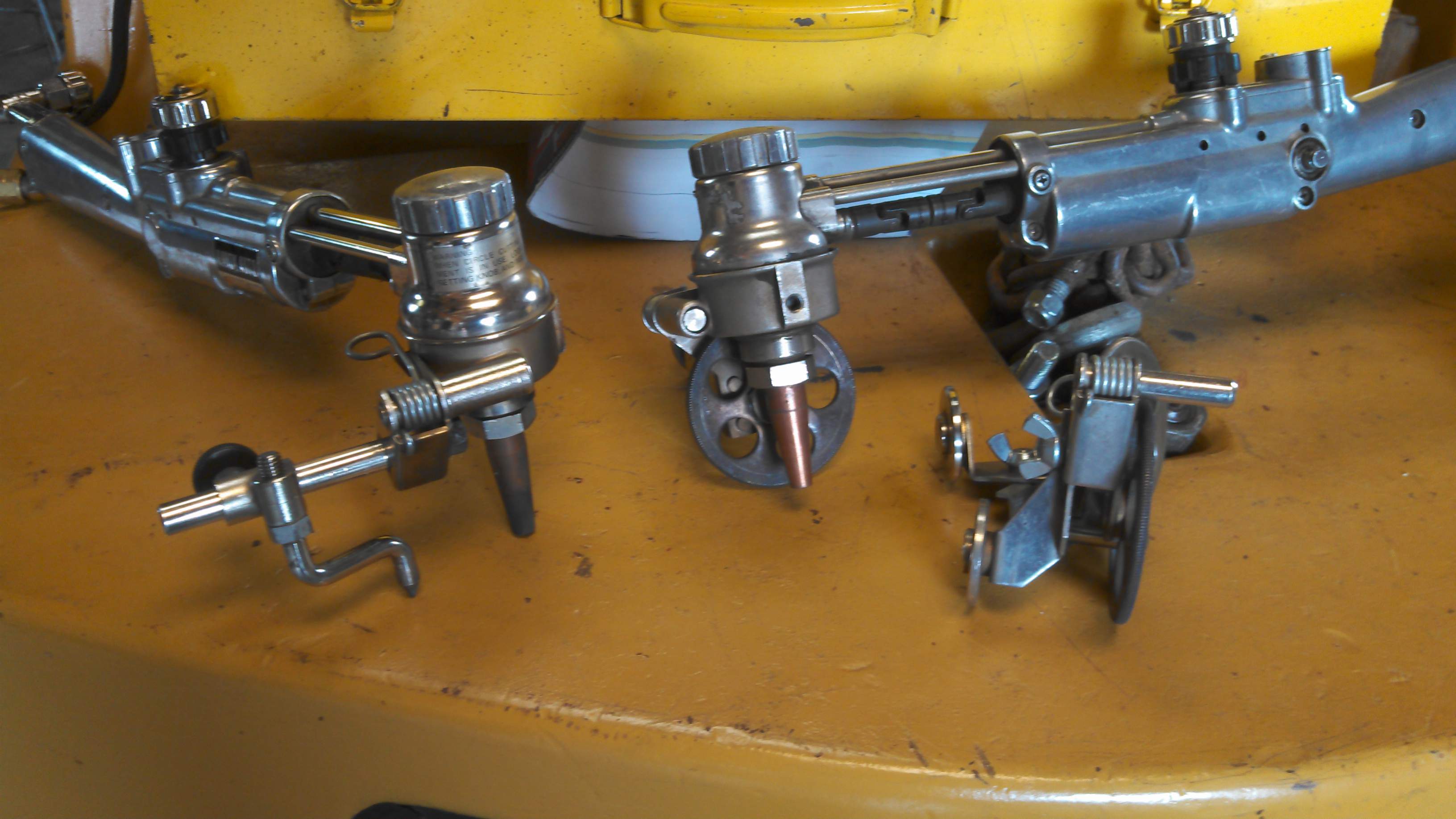

The other photo is of handy auto torches the one on the left has the circle attachment on it the right one is bevem and the one not mounted is perpendicular cut. The top knob starts the cut and motor, push button on the side is forward or reverse and the knob at the rear is speed control.

These are simple drag tips. The stamped steel one on the plasma is a factory one the one on the torch I built out of a double split set collar.
The head on the left is a rotating holder for the torch tip for use with the tool in the rear. A magnet holds on the center of the circle or arc and you can extend the radius however long you want.
The other two are small circle jigs for the plasma. Straight cut and bevel cut.
