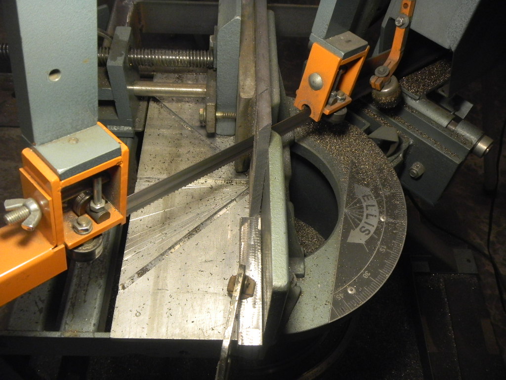

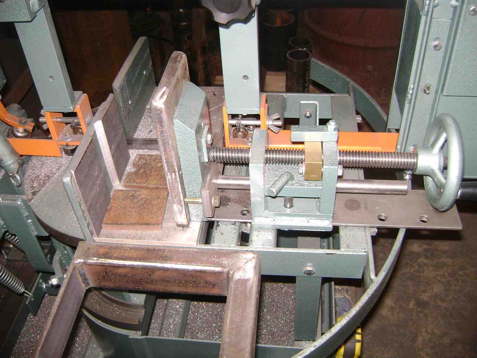

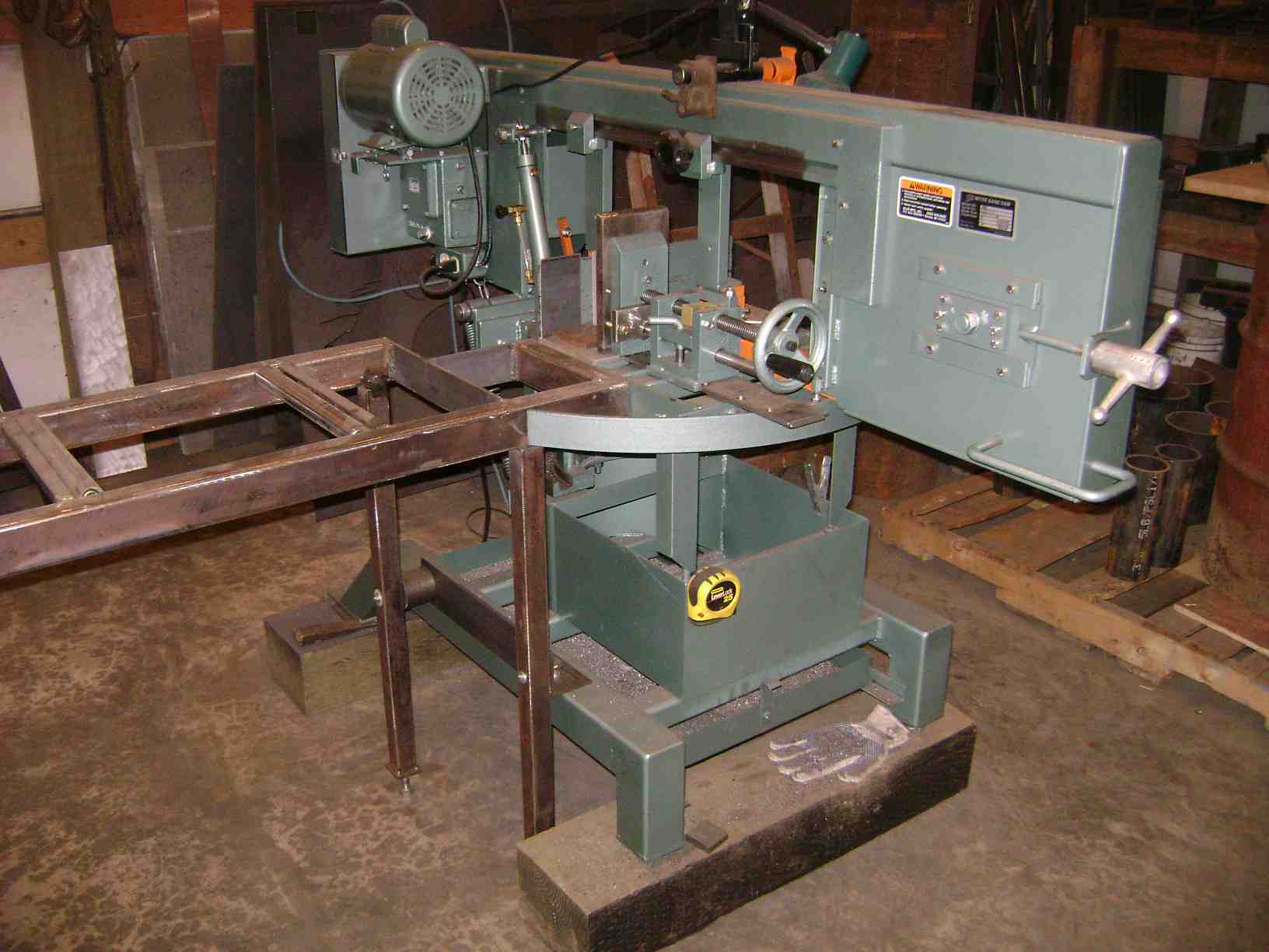

Be real careful buying dry cut saws. I have an Ellis which is dry cut. I was really concerned about that before buying. I asked a lot of questions on welding, and tool forums. I've had mine for almost 6-years. I can go 10-months on one blade. But in an industrial setting who knows how long the blades would last. Every steel supplier I've been to have very large HE&M saws which are wet cut.
I like the way you jacked that saw up to a level that was comfortable for you instead of having to bend over excessively when using it.
When I had a shop, I avoided coolant like the plague since, back then, the coolant would get rancid, especially if you didn't run the machine every day. Coolant additives may have advanced since then but on our bandsaw, we picked a middle of the road solution between totally dry and flooded. Someone made a "grease-stick" that was about the size of a grease cartridge, but solid, like a crayon. Every-so-often we would plunge that crayon into the running bandsaw blade and it seemed to help blade life. I think we bought them thru MSC.
/ Metal cutting?????? #30
One of these days I'm going to make a stand for it. I used the timbers just to see if I liked that height. Well it seems as I must like the height. :D
